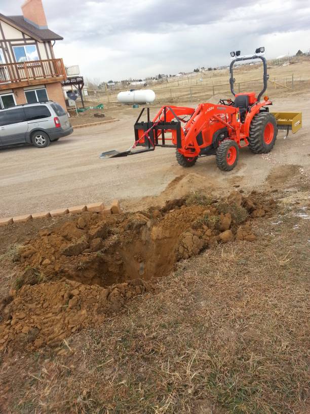

I have a bucket spade (Paulmco from Northern Tool) that fits on my pallet forks. Just used it yesterday to plant another live Chrismas tree. Took me 10 minutes to dig the hole in hard clay. They don't work well, but good enough & cheap enough. More importantly it beats a shovel.
Surprisingly I didn't notice my new L4060 digging the hole any faster than my old L3200 did a couple years ago.
/ ssqa backhoe for tractor #14
Exactly the spade I have, and exactly my experience. Better than a shovel, for sure. Nowhere near a backhoe. But also costs a few hundred instead of a 100 thousand for a mini-ex, so, there's that.

Interesting thought. And actuallkly I had nothing on my 3pt this weekend on the L4060 (double the weight of my L3200). Generally my weak spot is curling a spoonful of dirt out rather than pushing it into the ground. But pushing it into our hard clay isn't easy. Getting dirt out of the spade in a controlled manner is iffy too. It usually bounces the dirt out back into the hole. But at least it's loose & easy to clean out by hand at that point.
At $150 it's still well worth it vs $4-8k for a real hoe for the tractor for my level of use.
