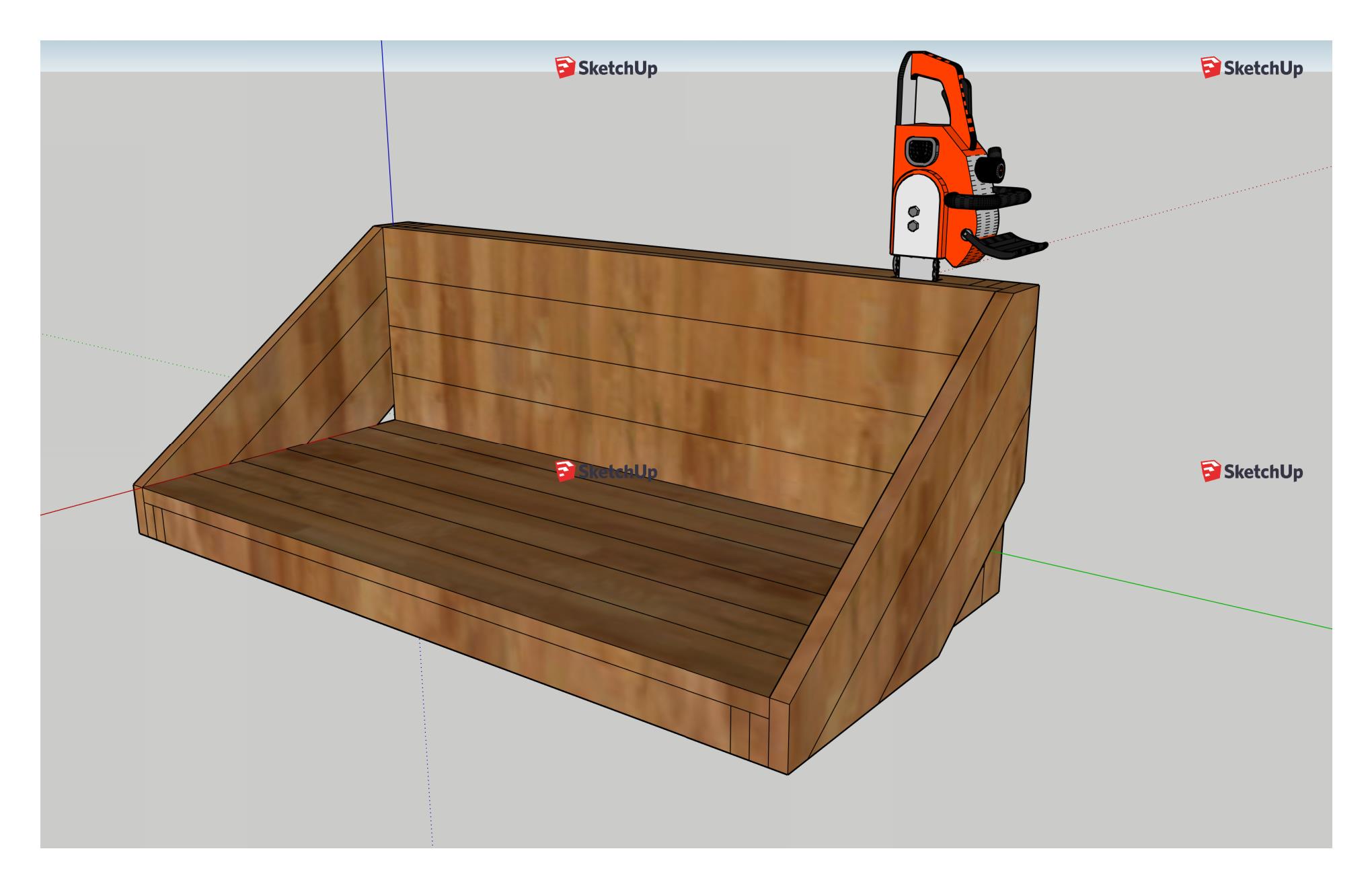

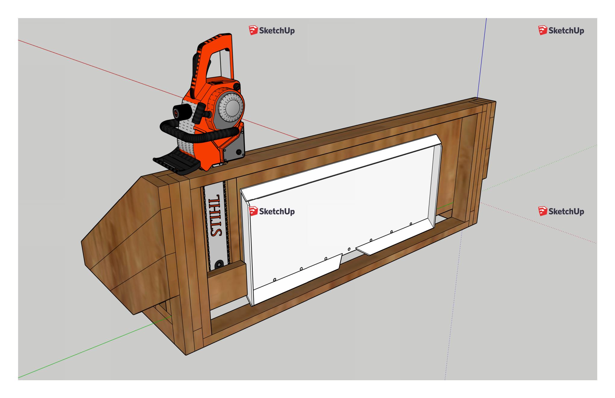

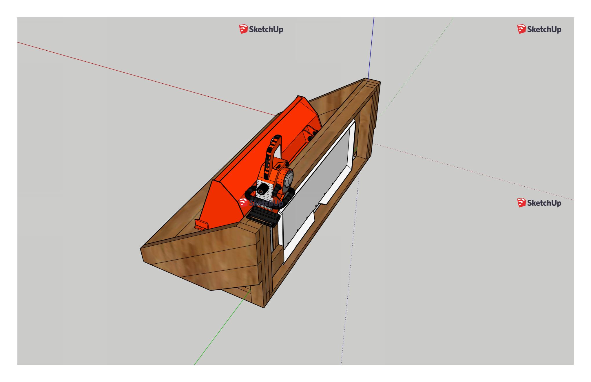

Good Morning Guys,
I wanted to run an idea I had by you guys and get your thoughts. I have a Kubota BX23s and I use the back-hoe often. I also like to bring chains, chainsaw, fuel, chain-oil, hand-tools, cement mixer, backpack blower, materials, etc... out into the field and the multiple trips with the little 48" loader bucket get old quick and I worry about damaging my chainsaw and backpack blower. Since I use the BH often and it is not efficient to remove and install the 3-point I am thinking a 3-point carry all would not be used often enough. A SSQA Carry-all on the other hand would serve the same purpose while allowing me to quickly drop the carry-all off of the SSQA and quickly reinstall the loader bucket and get to work quicker.
I already have a SSQA blank plate from Titan on the way. I plan on the inner dimensions being around 6' wide x 30" deep with a slot to protect the chainsaw and maybe some hooks to secure the backpack blower from banging around in transport on uneven terrain.
Here is my design, let me know what you guys think, tear it apart. I want to hear what wont work on this and figure out the final design before I start building.

Your design looks good. One tweak I would make if it was mine would be to have square ends instead of triangles. It would help retain stuff better and give more attachment points if needed.

I would have gone with a set of forks and build the box that could be picked with them. Set down the box and have the tractor free to help with the work.

I've had similar thoughts for carrying all my chain saw gear (2 saws, gas, oil, files, wedges, rope etc) One thought I'd had was to build a bit of a work surface... so I wasn't doing everything on the ground.
I'd also add a lip to the front, to help keep stuff in.
I'd also think a little about how I could sit on while taking a break.

Looks good to me but ( you knew there was a but coming) if it were me I would build it just a little narrower than my bucket, put some 4x4 feet under it and bevel them in the back with some hooks on top for ratchet straps so it could be moved with the bucket or the SSQA or a pair of forks when and if you get some. Don't underestimate a pair of forks there handier than door knob on a outhouse.

I would not have a design that has lumber screwed directly to a ssqa plate. Long term dependability is questionable. I use my carry-all as a work platform so that is important.

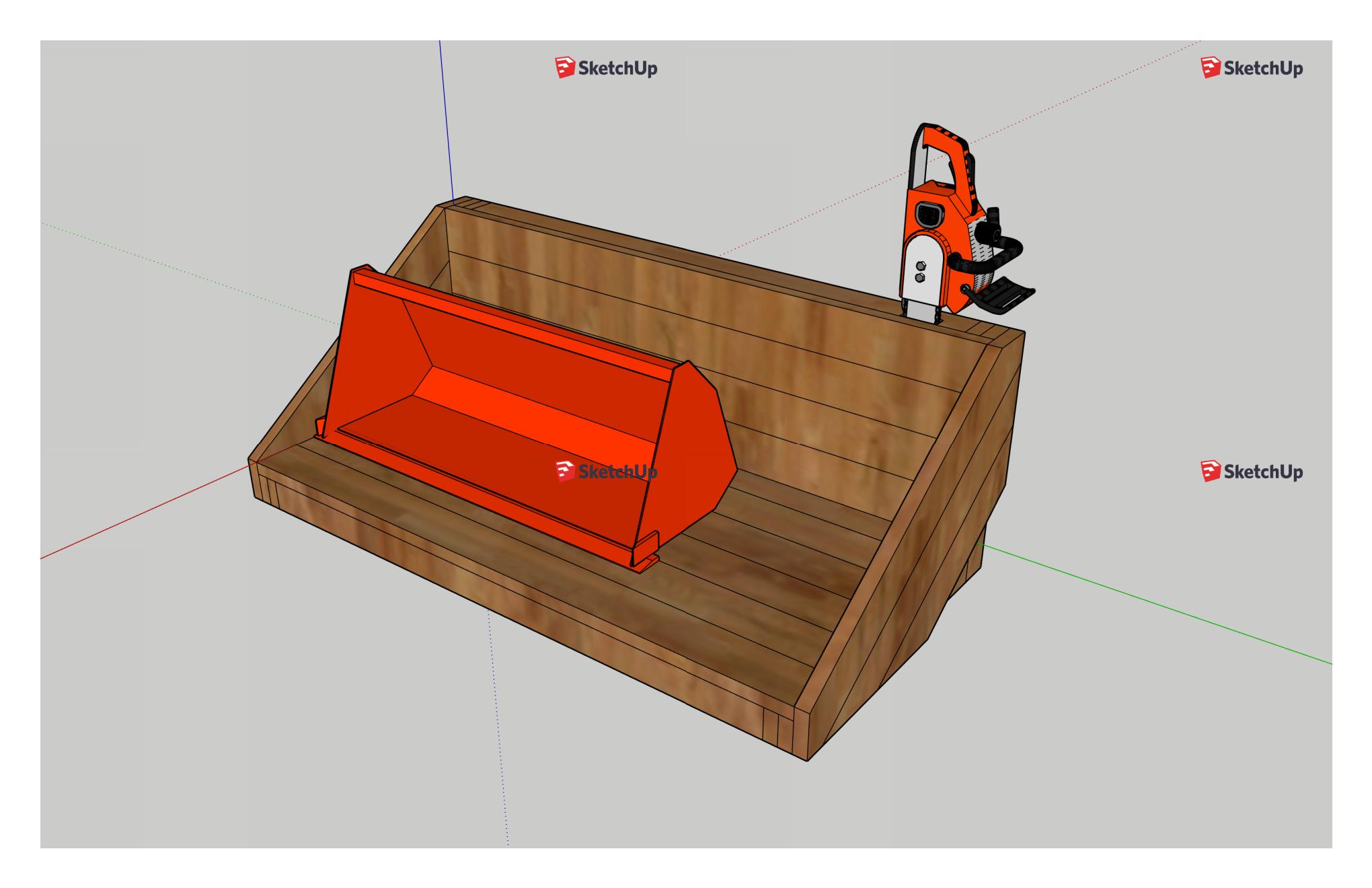

The carry-all would be about double the size of the front bucket in volume and ideally have slots for all my hand tools, rakes, shovels, etc. So it would allow me to bring everything into the field in one 5 minute trip as opposed to three 10 minute trips with the small FEL bucket. I would also carry the FEL Bucket out to the field on the carry-all that way when I get out to the work site I can drop the carry-all, release the QA and put the FEL bucket on and get right to work. Would save 50 minutes each day, which would add up to more than 4 hours in a 7 day work week.
I would never leave the carry-all on while working with the tractor, it would be strictly used to transport tools and non-loose materials. Everything else I will use the stock bucket for.

Can’t quite picture how you would also carry the bucket.
Perhaps there is a way to leave bucket in place and have a way to pick up the carry all, maybe a quick attach type point on the front of the bucket.

These images should give you a better idea of the scale of the carry-all. I put the BX FEL bucket on it so you can see the size.

If the wood is all 2x material, it might get a bit heavy too.
/ SSQA Carry-All
#16
I estimate about 114 ft of P.T. 2x6 conservatively at about 3.25 lbs per ft should put me at around 375 lbs of wood, plus the SSQA plate at 86lbs puts me at 456.5 lbs.
So yea current design appears to be a bit too heavy, I may need to use 1x6 for side boards. BX23s FEL can lift 613 lbs at the pin, so it seems you are right. I will need to bring the weight down on this design.

Thanks, that helps a lot. I guess I got confused because you designed it to look like a bucket. Why not design it to be more of a storage box? Put a top on the back portion of it with a lip to hold even more stuff? Maybe put casters on the bottom so you can move it around in your shop when it's not attached to the tractor.

Why not use plywood for the large surfaces? It's going to be thinner and lighter than 2x material and more rigid laterally, which on floor, back and ends is what you need. And yeah, no screws to connect it to the adapter plate, bolts all the way through with fender washers on the wood side.
