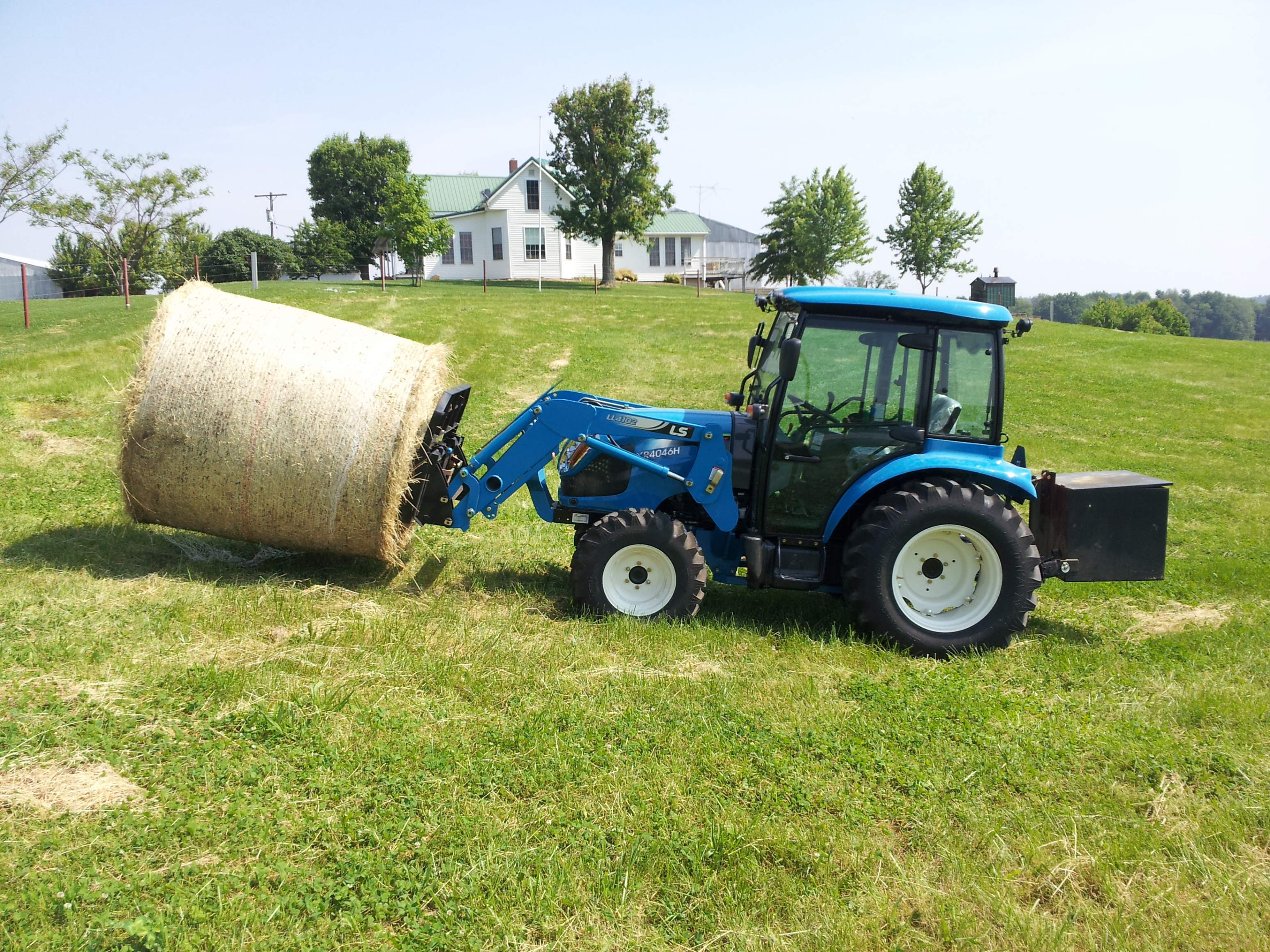

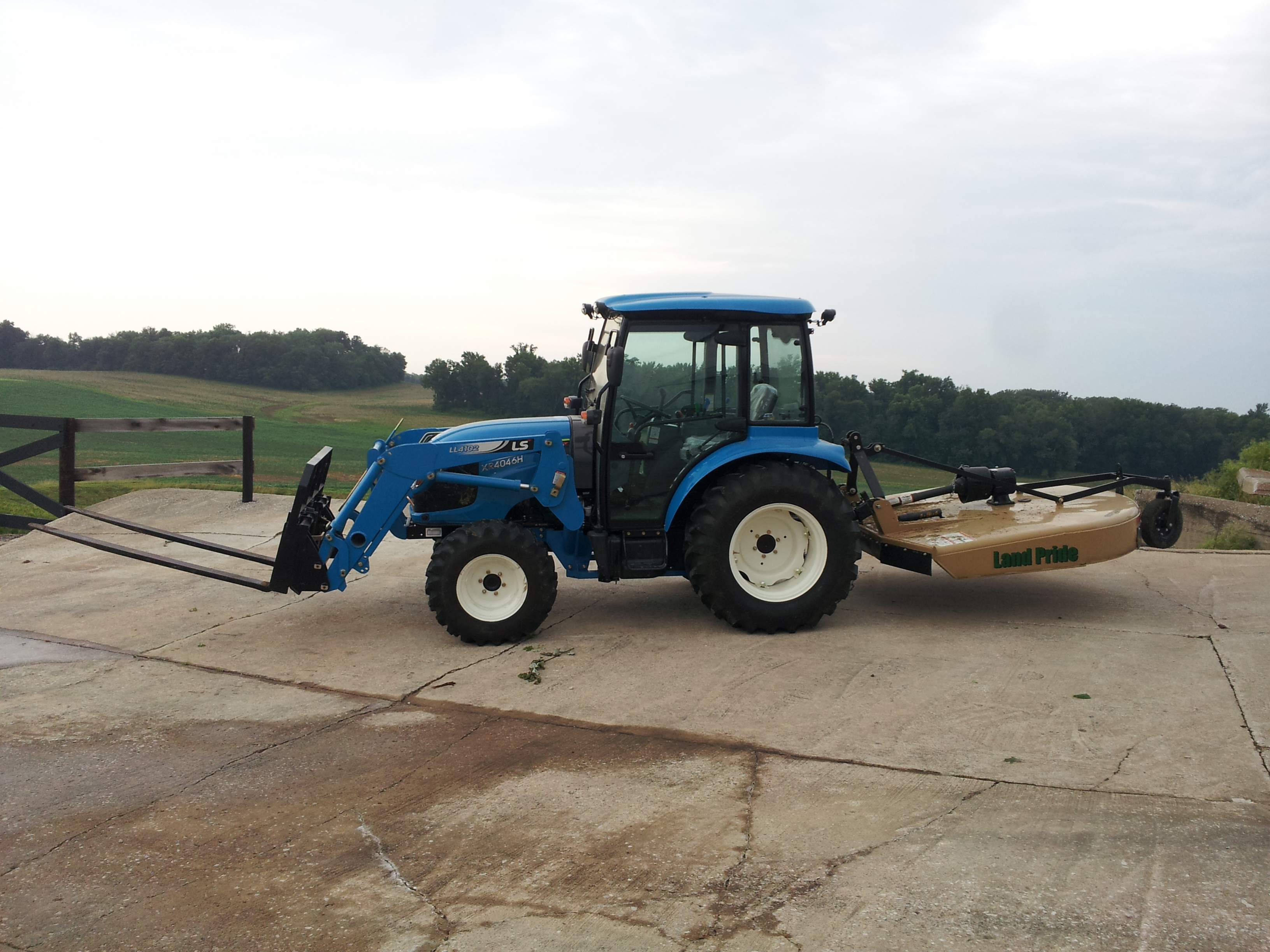

I have the Titan bale spear with 60 inch forks and am very happy with it.
