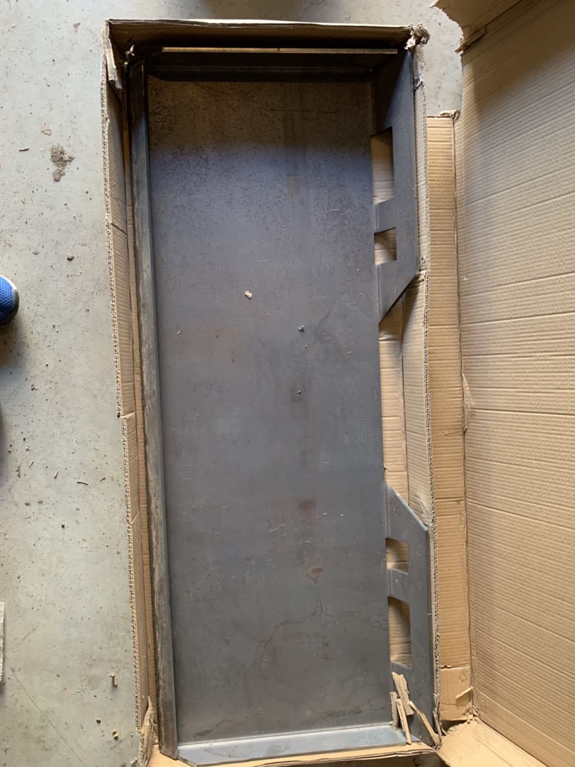

/ SSQA Plate #2
That looks fairly heavy. Is it 3/8"? First one I got is now part of an 8' power angle snow plow. Found a very heavy QA frame cheap on Craigslist that became a brush fork. They make a great starting point for lots of stuff.
/ SSQA Plate
It’s 5/16”. Very solid 81lbs. Trying to find a cheap multiprocess plasma cutter/welder and cutting off any excess. Snow plow would be an option. Maybe a platform to transport tools or stuff. 2” hitch would be useful. I have some clamp on pallet forks but I will probably buy some real pallet fork QA. I probably can’t make ones as good.

Is this a contest? Put me in for a stump bucket. On my list of things to build. Guess it depends on your available fab equipment what your oprions are. Nice position to be in.

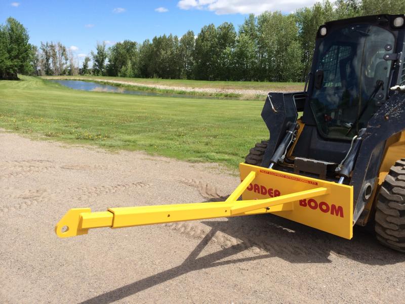

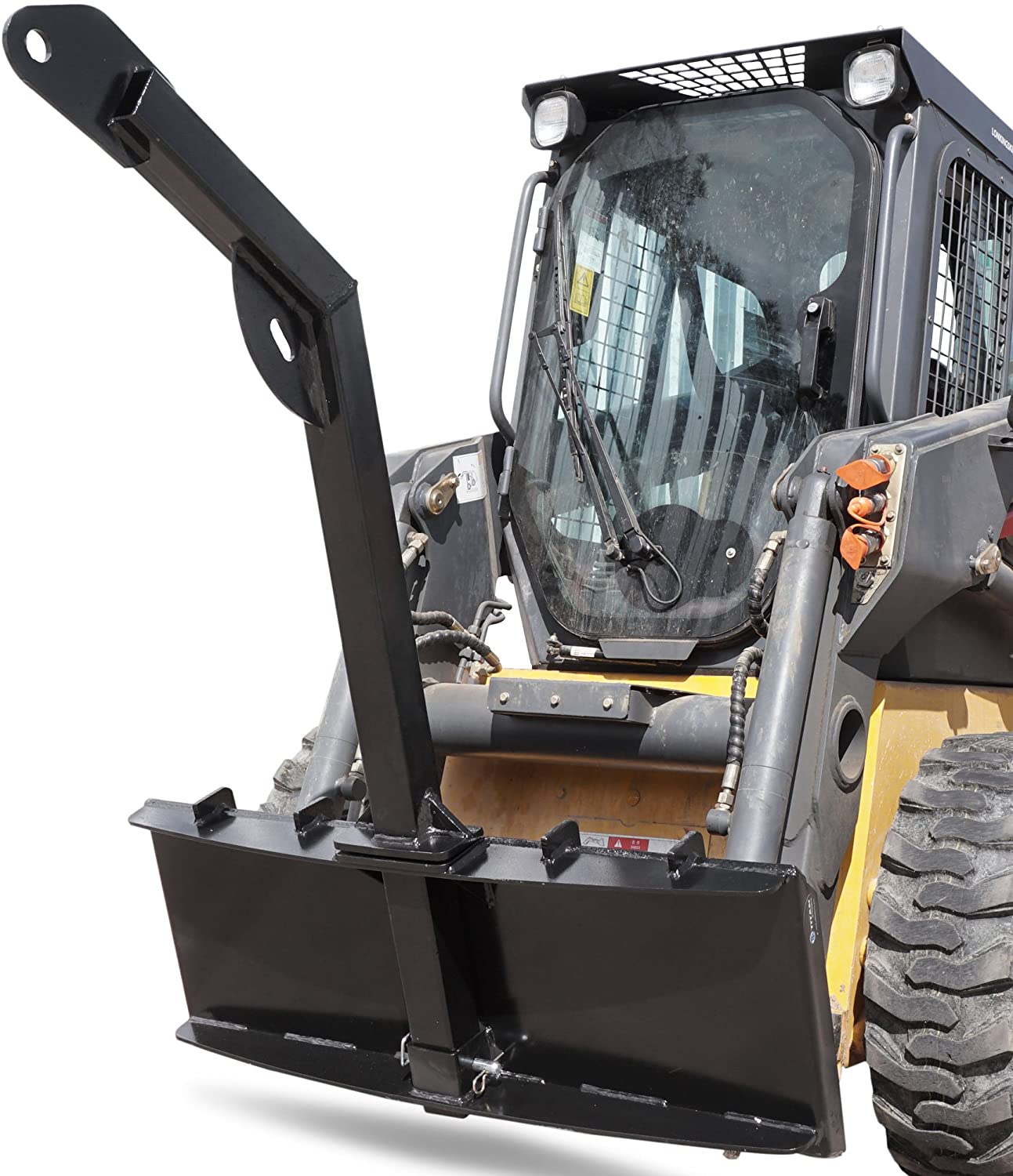

How about lift pole or loader boom:
