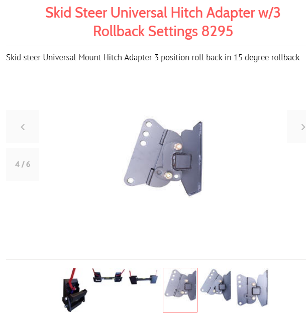

JasonI75, Check Washburn Company, they have several pin on adapters. You could call to see what fits your loader arms.
This one is different than most: Skid Steer Universal Hitch Adapter w/3 Rollback Settings 8295
