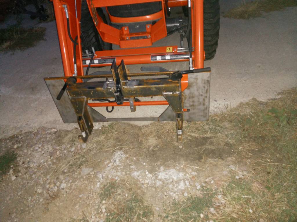

I have a set of Titan pallet forks and I can't see when I'd need more roll back on them. I have a box blade on order and I have a rake and it's possible that the increased roll back might be useful on them. I'll see what I can do with the parts I have. Might be a little while before I can get around to it and I'll try to remember to post a picture when I'm done.
   / SSQA to 3pt for the front of the tractor #24

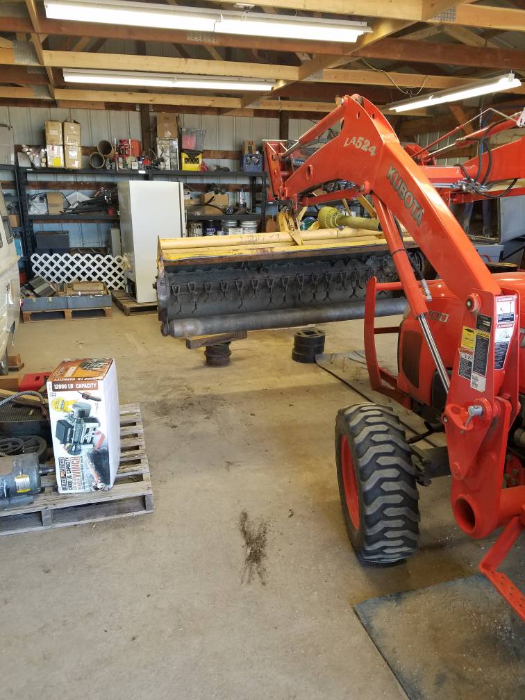

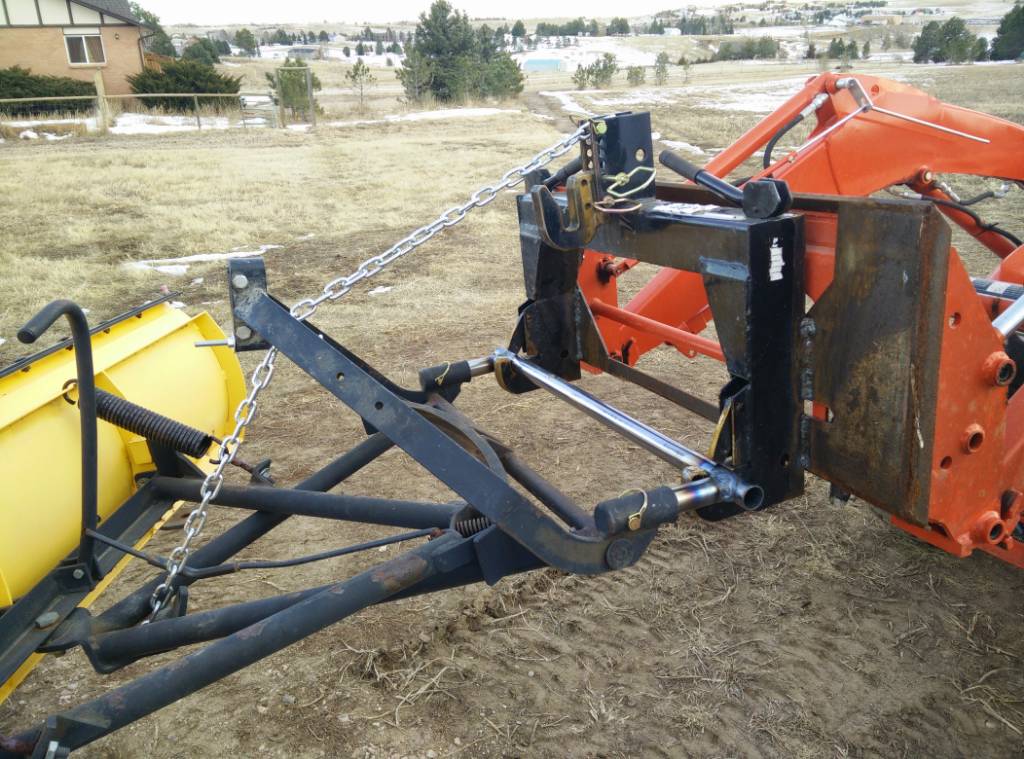

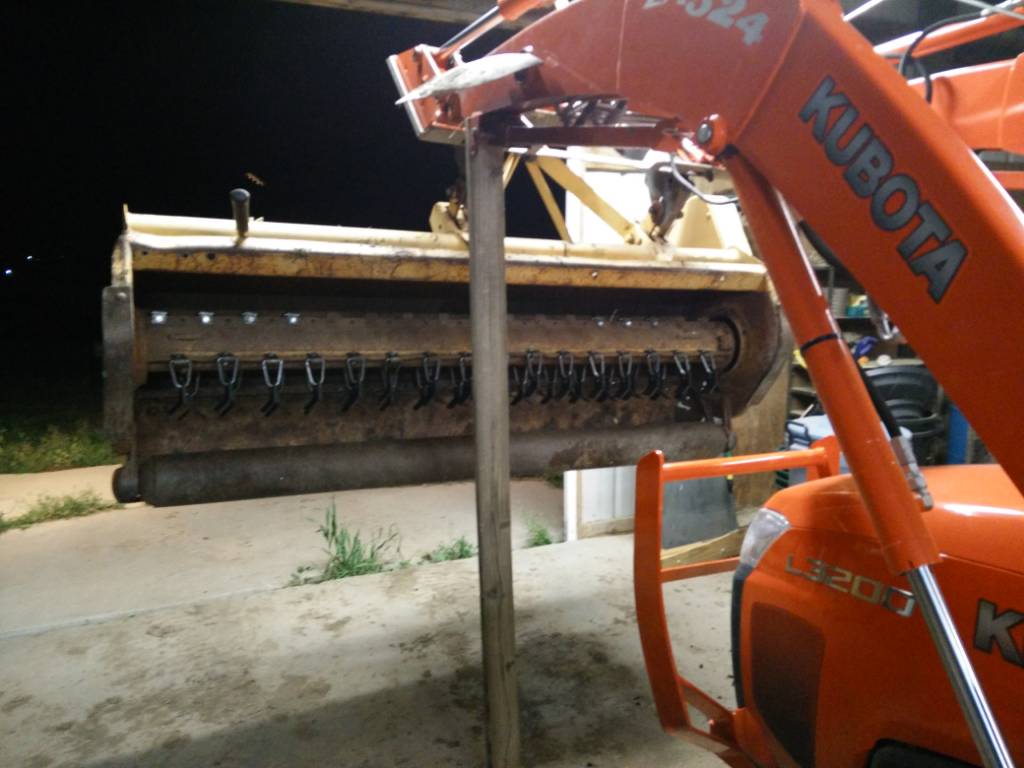

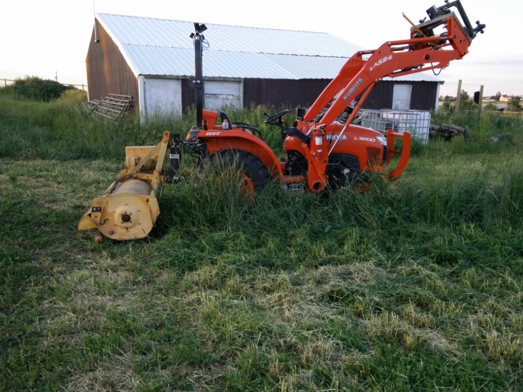

I welded a QH to a SSQA plate to make a mount for my plow. It worked well for that. It was handy for other stuff like flail mower maintnance & the trailer mover too.
I have a spare QH & SSQA plate still. Keep planning on making another to replace the old one that ran off with the old L3200 & plow. I might add more rollback to the new one. It would decrease capacity with the lift hooks sticking out further. But there isnt much roll back if you just mount things flat.IMG_20150117_153833-1.jpgIMG_20150819_201502.jpgIMG_20150612_213855.jpg20161025_152850.jpgIMG_20150626_200301.jpg
