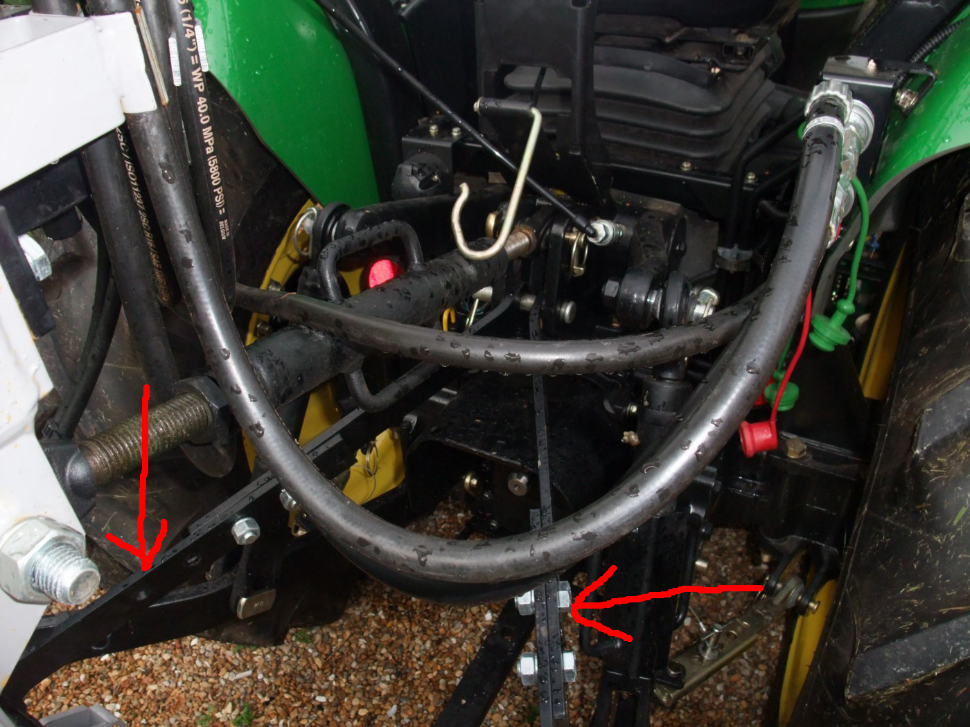

In fact I think we are speaking about what my manual calls "sway links", stabilizer bars (red arrows) are what you use together with the normal three points to help handle cumbersome or top-heavy implements. I try to have them rather tight but they keep getting a little loose, which can be unpleasant with heavy equipment swinging from side to side, rocking the tractor.
Our LS manuals call them "stabilizers." The manual for my R4010 calls for a "swinging clearance" of "20~40mm (0.79~1.57 in.) left and right."
