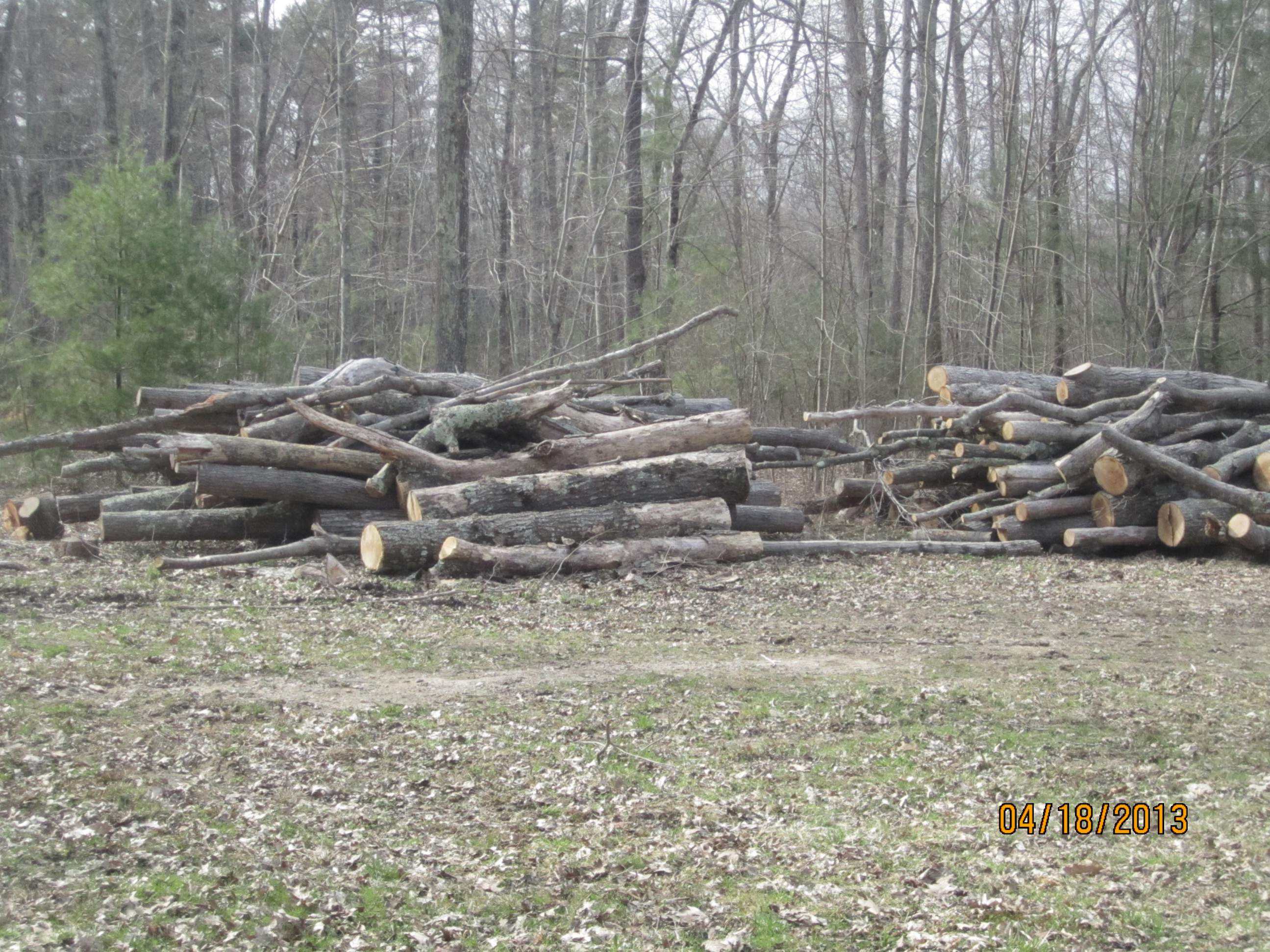

I'm gonna say something that may surprise you: You do not want stacked stems neat and orderly. They are much easier to cut up when askew as opposed to neatly stacked where one log after another gets in the way of your sectional cutting. I purposely stack my stems this way as it speeds the process for me. You'll notice they are staggered and tilted. I first noticed this on the job and how sloppy piles got cut up faster than neat ones. Everyone's different with different ocd quotients they must adhere to. By the way, these are on old railroad ties

I have to agree with you here, having spent a lot of time recently cutting logs out of a pile that was stacked by an excavation service. There are several advantages to a messy pile. First, it is easy to get a hold of one end of a log to pull or roll it out of the pile. If you have a cant hook or a peavy hook, you won't easily get a hold of a log that is nestled in with a bunch of other logs, but if its end is sticking out, you can get a grip on it. Second, if a log is cross-wise with another log, you can often see-saw it very easily because it will tend to be balanced on its midsection. This will allow you to move a big log by hand that you could never lift if it was not teeter-tottered. Third, if you can't get a log out of the pile at all, you can just start cutting rounds off the free end until it's light enough to move.
If you have a grapple and can easily place the logs wherever you want them, then stack them neatly. But if you will be breaking down the pile by hand later, a messier pile may be better.
As for the suggestion to stack them in rounds: I wouldn't do it, but that's just me. I hate, hate, hate having to stack wood more times than I have to. I cut logs into rounds and leave the rounds in big piles that I dump out of the bed of the truck and then pile up with the loader. Then I split the rounds out of the pile and stack the split wood as I go. Seeing the messy pile of rounds motivates me to get splitting, whereas if they are neatly stacked, I tend to forget about them and then they're not ready to burn when I need them.

Josh you bring some good informational aspects as to whys of this. I would also say to the average lay guy cutting wood from stem piles is to be very careful how high you think you want this pile. These things can be treacherous to actually be on or under. If you have equipment that is picking out the logs before cutting that is one thing. If you are cutting directly from the pile, I'd make multiple piles only 3 or 4 ft high.

It's true. Honestly, I think a lot depends on the nature of the pile. The pile I've been working on has been mostly trunks, about 10-12' long; the tops have been piled separately by the excavation service. This is a whole different situation than, for example, if these were freshly felled trees, where there might be branches or other trees under a lot of tension. The pile of trunks is not perfectly neat, but with a little care, I can usually identify a "free" log that can be easily rolled off the pile. I always try to identify a log on which no other logs are resting, to avoid a cascade effect. I spend a lot of time studying the pile and thinking about which should be the next log I free, and what is going to happen when I push on it or roll it.
If I can, I roll from the side of the pile, using the cant hook, so that any unexpected rolling goes away from me. The worst is if I have to climb up onto the pile to get a log free. I'm very, very careful to try to pay attention to where I'm standing and to make sure that the log I'm freeing is going to roll clear of the pile without affecting any of the other logs. Again: if I'm uncertain if something is safe, I try to fall back on cutting the sticking-out ends off of logs until they are light enough that I can easily move them. This is not totally benign, but since the ends are sticking out, there should be nothing resting on them, and so cutting them off shouldn't have too much effect. The main danger here is using the chainsaw in tight quarters, where nose contact and kickback may be a concern. Also, I have to be a little careful not to get hit with the rounds as they drop off and roll off the pile, but that's not too hard.
