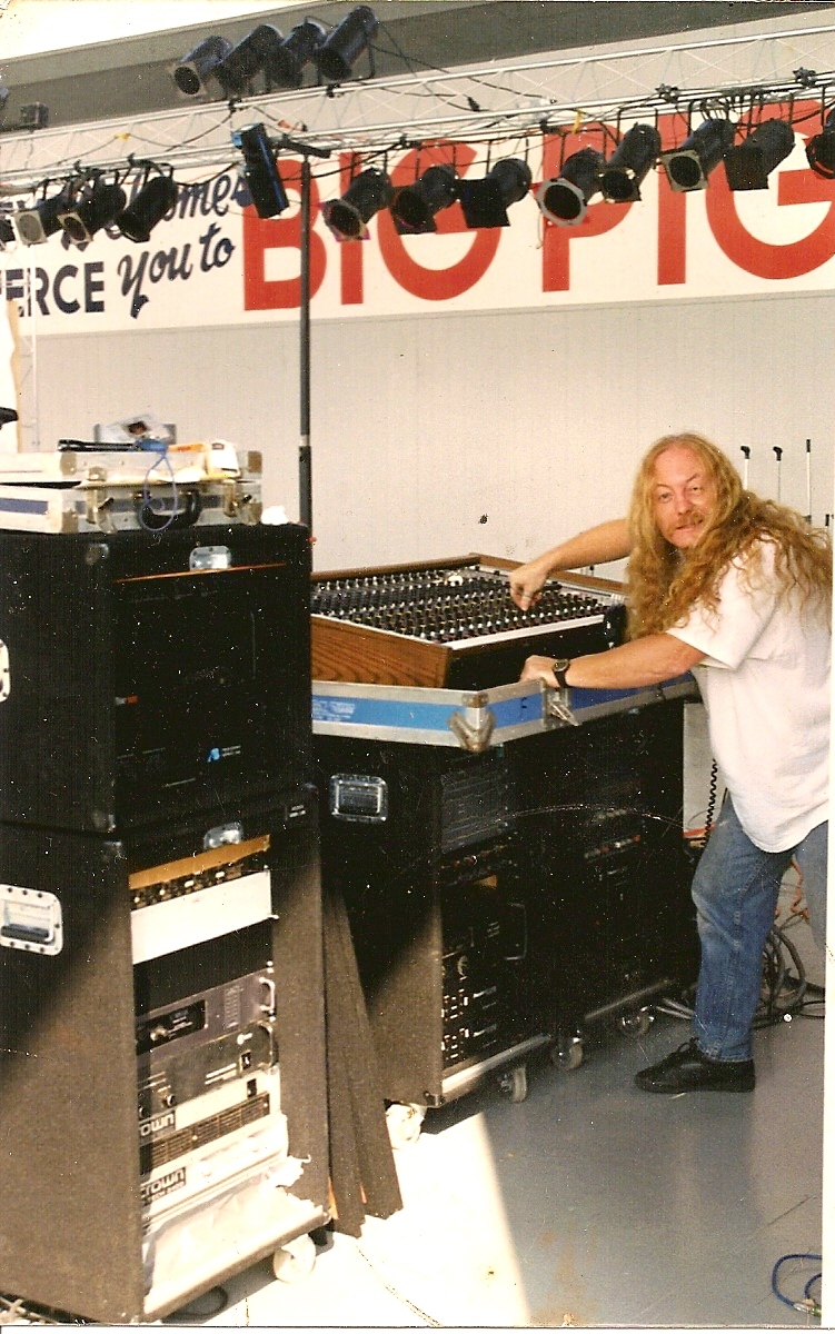

Best stage roof is a straight one, high in front low in back, that way it'll drain any rain to back side. Have it stick out in the front so you can hang light cans far enough out so they won't be shining straight down on top of the front guys head. Be careful with tarps over lights. The get hot and will catch fire. And the most important things to add are Ground Fault Current Interupter (GFCI's) breakers or outlets. It's cheaper overall to use GFCI breakers in your service panel. One electrocution will ruin your party.
