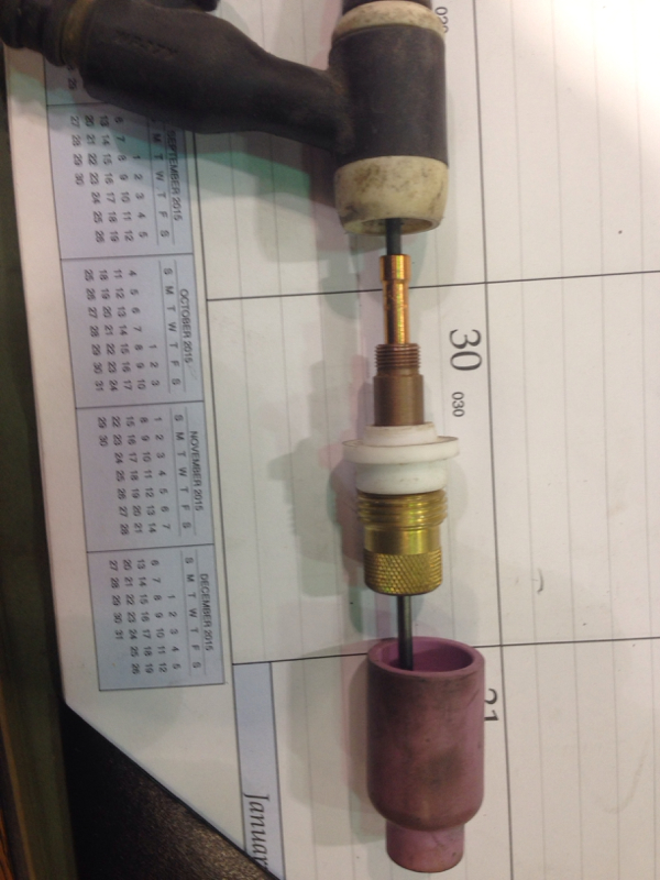

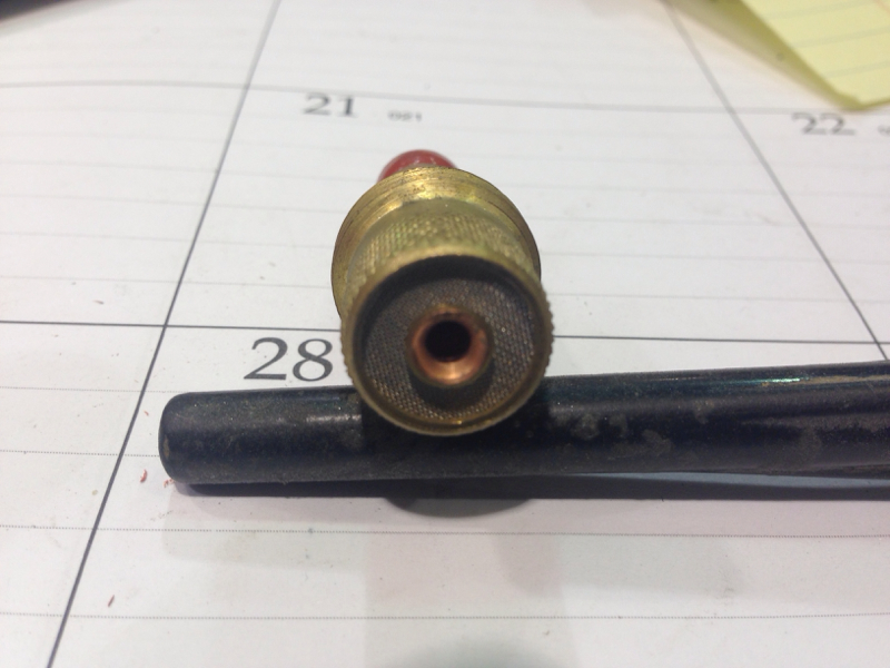

This is the assembly of a tig rig. The gas lense cup the gas lense the collet the plastic adapter. Throw away the collet body.
