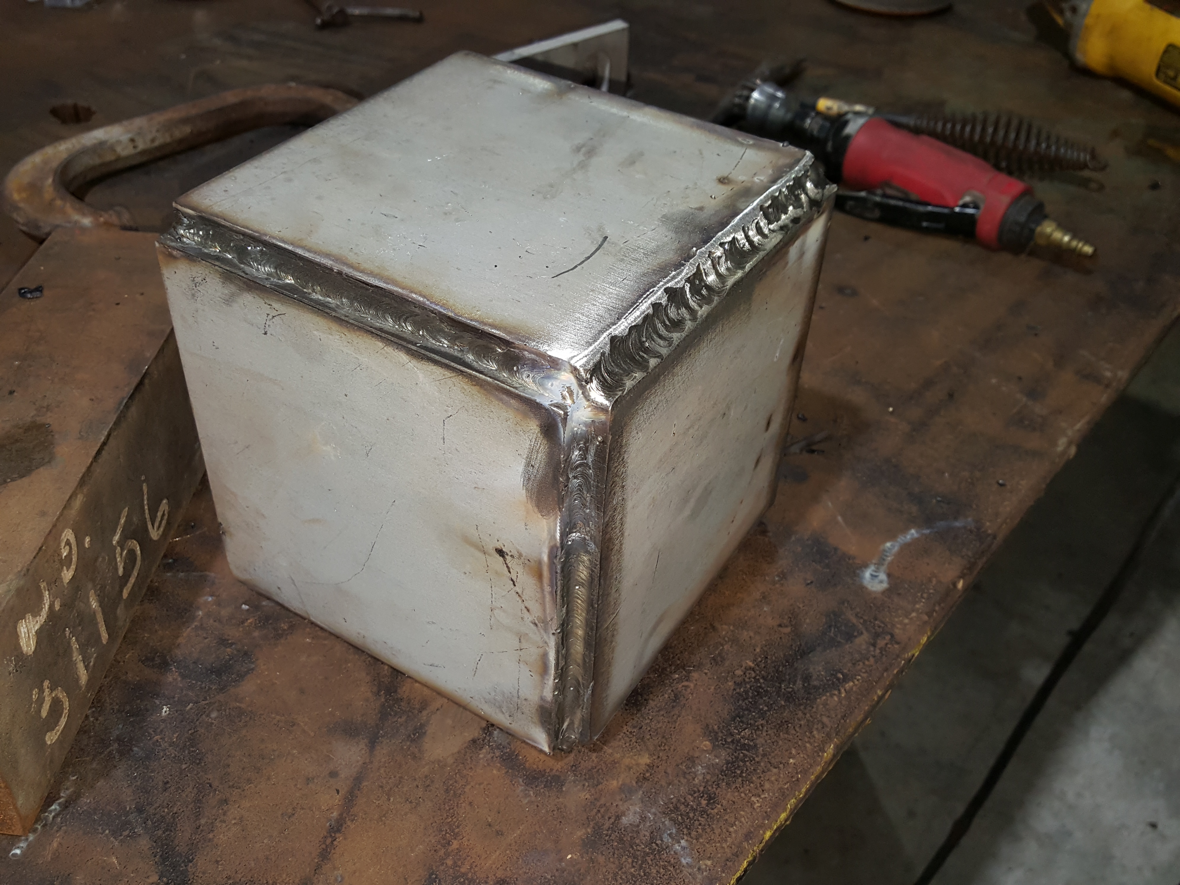

I'm stick welding up some Christmas decorations from some stainless steel plates that I got for free. I believe they are 316 based on where they came from but not 100% sure. I welded up some of the ornament with 312 rods from TSC but, wow, they are expensive. I'm going to the welding supply store tomorrow. Should I get 308L, 309L, 316, or something else?
First time welding stainless, so don't be too harsh, there is some slag inclusion.

I will let the experts comment on rod choice. Looks good to me... especially for decorations. What exactly will it/they be?
/ Stainless welding project #3
You could use any of the rods you listed but 309 is for welding stainless to steel. 308 is used for 304 stainless and 316 is for 316

Beings as it is not a structural project; get the cheapest SS rod and try it first, then move up if that does't work. I have used 304 and 308 as a gen purpose rods. Most of my construction stuff was 304 stock, very seldom ran into 316. That looks like a pretty hefty item for ornament work.

Any SS rod is fine. 308 or 309 may be the least cost. Get the LHS or LSI version. = Added silicon, lower carbon. LHS and LSI mean the same thing. They will wet out the best. 312 is not needed for this project. It's probably 4X higher cost. If you have any left, save it for unknown or dissimilar metals or cast.

I got 3 pounds of 309 rods today for $8.50 a pound. Much cheaper than the 312 from TSC, like 4x cheaper! Thanks for the help.

I finished the decoration in time for our Thanksgiving swap. I think it turned out well. It was a lot of welding with 1/8 rods and I definitely got better the more I did it. Stainless wasn't really any more difficult than 7018 but sure does hold the heat. It took almost 2 hours to cool down to ambient. If it was something with real function, I probably put too much heat into it. Please enjoy the video.
