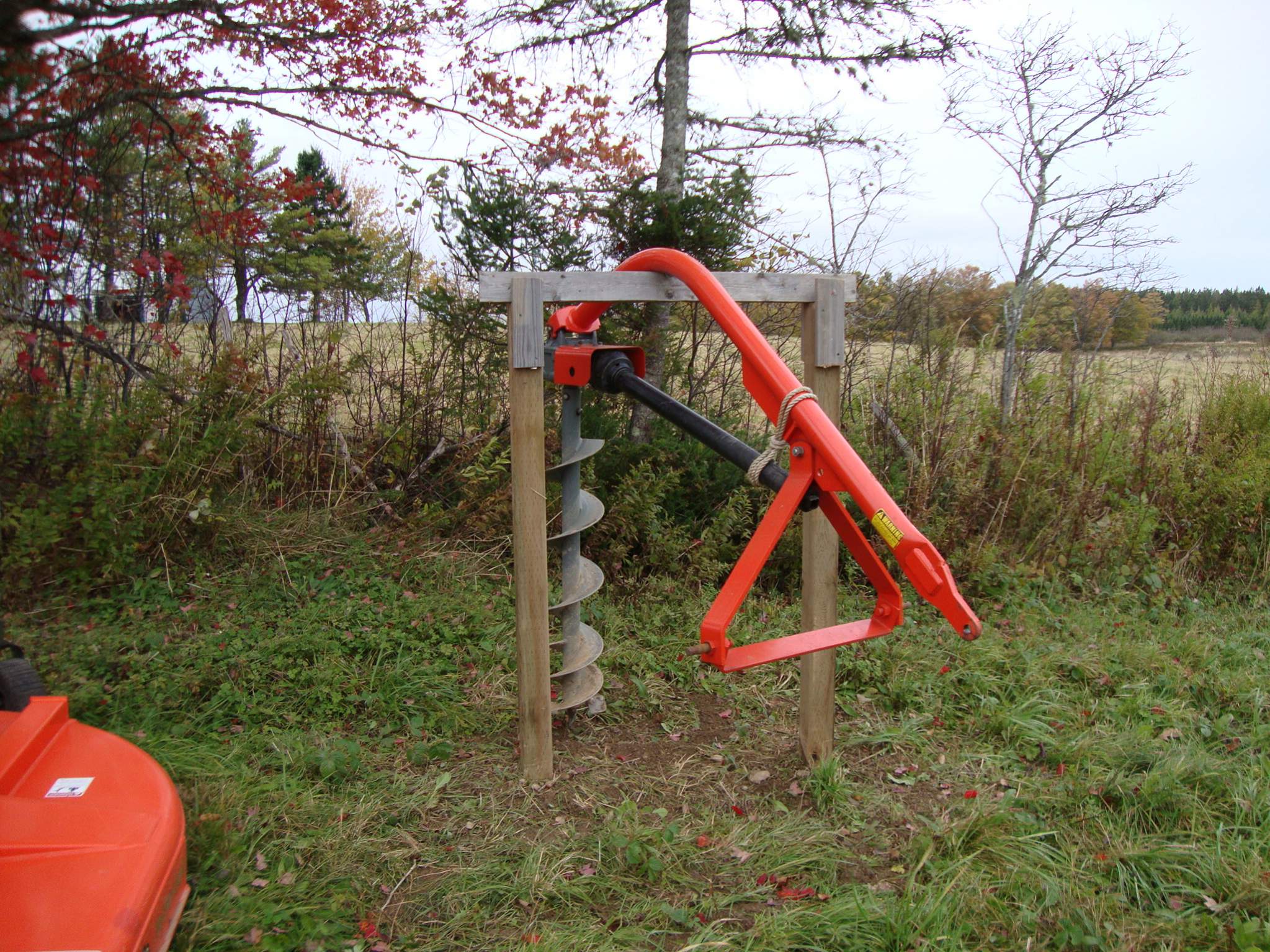

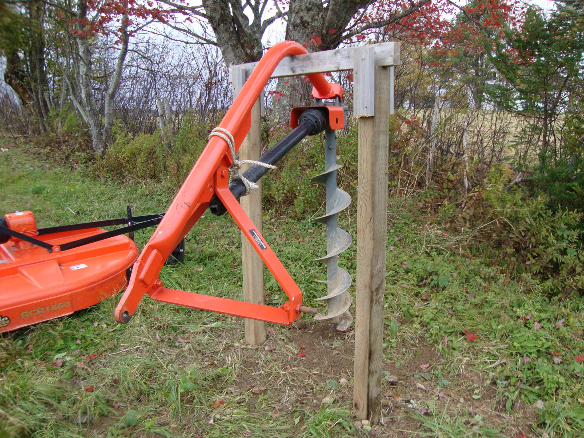

Posthole Digger Stand for my Posthole Digger
/ Stand for my Posthole Digger #21
I store mine against the wall in my shop, it is the easiest way I have found to deal with it and it doesnt take up any room at all.

Timber,
That's how I do it it too. I don't have a convenient place to hang it where I can get to it with the tractor. So, I pull the rod attaching the gearbox to the boom. In two pieces I can pick it up and carry it to the back of the barn where it stays dry and out of the way.

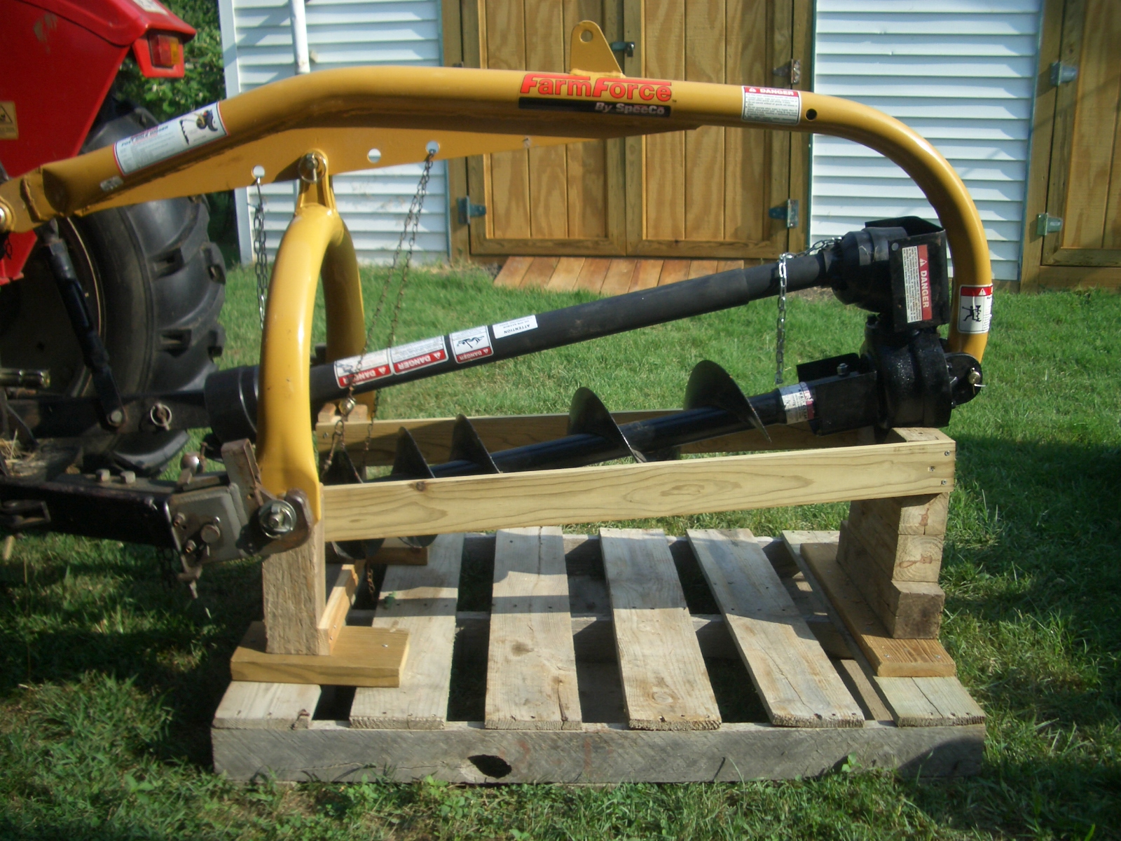

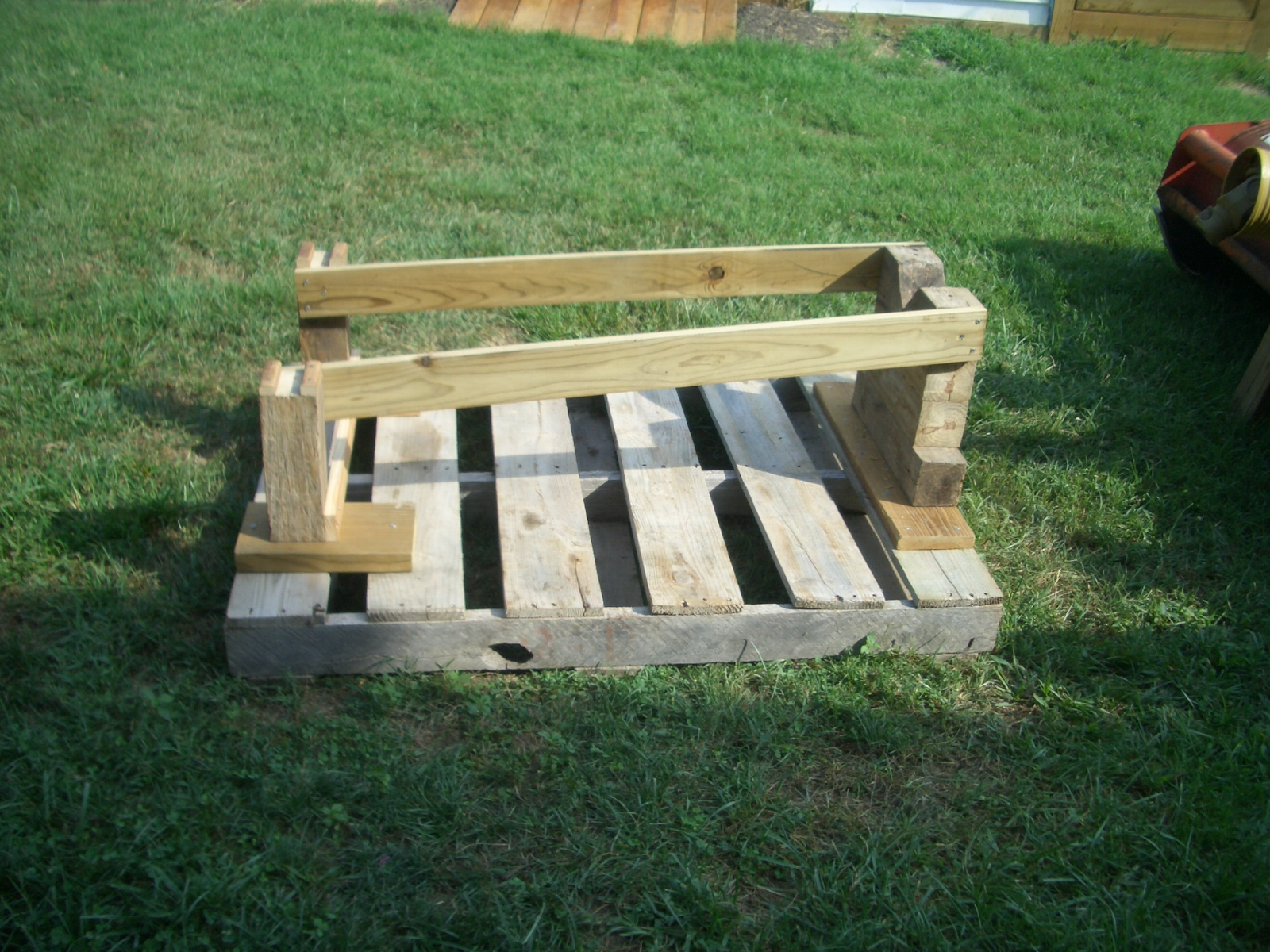

Mine is two pieces (8 ft ) of 4x4 dug into the ground with the PHD, and a couple pieces of 1x4 nailed to the top sides. A 2x4 completes the stand. You back into place, lay the crosspiece in place, lower the PHD and unhook. Hookup is just the opposite.
Sean
Sean
Great stand. I'm going to duplicate. Thanks for sharing.

Easy to hook / unhook & keeps it out of the elements:
