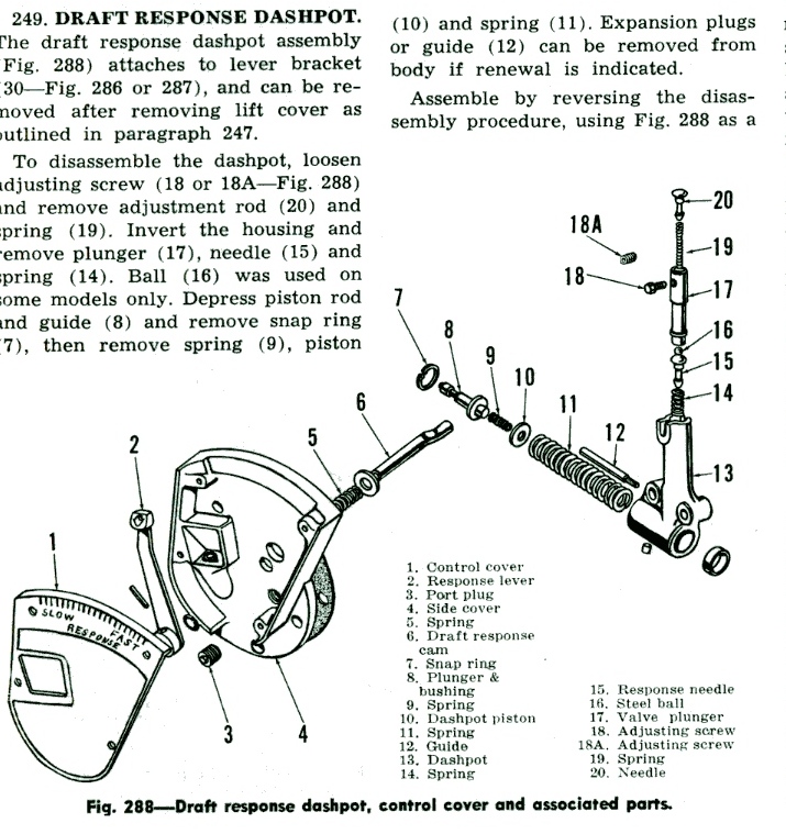

   / Stand or stack pipe below hydraulic lift cover
Thanks everyone.
I have drained down the oil into clean buckets.
I have removed the lift speed adjustment lever, complete with draft response cam and cover.
I found and replaced the stand pipe with new O rings.
So far so good.
My final concern is replacing the lift speed adjiustment lever.
Please could someone advise me on where and how the cranked end of the draft resonse cam is located?
Plus any hints on how to make sure I've done the job properly.
Thanks
Ian M
   / Stand or stack pipe below hydraulic lift cover #8
isn't there an I&T manual for that tractor.. shgould have all that in exploded diagrams.
i know they have them for ford, ferguson, AC, case and JD....
Hi Soundguy and Kid.
Please be patient with me. I'm a geriatric former UK school teacher playing at being an engineer!
The picture shows the bit I'm talking about.
I bought a "shop manual" when I acquired the tractor and I'm using the terms used in the book.
Simply where does part 6 in the diagram go and what is the easiest way of fitting it! Tractor005.jpg
Thanks. This site is much more helpful than the manual.
