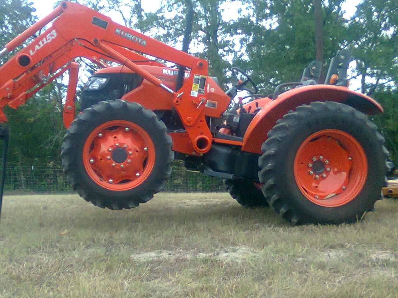

Spending the $400 sounds like a good investment:D If you write it off on taxes youll get some back:thumbsup: 5040 and ds1440wheelie.JPG
