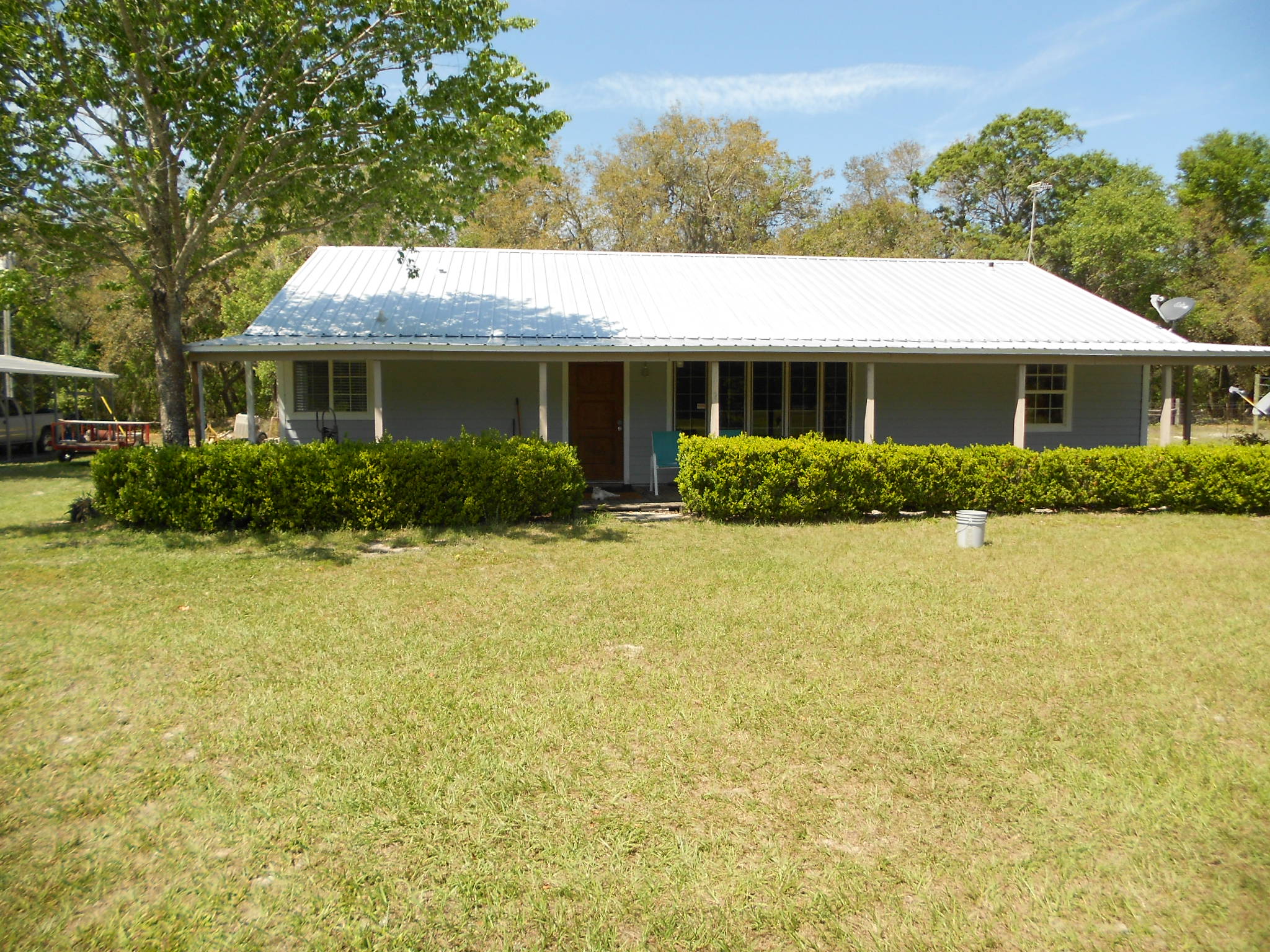

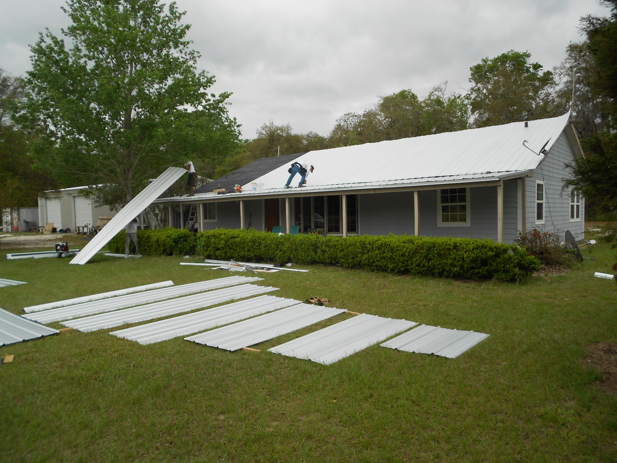

OP doesn't show his location?
I had a new metal roof installed last April by a licenced roofer, permitted and inspected.
It is galvalume 3' panels and the roofer has his own (expensive!) roll former and Brake to make the panels and trim at his shop.
I had him install it over non-leaking shingles with synthetic felt under it.
They vented the ridge and capped it. My house was cooler last summer too.
They per-drilled the panels and screwed down through the ribs, approved by engineers.
He said less chance of leak on rib verses the flat.
It cost me about $260. a square, several thousand less than closest estimate.
