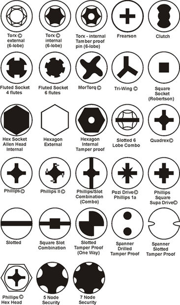

Great chart. I have one to add. I have a box of #8 self drilling/self threading metal screws. They have hex head on the outside and torx on the inside.
Haven't seen those.
Do you prefer to use the hex, or the torx?
I find a good magnetic nut driver works well. But have never had the pleasure of using torx drive for a sheet-metal screw. Only wood screws and the larger automotive fasteners

I noticed another screw head not on the chart. It is called double-square. I ran into them when I had to replace an aluminum panel on a Haulmark trailer. You can get eight point driver bits but a regular square bit fits too.
