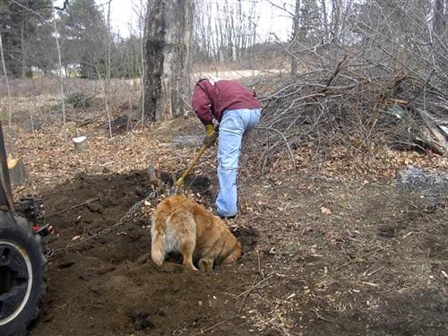

#18
Well, gave the hitch another test run today pulling some stumps. I was having a tough time till my helper showed up !!

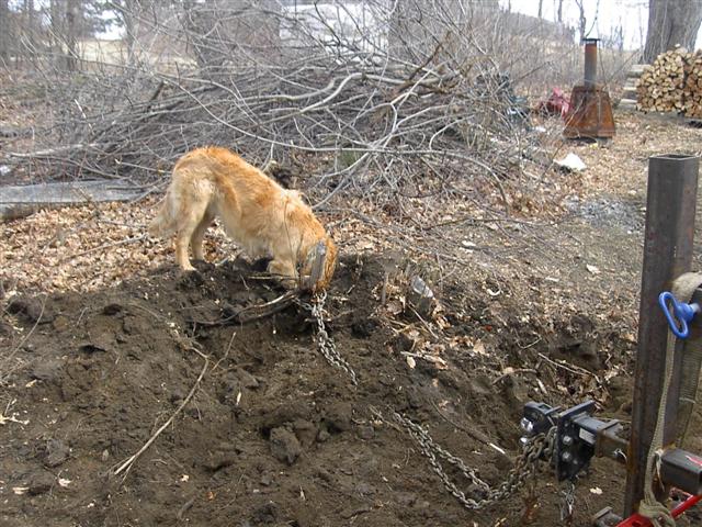

#20
Hmmm..... i'll try again.
