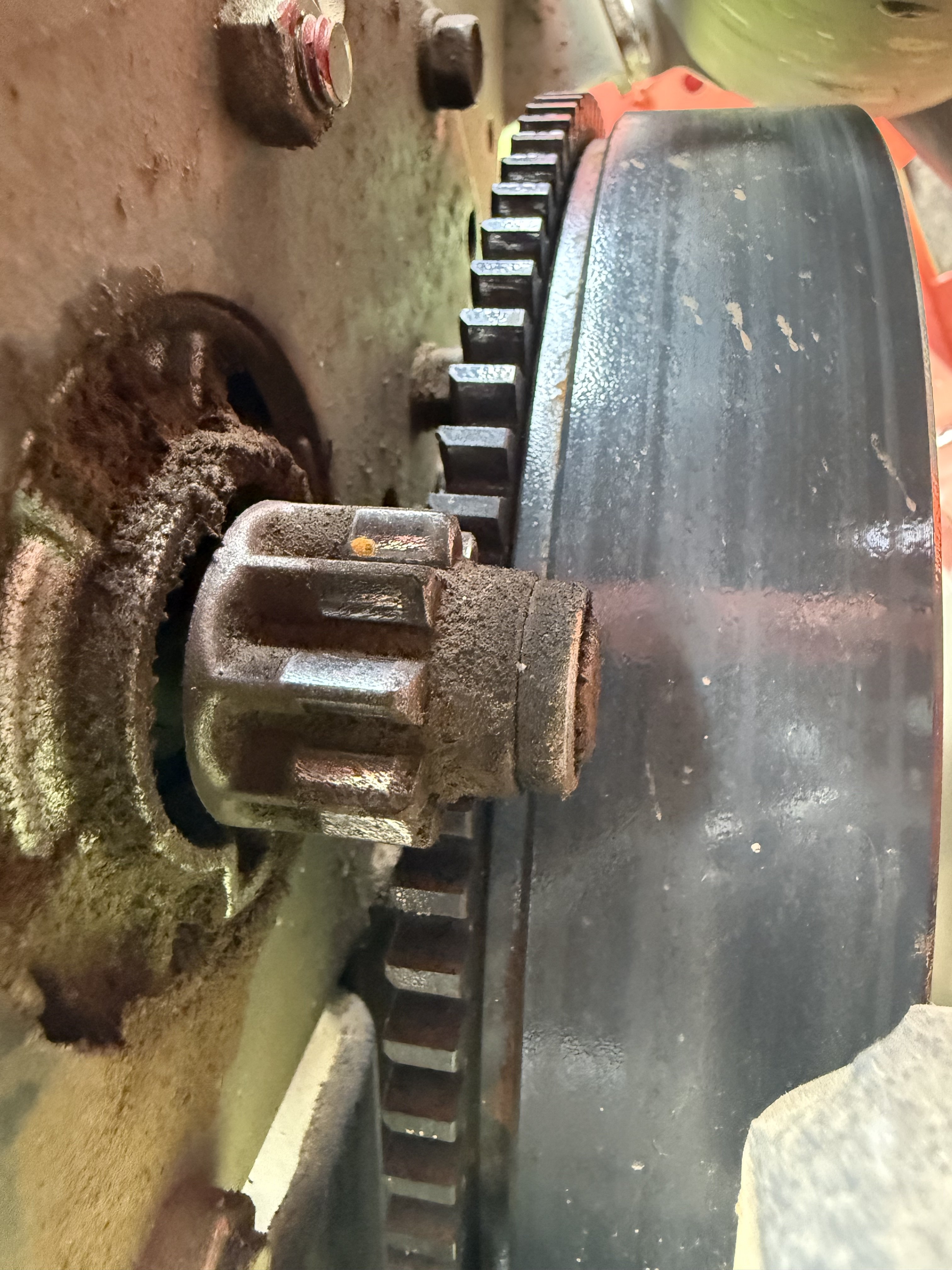

This starts like all good stories… someone borrowed my tractor. They said it sparked, smoked and stopped running. When I got there it wouldn’t turn over only a starter click. Battery voltage 12.5V. Brief inspection looks like the hot terminal on the starter shorted and melted the rubber covering. I haven’t begun troubleshooting but guesses on whether it’s going to require a starter replacement or something else? Thanks!

Is there a vent hole in that starter with some smoke stains around it? It’s probably the camera angle but it almost looks like the starter is sagging down on the left side.
/ Starter fried? Newer Kubota BX 2380
Yes it looks like overheating. Maybe the starter got hung up with the flywheel causing mucho heat and failure. I might take it to the dealer since it’s newish and I don’t have time right now. Meanwhile outside “I am the grass, let me work “—Sandberg

Upon closer inspection the bendix was still engaged to the flywheel. It was easy enough to retract with a couple of taps, but still nothing but a click on trying to start. Meter shows a voltage drop which I interpret as load from a burned out starter motor?
Def gonna take it to a shop, but the $95 ebay replacement is also on the way as a temp/ spare.
Thanks everyone. I’m just a curious amateur so let me know if I’m off track
