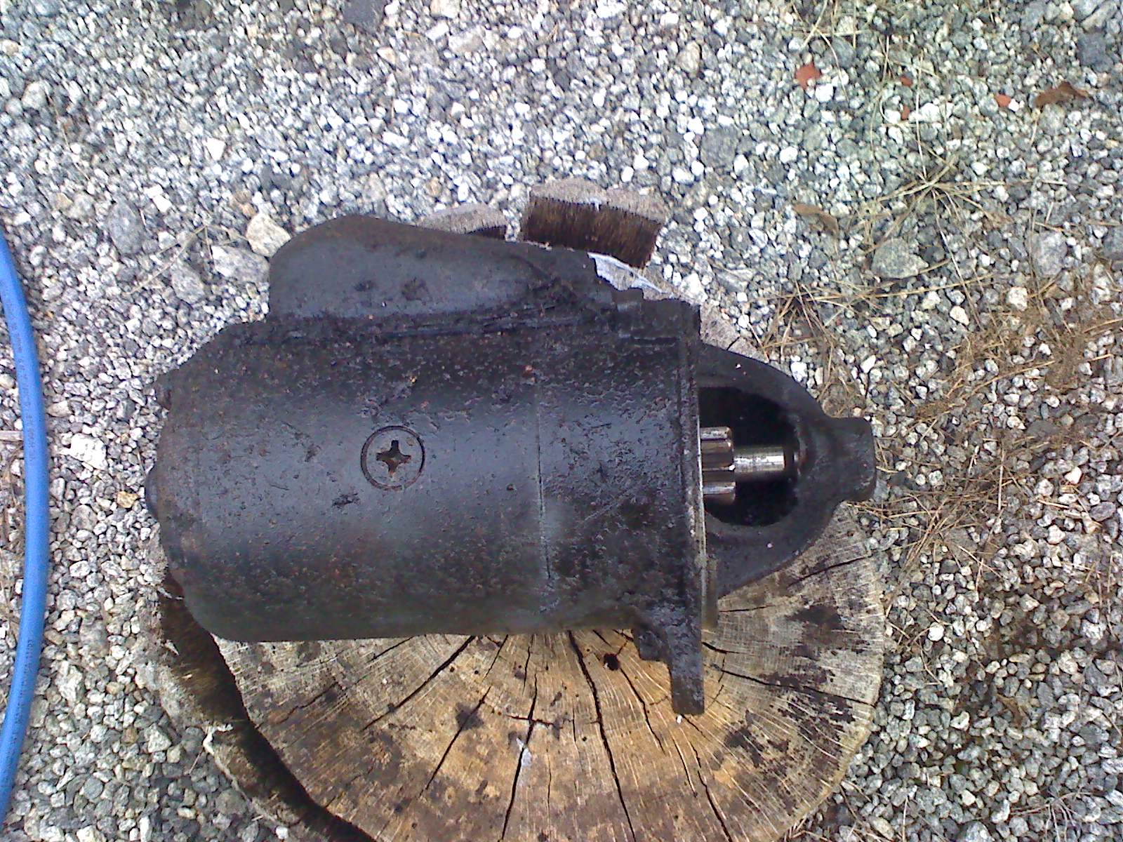

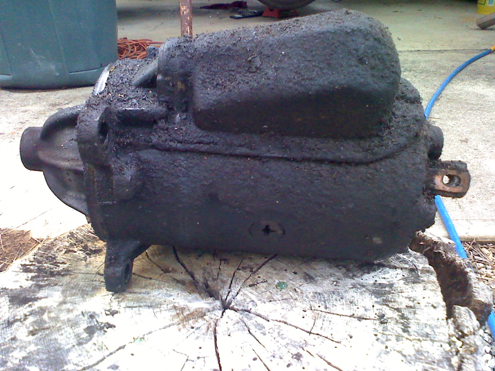

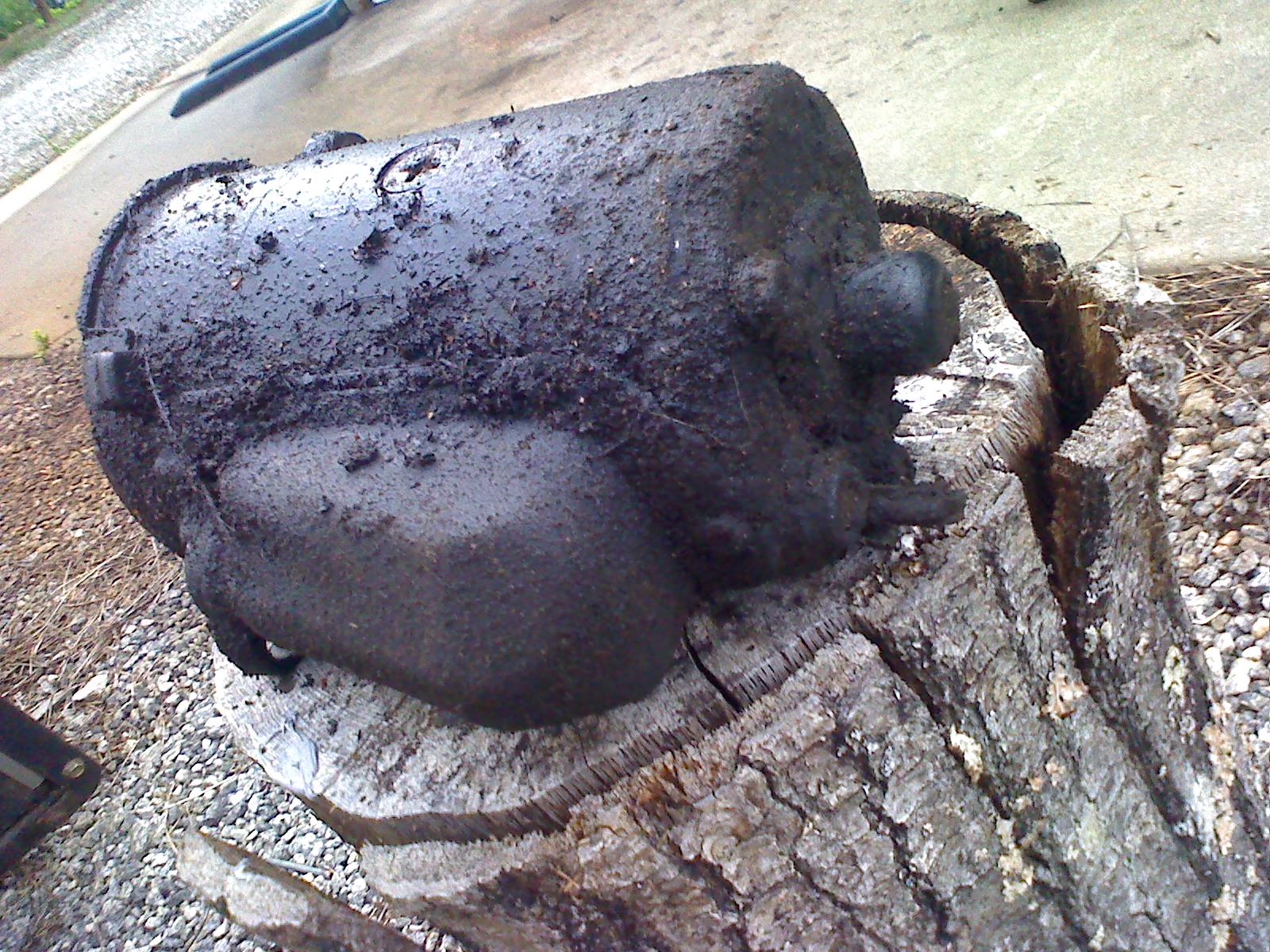

0713122004a.jpg0713122005a.jpg0713122005b.jpg0713122005c.jpg0713122006a.jpg0713122006b.jpgOk took 10 mins while between grilling dinner and then after to remove it. As promised here are some pics.
As you can see its quite dirty from miles of running dirt roads and 20+ years of road grime that sticks to a starter that is wet with oil from a leaky old motor. So you see why im not to quick to pull it apart. I probly should but im not.
Note the end of the shaft the bendix rides on the end looks like it has wear. Also not sure if you see the tiny buldge on the open end but is that suppose to be like that?

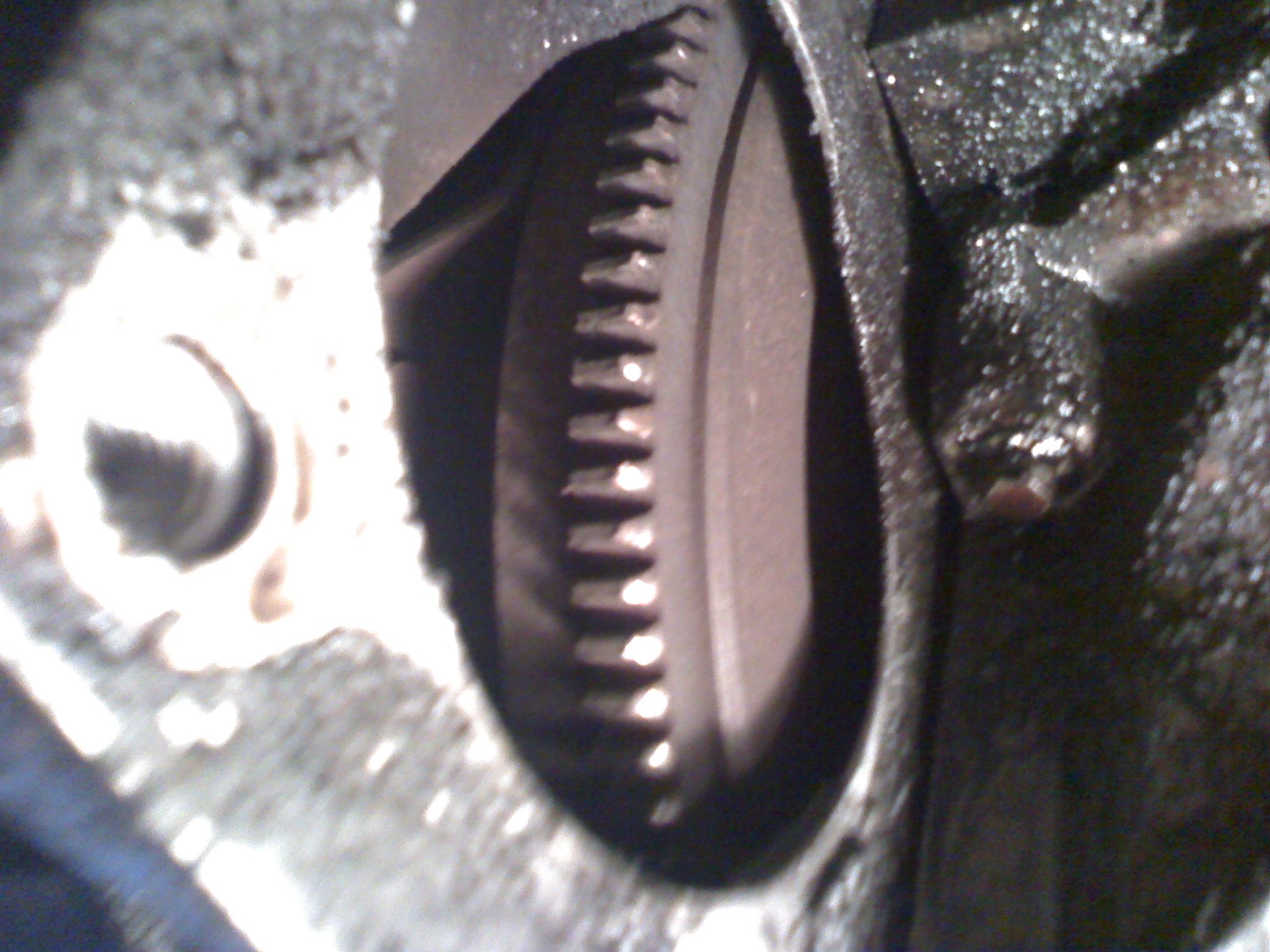

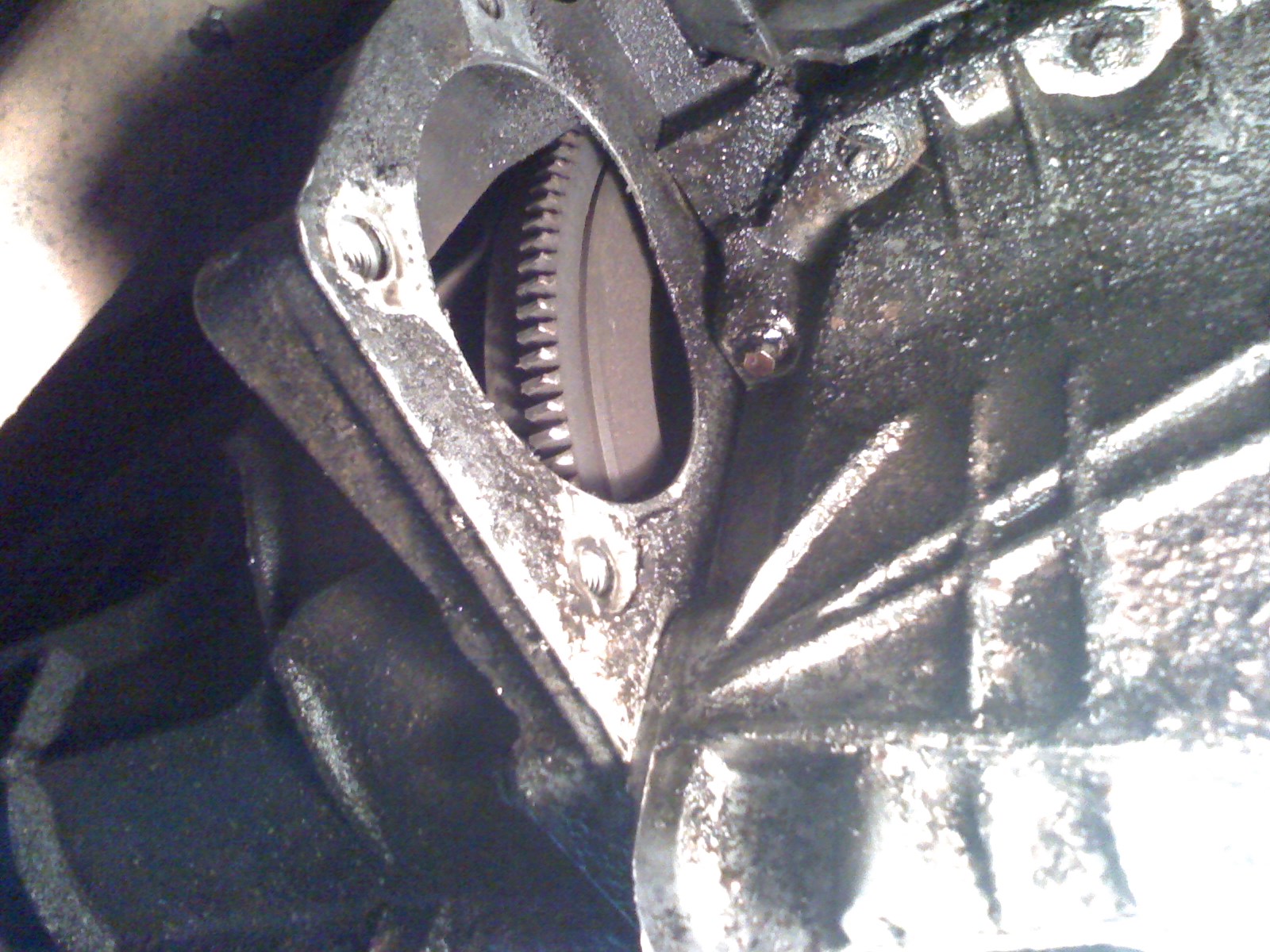

And you can see after all these years its wearing the edge of the flywheel but nothing to alam me, after all it has some age on it.

Throw it in a plastic bag and trade it in for a replacement. Just dealing with the grease and slime alone is not worth $35 (at least to me).
   / Starter going bad in Ranger #29
I agree, get to Auto Zone or Advanced and pick up a cheap replacement.
Chris
   / Starter going bad in Ranger #30
fo sho. the time you waste on cleaning it and replacing a sinlge part would be better spent putting a decent priced new one on..
