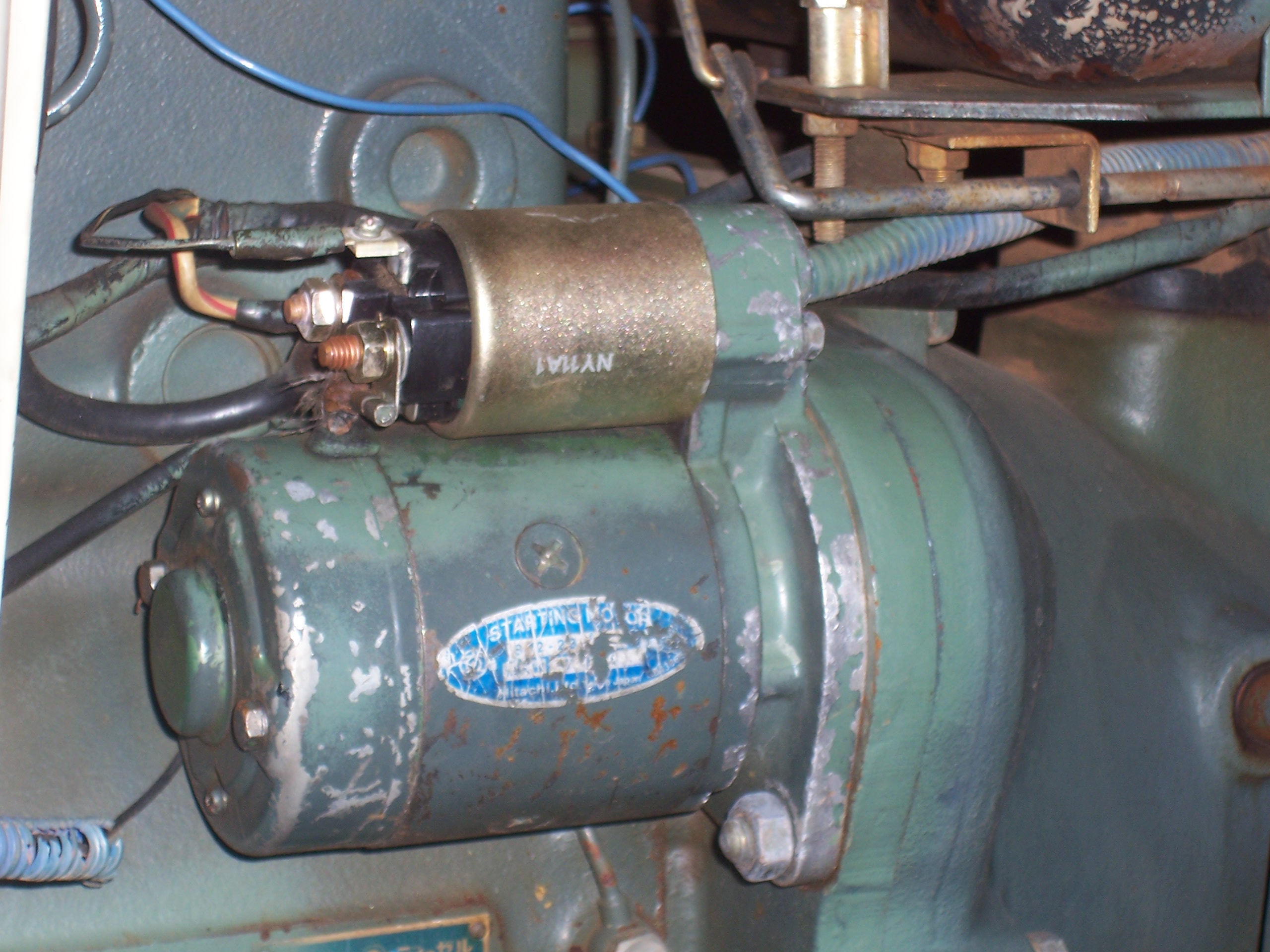

Help! 2 weeks ago the starter on my tractor started acting up. When I tried starting it the lead off of the solonoid would smoke. I took it to my local starter repair place and they rebuilt it and put a new solonoid on it. I reinstalled the starter and it worked fine for about 5 starts and when I turned off the tractor I heard a "whirring" sound, the engine was off but the starter was spinning like crazy! I pulled the negative lead off of the battery and it quit. I attempted to remove the lead from the ignition switch and reattach the negative lead but the terminal would arch. Took the starter back to the rebuilder and they replaced the solonoid with a different style solonoid. I've re-reinstalled the starter and again gotten about 5 starts and again the whirring sound of the starter spinning like crazy. Is it something on my tractor causing this or just crappy solonoids?

The solenoid is sticking,, keeping the starter engaged or the start switch is sticking in the start position which would keep the solenoid engaged
Next time.. take the wire from the switch to the solenoid off,and see if it stops spinning

The first failure was just an old wore out starter with to much friction inside causing too much current draw and smoking the lead on the solonoid. These last two times after rebuild , I've started the tractor a handful of times, turn off the tractor and the starter is spinning away without engaging the flywheel.
/ Starter troubles YM2000 #8
Two different solenoids bad ? That so highly doubtful. And a repair shop rebuilt it ? They tested the starter after rebuilding it I'm sure :rolleyes: The first one may have gone bad but if it happened twice then something took them out. I have a Ym2000 that I was all through the starter BTDT. I was even in the motor and reversed the brushes and was able to get 3yrs. more use out of it before having to rebuild it. The shop that rebuilt it commented on it knowing what I did. They were Gone :laughing: Take it back and if the solenoids bad again there's not much doubt somethings causing it. Most likely Ignition switch Stuck and burning it up. I had this rebuilt 5yrs ago and it's still working. And for just about the cost of the solenoid posted. So it's an EL-Cheapo!

Thanks for all the replies, I haven't gotten back out to the property to try my parts back on but I have cleaned up the ignition switch with a product called DeOxit which is supposed to be very good for cleaning electrical contacts and the such. I put my test meter on the lugs C and B (the two lugs going from the switch to the solonoid) and checked for continuity. When I turn the key to start I have a tone, when I release there is none, I did this many many times and it consistently performed this way.
Talked to the owner of the starter rebuild place, his only thought was possibly my ignition switch may be causing this issue but was a bit puzzled that it would only spin the starter motor but not kick out the bendix (he thought that maybe every 5 times or so the switch would hang but I couldnt get it to do it. Also per the owner of the starter rebuild place I whacked the solonoid with a hammer and it is no longer shorted across the two lugs.

Alright did some good tractoring this weekend, wife learned how to pull start a tractor also! Put everything back on went to hit the starter switch and.... nothing! After the cleaning of the switch now my switch wont fully go over into the start position! So we pull started it Saturday and let it run for a big chunk of the afternoon, and did the same yesterday. One ignition switch on order along with some fuel filters. Cant look around to long on Hoye tractors too much stuff I want but cant afford!
