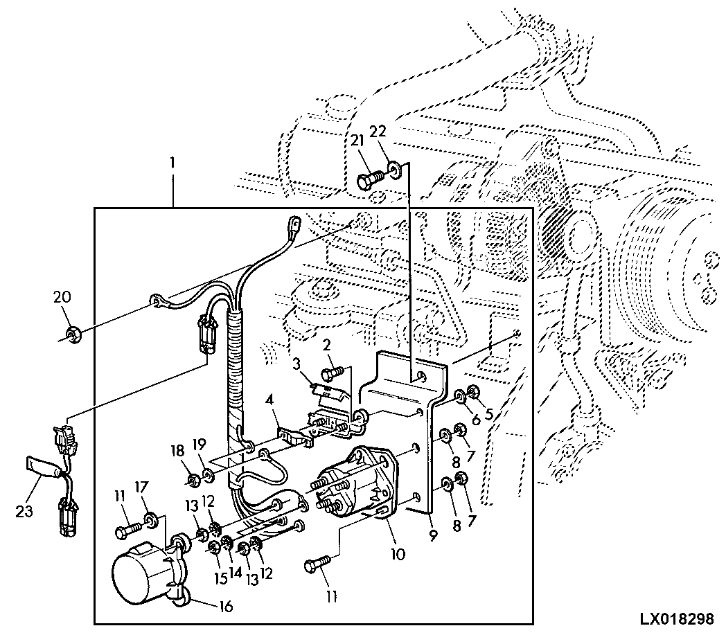

I am having a slightly different problem starting my 6410. All summer it starts great. As soon as the temperature drops to around freezing or below the key will not make the starter engage. If I heat it up to summer temps. with a herman nelson it will start. By hooking up a remoter starter to the wire going to the starter and the top connection post it will usually start. My mechanic is leaning toward replacing the starter with a remanufactured one. Anyone else experienced this? No fuses have ever blown. Thanks.
   / starting/electrical problem JD 6410 #15
Check to see if starter relay(parts key #10) is getting good electrical connections.
   / starting/electrical problem JD 6410 #16
Yes it is - we replaced this relay a week ago and that didn't solve the problem.
   / starting/electrical problem JD 6410 #17
We replaced the starter with a reconditioned unit and it completely solved the problem. The starter was hanging up and drawing too much for the system. It spins and starts now with no hesitation. Thanks for the suggestions!
