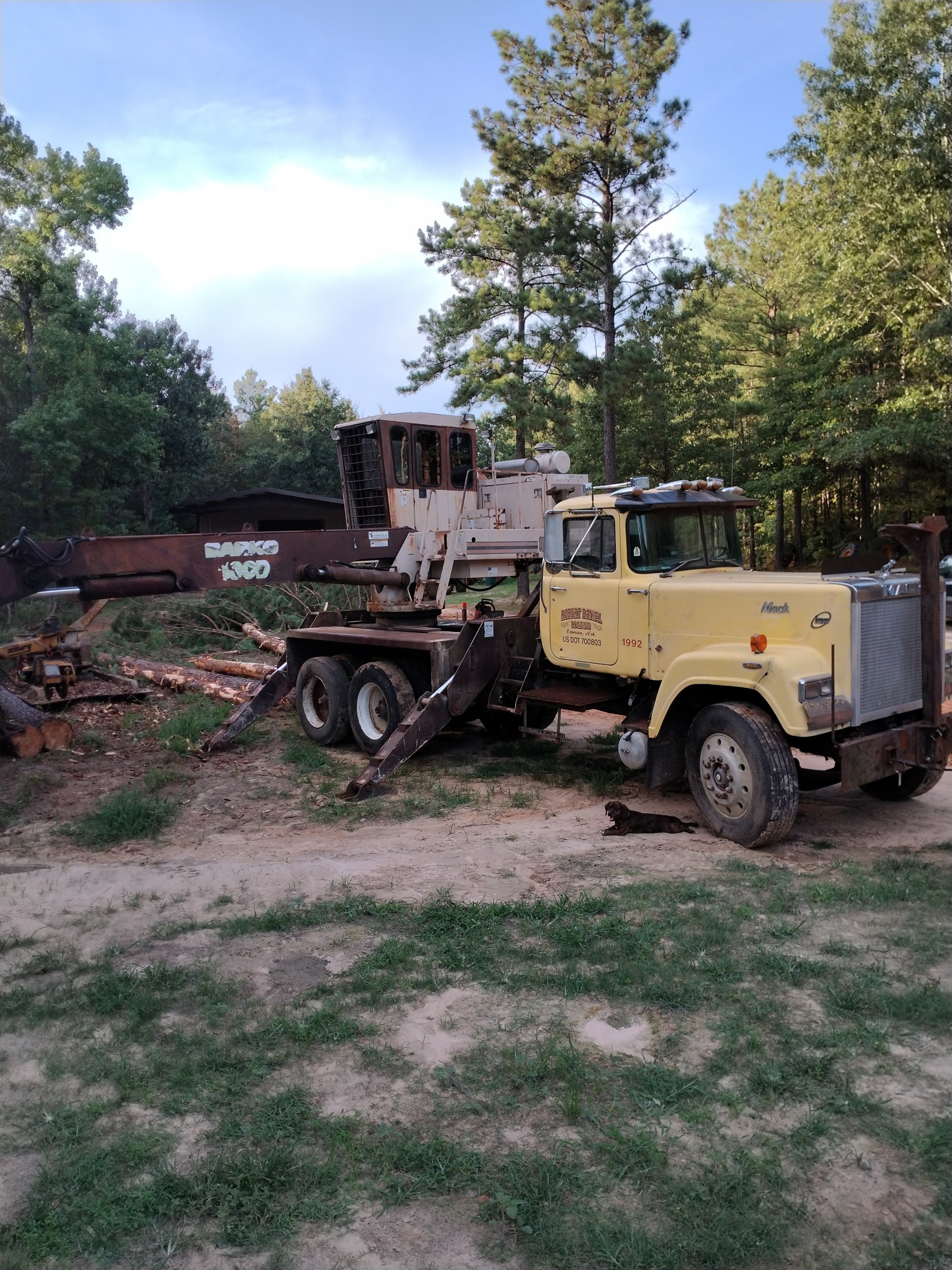

If you start using starting fluid you will always need starting fluid. I only use starting fluid on tires. And we have the diesel junk around here. Tractors, dirt equipment, logging equipment, none of it gets starting fluid. You have another problem. Starting fluid just gets around that problem while causing another one.
