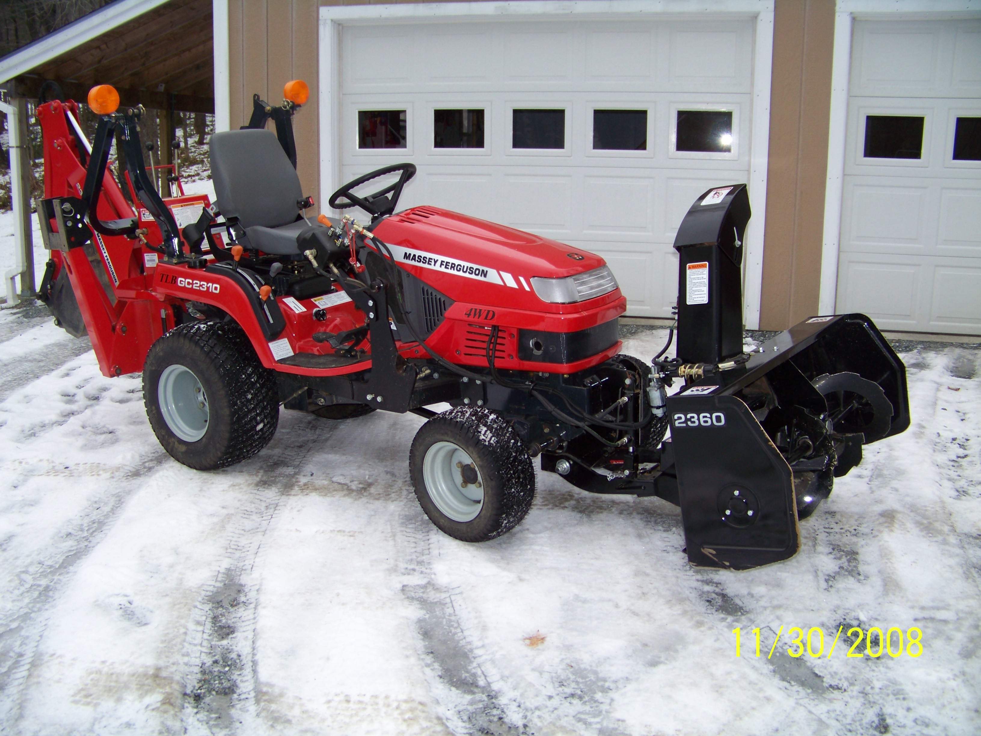

My tractor's in the "teensy" category, and though I'm still discovering other uses for it, I got it mainly for snow removal. My driveway's gravel, with a steep section, and although it tends to be a bit light on the front going uphill (I keep the backhoe on for traction), it does a great job. I just pack the first few storms down to have a firm base. Having the blower means no snow piles to remove later, no restrictions in visibility at the top of the hill, and only one pass to remove snow.
But, it sounds like those may be non-issues for you.... and a plow would certainly be easier on the budget!
Listen to the "old timers" on this forum- their advice is like money in the bank!
