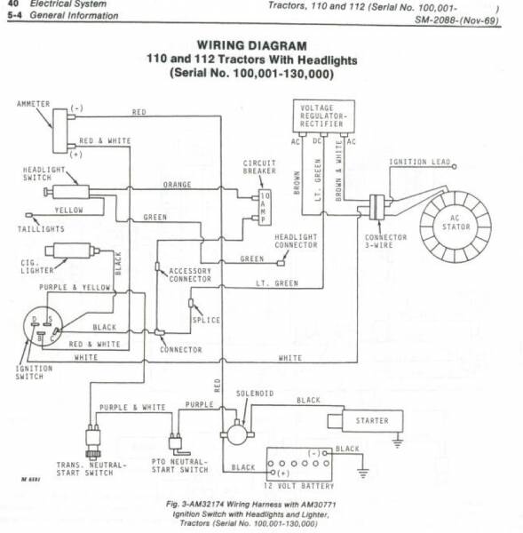

On starter switch you should have 12v on B (red/white wire) all the time. You should have 12v on S (purple/yellow wire) in start position. While in start position 12v goes through neutral safety AND pto switches to starter solenoid (purple wire).
That's all there is to it.
Follow along, test light or meter. Wherever you're missing power is problem, could be corrosion, bad connector, bad (open) wire.

Thanks everyone. It has got to be the pto switch which I ordered a couple days ago. I jumped from the solenoid to the ignition switch like Fuddy1952. I have power but it still will not start. At least this is an area I am more familiar with. Probably needs some carb work.

#15
You were right. It wasn稚 cranking and then I did the jump from the ignition switch to the solenoid you suggested and it finally started to crank over. I値l take a look at the manual. Thanks!
