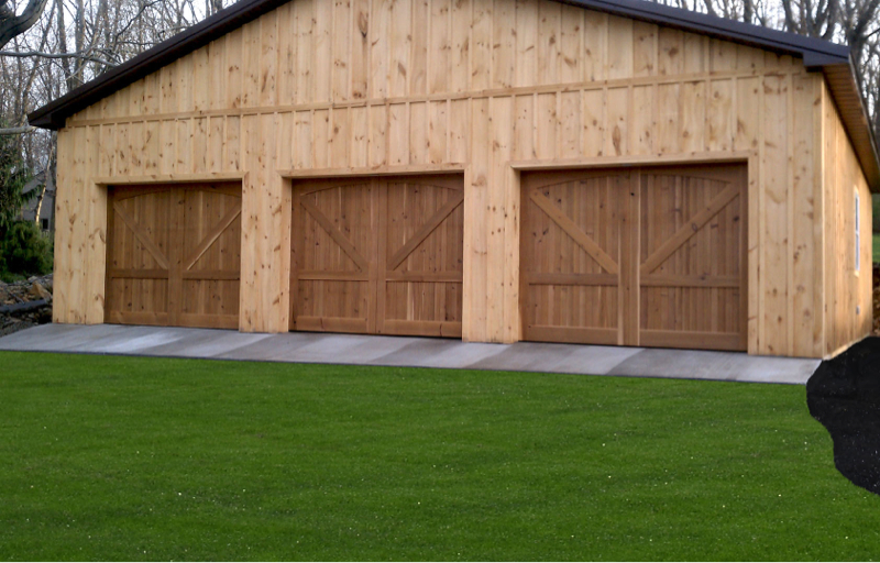

Thanks guys. Awesome info. The barn will be located in SE Ohio. I will use these doors too. I think i will go 12ft high to use a 16x10 door on each end of building.
Thats a nice looking building, the doors really look good.
A 12 in min overhang looks good and allows for sofit vents, when combined with a ridge vent, will help prevent condensation.
Dave
