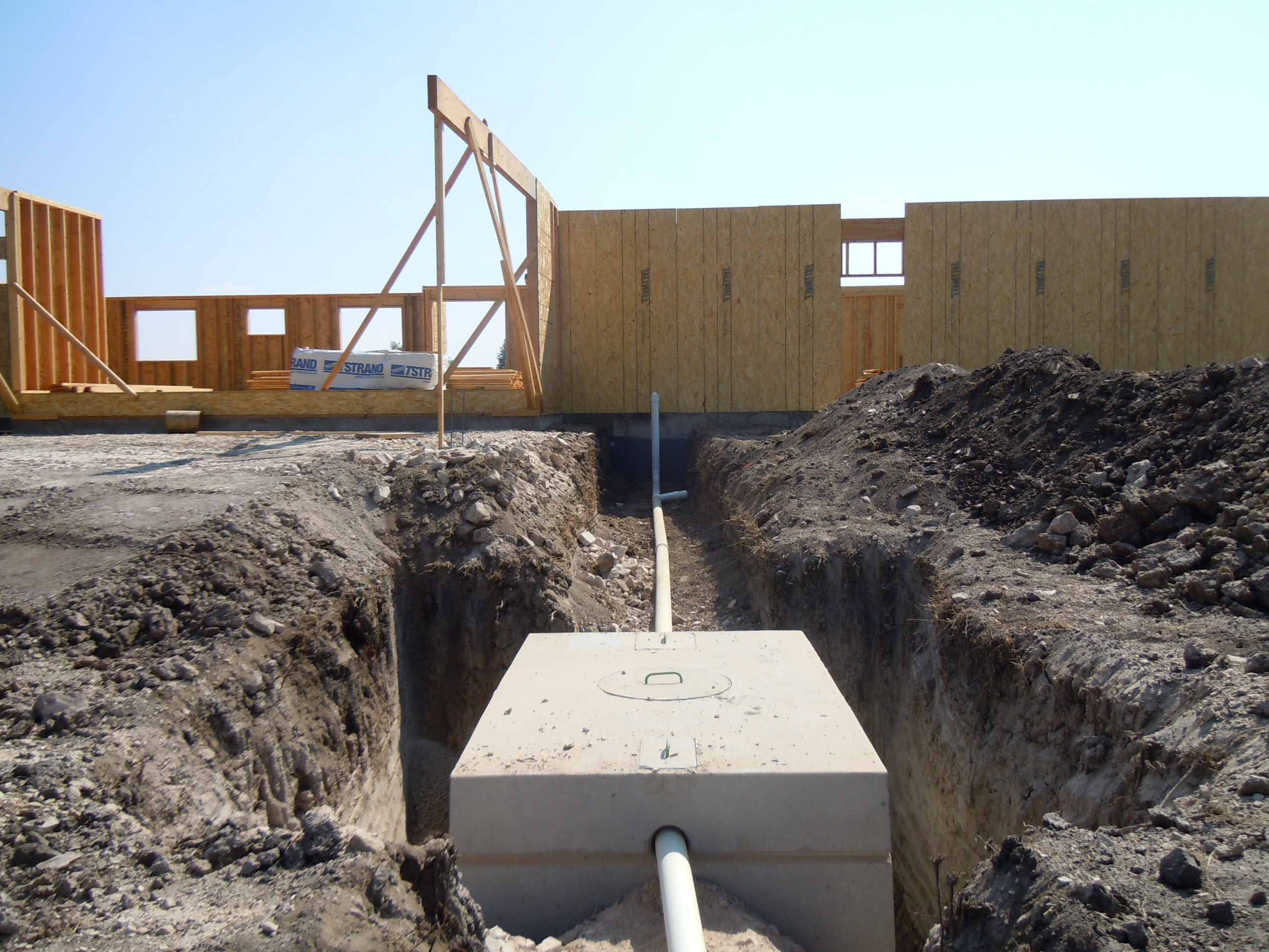

The Health inspector gave us 4 criteria to meet for the septic system to pass. The first one contradicted the last one but we followed his instruction to the tee except for the first criteria. Well, he failed it and said the whole leach system needed to be lowered 1 foot. It's total BS!!! I read his instruction to him and his reply was; "I agree it was confusing and poorly written, but I can't pass this off". So I get to do the leach field again. To be clear the sewer from the house and septic tank and the line to the distribution box are fine. Just the leach field needs to lower. Still a royal PITA.

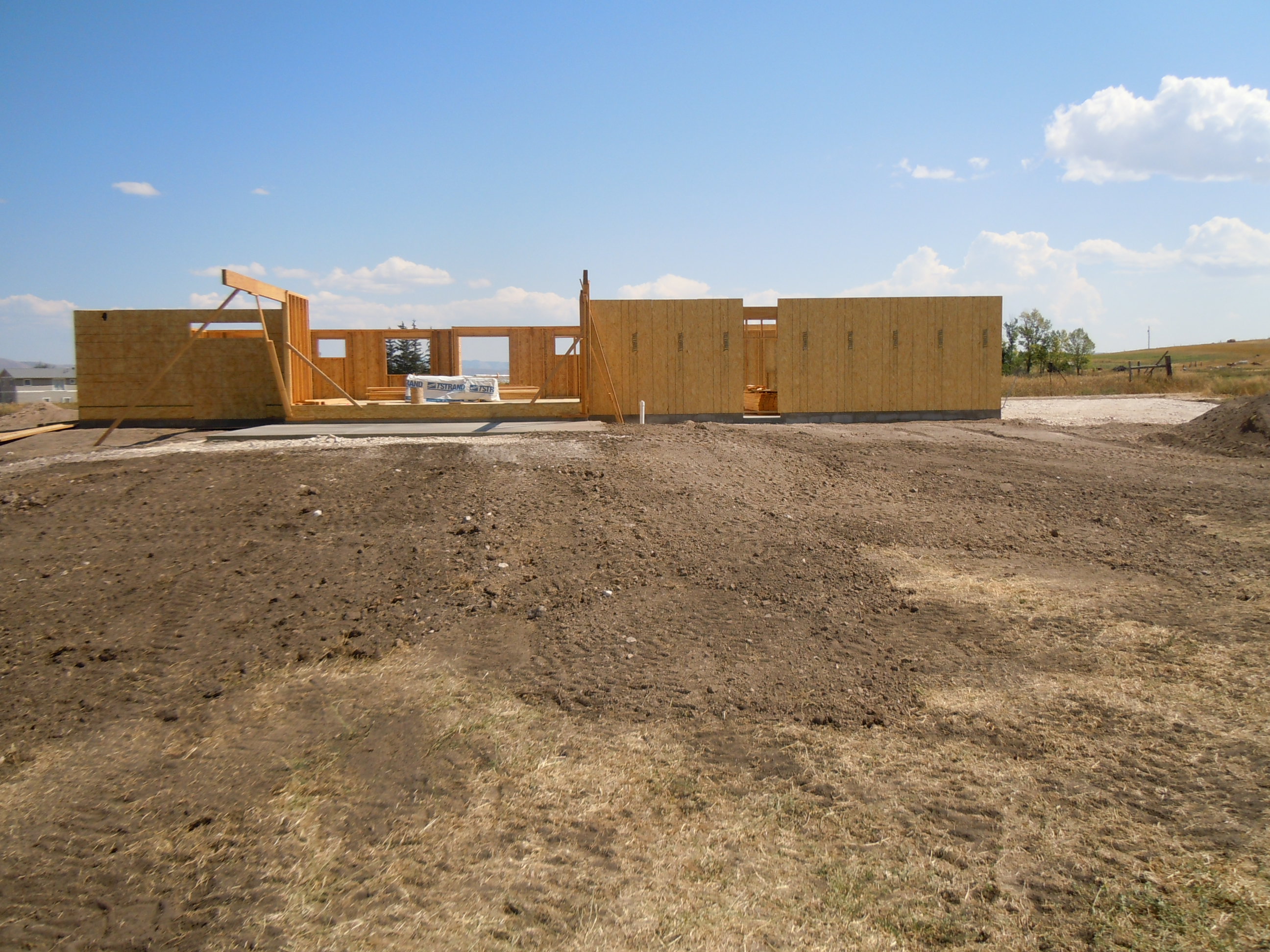

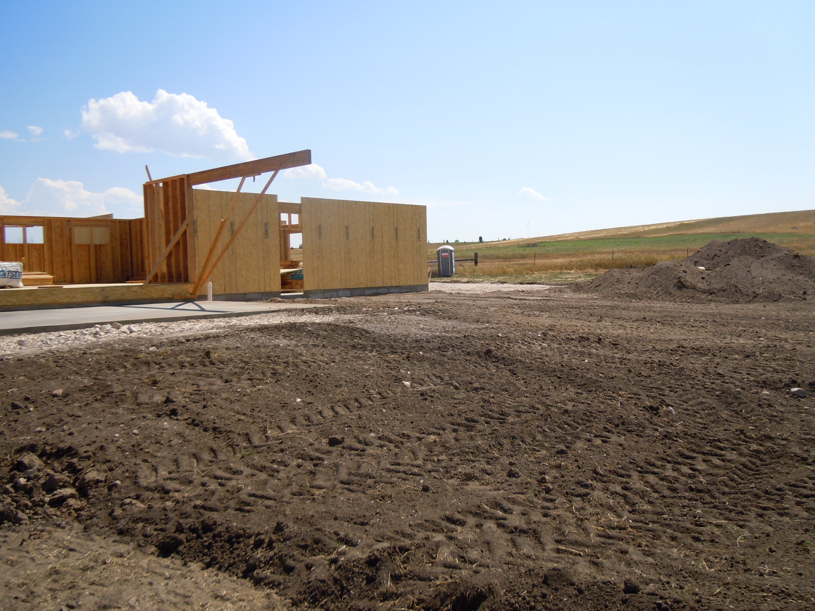

Here are a few pictures of the progress.

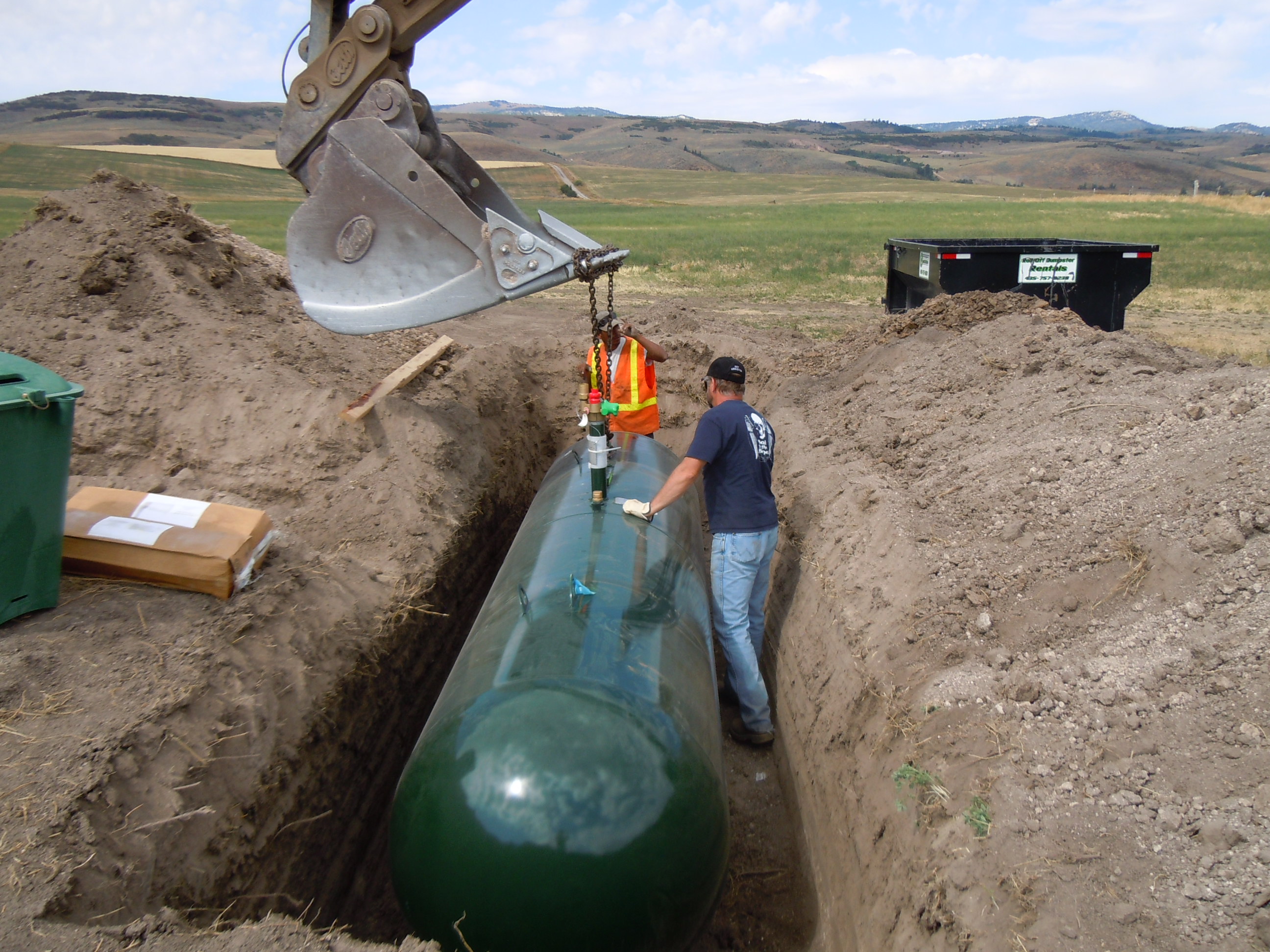

Propane tank.
Septic system.

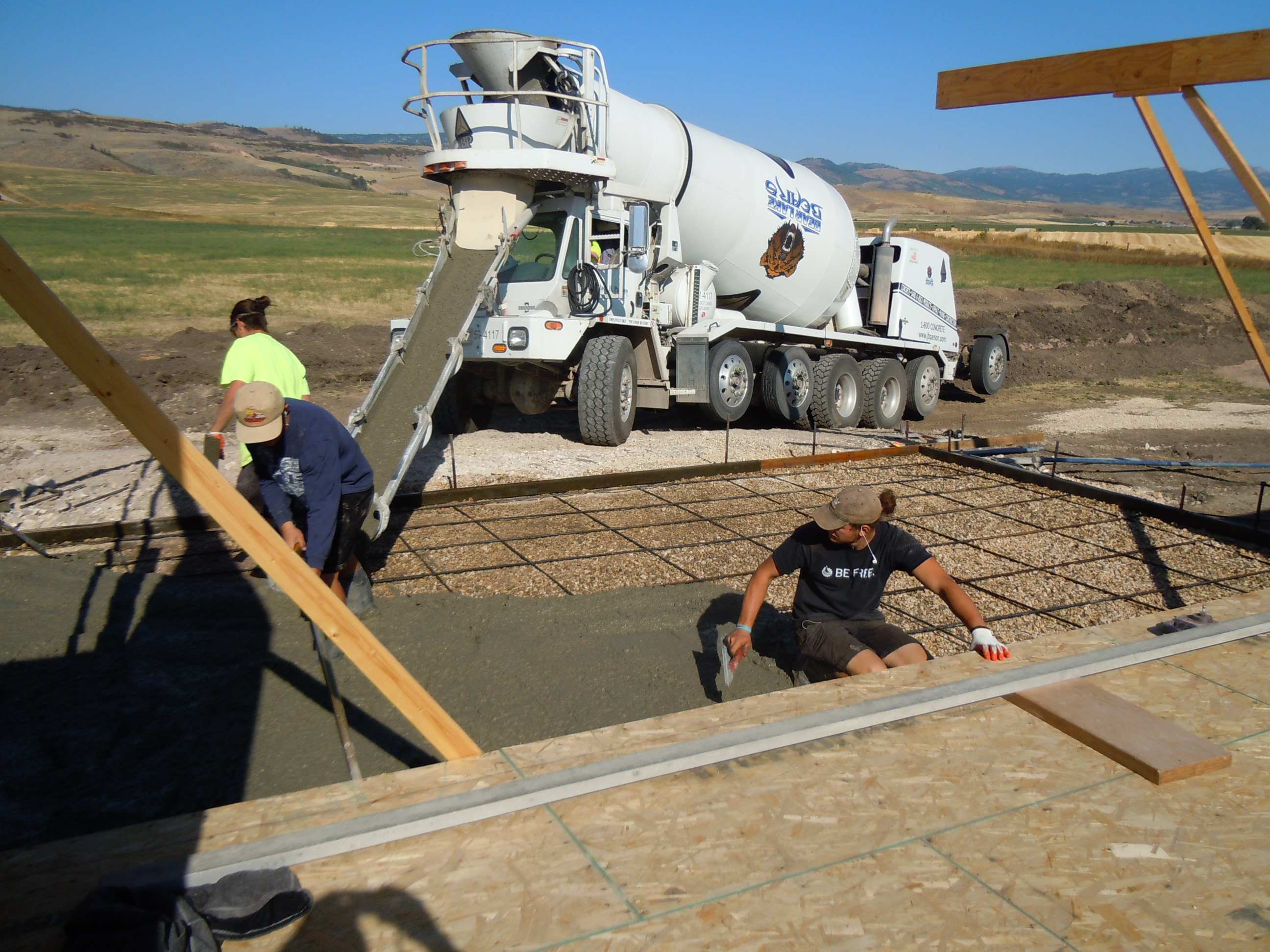

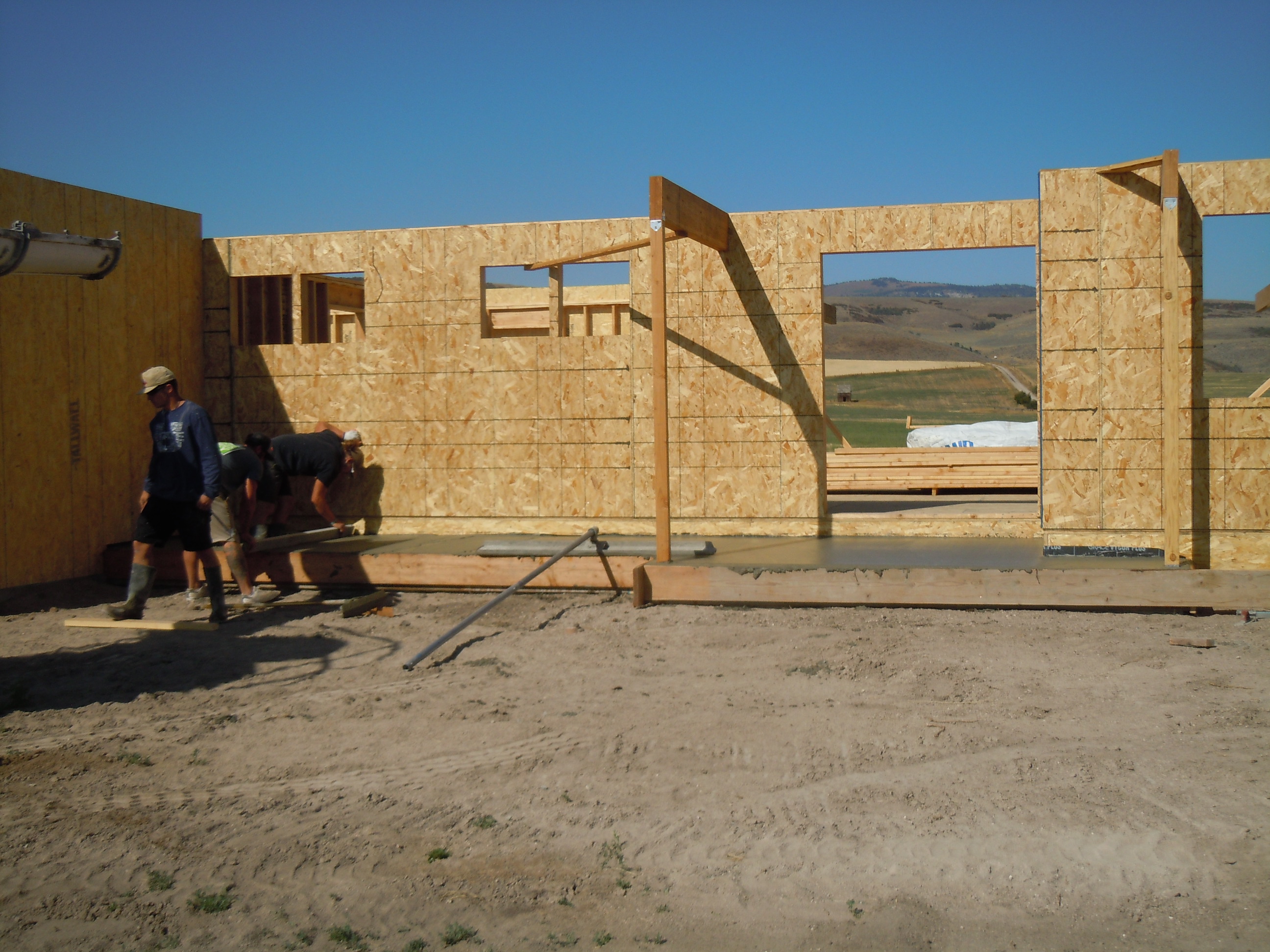

Cement work.

Yesterday's tractor time involved covering up the sewer line and septic tank since it passed. Don't want to give the inspector any more time to look at it and find something wrong.:laughing:

Hate hearing that about your inspector and having to redo the leach field. I would have thought that the contractor installing it would have known how to do it and if there was any questions, contacted the inspector for clarification before moving forward. Some inspectors can be very difficult, but in my experience, the more questions you ask of them, the more helpful they become.
Was this the same crew pouring your porch that did the rest of your concrete work? Why didn't they use chairs on the rebar? It's a shame that you paid for rebar, but it's just laying on the rock and not doing anything.

Eddie,
While I agree we should have called, here is why we didn't.
This is what he wrote.
1st criteria, excavate to 5' and backfill with 1' of ASTM C-33 sand then install the domes.
4th criteria, sand cannot be lower than 4' and the components of the system must be between 24"-48".
We put the system at 3' splitting what he wrote. So how do we dig to 5' and not put sand below 4'. That is why we dug it how we did.
However in hind site we should have called when there was a question about it. I would have been more involved but I was putting in the electrical conduit at the same time.
There was a guy pulling the rebar up as they poured, not the same as chairs but I did see him pulling it up.
