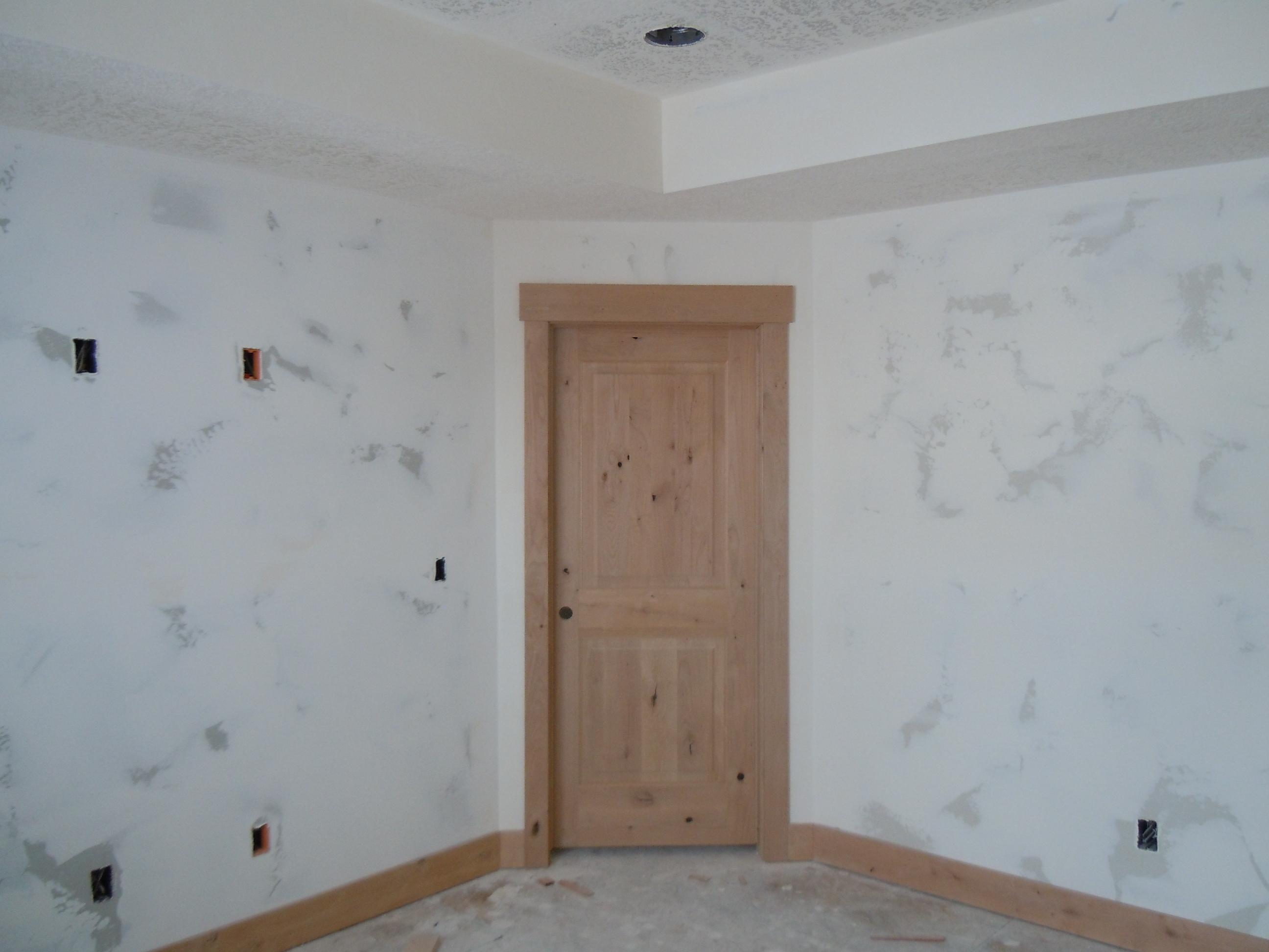

Update;
Finish wood work should be done today. Just a little longer than expected. The wood is Knotty Alder.

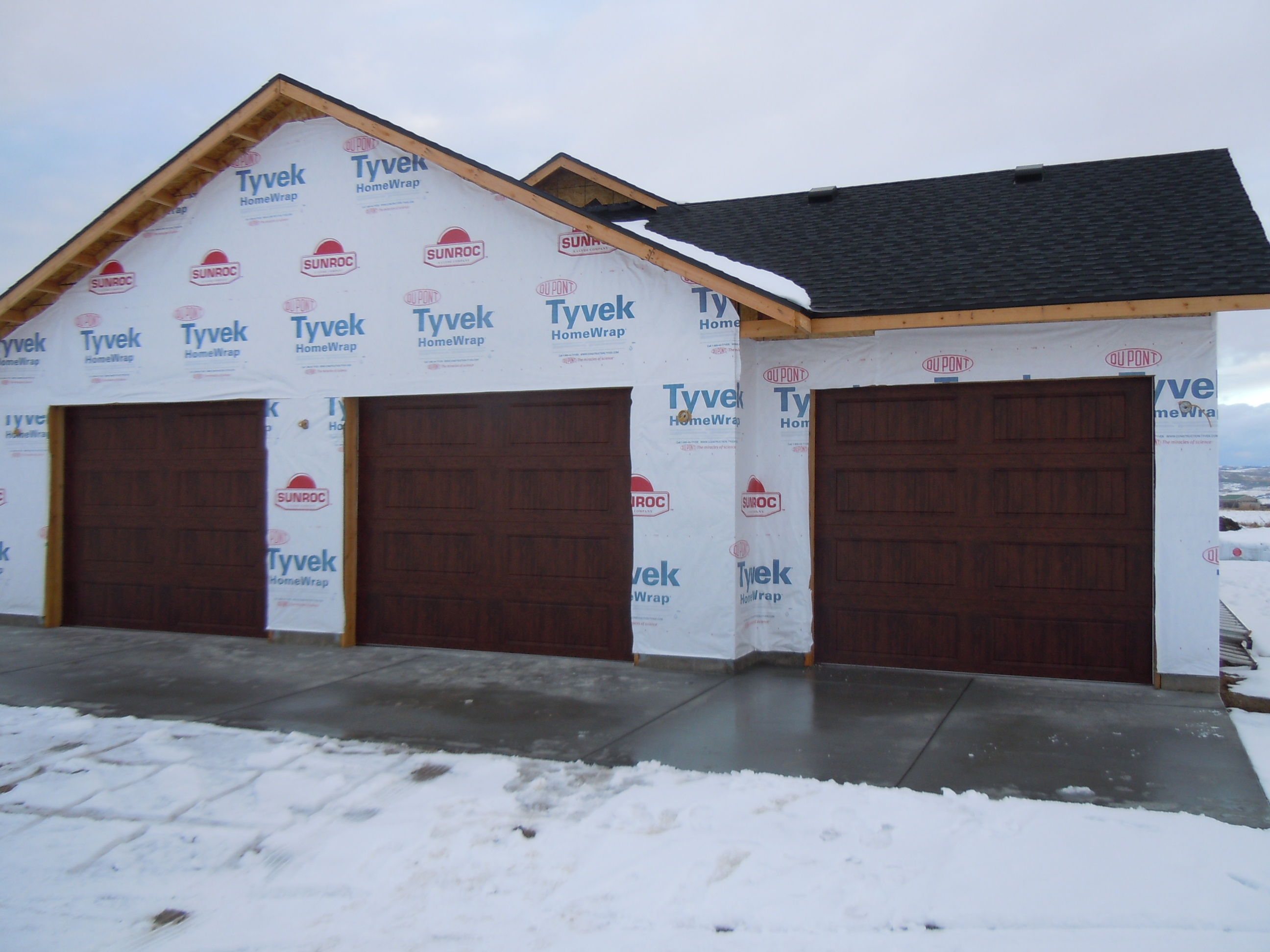

Garage doors and openers were installed yesterday.

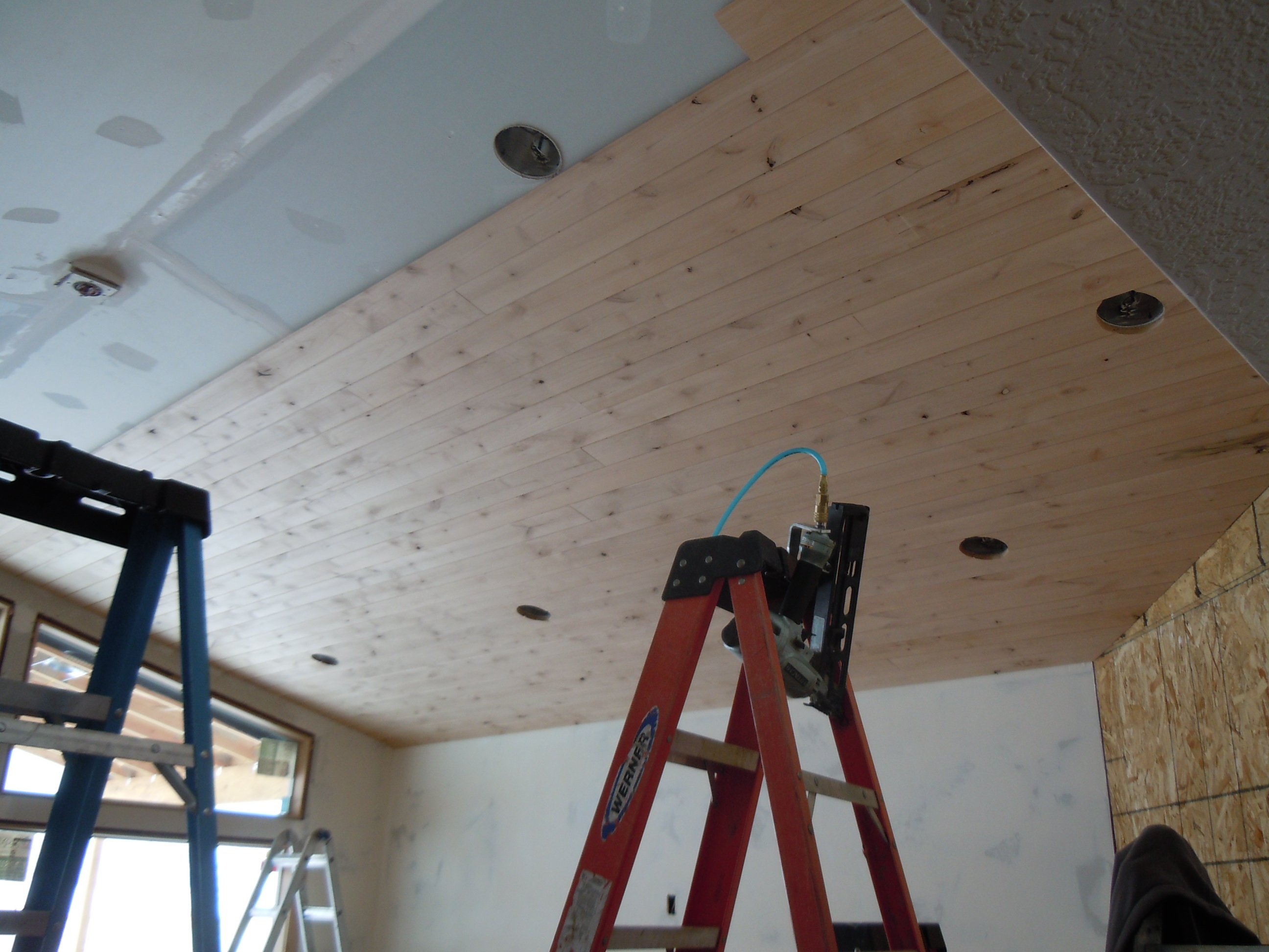

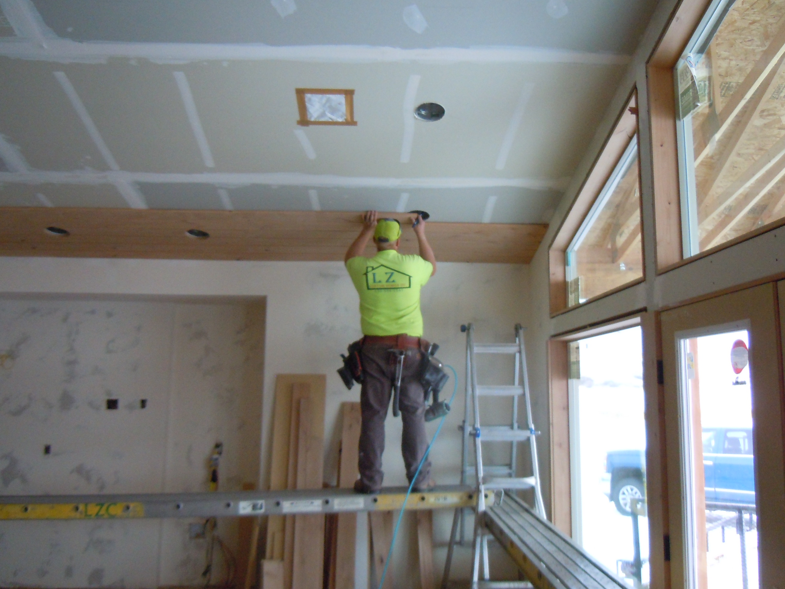

Is there an advantage to putting up sheetrock before the wood on the ceiling? I'm curious on why to spend the time and money to install the sheetrock first.
   / Starting our new life
#568
A few things;
More insulating value, less outside noise, waste less T&G wood, holds all the insulation where it belongs. (blown in the attic)
At least these are some of the things the builder and finish guys have told me.
   / Starting our new life #569
I had to do it for fire rating requirement in a two family home.

Mainly fire rating, I would assume.
