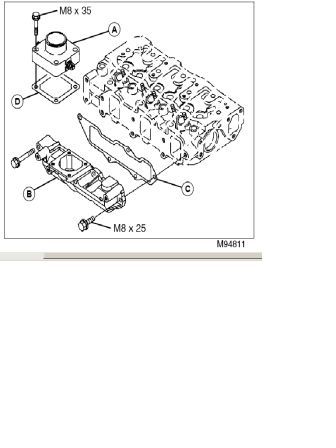

Indeed the 3005 may have glow plugs. The 3005 on-line parts catalog also shows glow plugs.
Fred, maybe you could look at pictorial display in the on-line parts catalog for the 790 and under the alphabetic index for heater to get an idea of how it looks, and then the 3005 glow plug pictorial. Then look at your 3005 engine and see if it has a rectangular box with an electrical connection above the intake manifold (air heater) or an electrical connection on the head near where the intake manifold is (glow plugs).
   / Starting procedure for 3005/790 #17
Here is a picture from my maintenance manual of the heater.

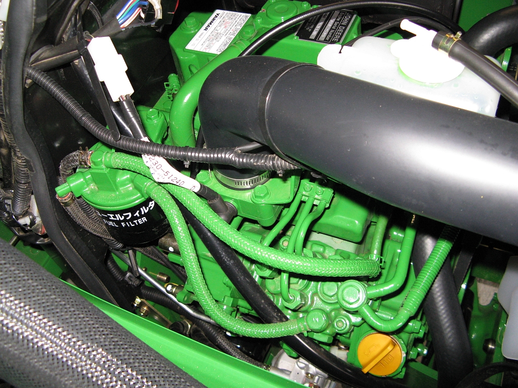

Here are some pictures of what the air heater looks like on the 790. The air heater is just below the rubber air intake hose. It has an electrical connection on it and also the coolant overflow tank is bolted to it.

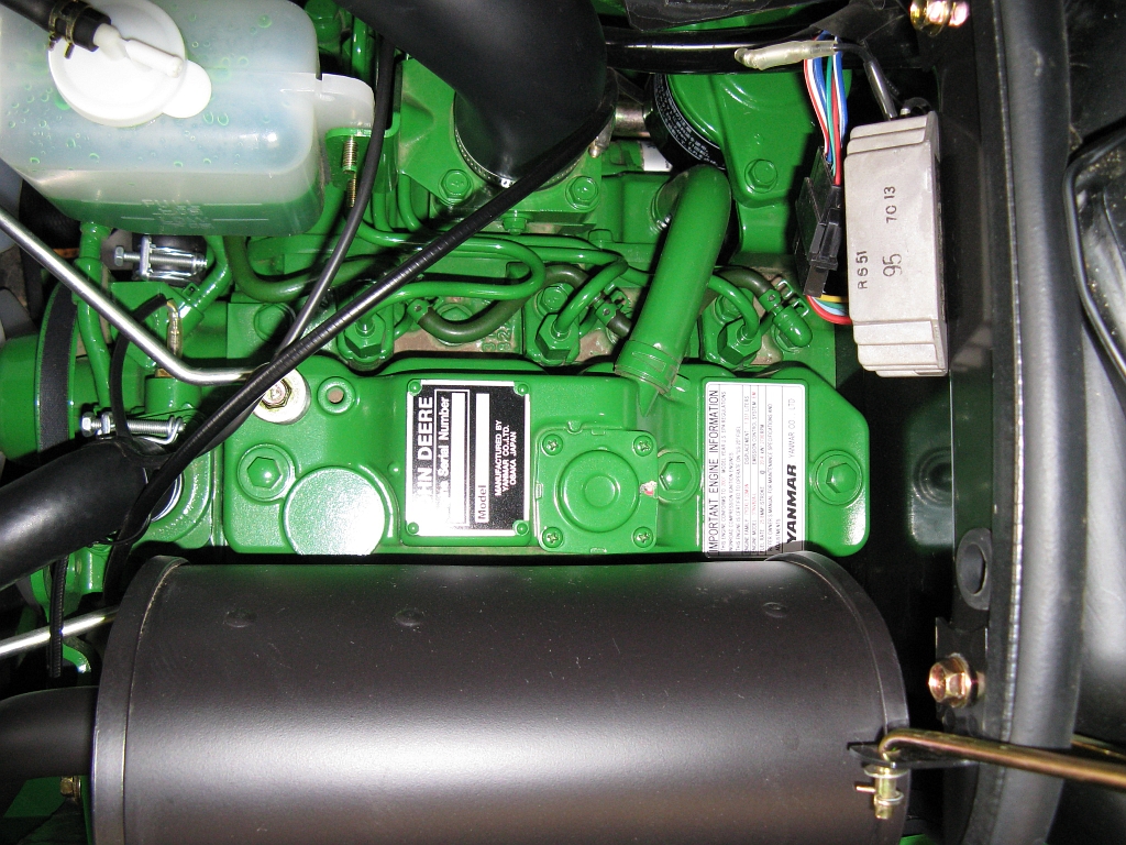

You might want to talk to a mechanic at your dealer. Glow plugs and a manifold heater are two different things. My 790 has an intake manifold heater. On my 790 you turn the key counter clockwise to activate the heater. If attached a picture that elalexander took of a 3005, thread "3005 replacing the 790" and it looks like it has an intake manifold heater just like my 790.
