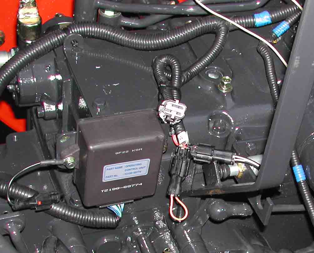

Yeah, the interlocks on the CT230 are quite annoying, and MUCH
different from those on my CK30, which is the same machine. The first
thing I did was to jumper the seat switch.
This photo shows the interlock control logic box, under the seat on the
left. The system allows you to run the tractor without being in the seat
(brake has to be on).
