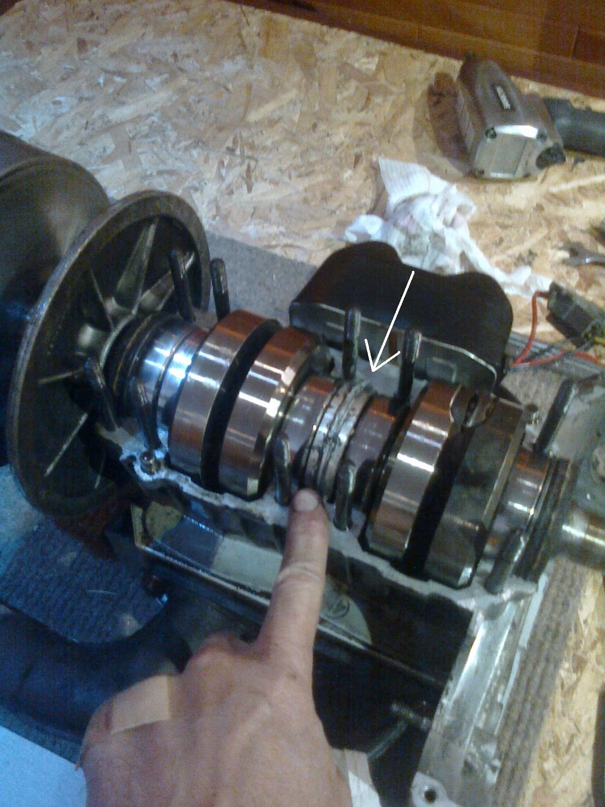

All correct and these engines have a center seal also. When it goes, and these engines are known for it, the base cannot pressurize correctly causing
Issues with intake and exhaust. Symptoms are hard starting and poor running to not running at all.
   / Starting snowmobile engine in gocart #26
"Center seal"? I have a good bit of experience with many different makes of 2-cycle engines, but your terminology is confusing me. I can only imagine how FarmBoy feels. Exactly what are you talking about? The seal between two halves of the crankcase? The seal between the crankcase and the reed valve housing/intake manifold?
I agree that problems with these would cause the symptoms described, but IMHO, not too likely to have spontaneously failed due to just extended layup.
   / Starting snowmobile engine in gocart #27
On multi-cyl two strokes there are crankshaft seals between the cylinders that if bad will deny the cyl either side of them a proper intake cycle. (they'll run lean, and twins often won't start) My first such repair was on a Suzi 550 triple some 40 yrs ago. Easy to diagnose since one cyl ran fine while two didn't. Center cyl and the one side smoked a lot, but it was ridden to my 'shop'.
Using starting fluid (ether, etc) can cause catastrophic damage to two cycle engines (ask a snowmobile shop mech). If a backfire belches into the crankcase it can easily cost you a seal or two, and that's the milder version of why many won't use it a second time. ;) (+1 on the propane test for intake leaks)

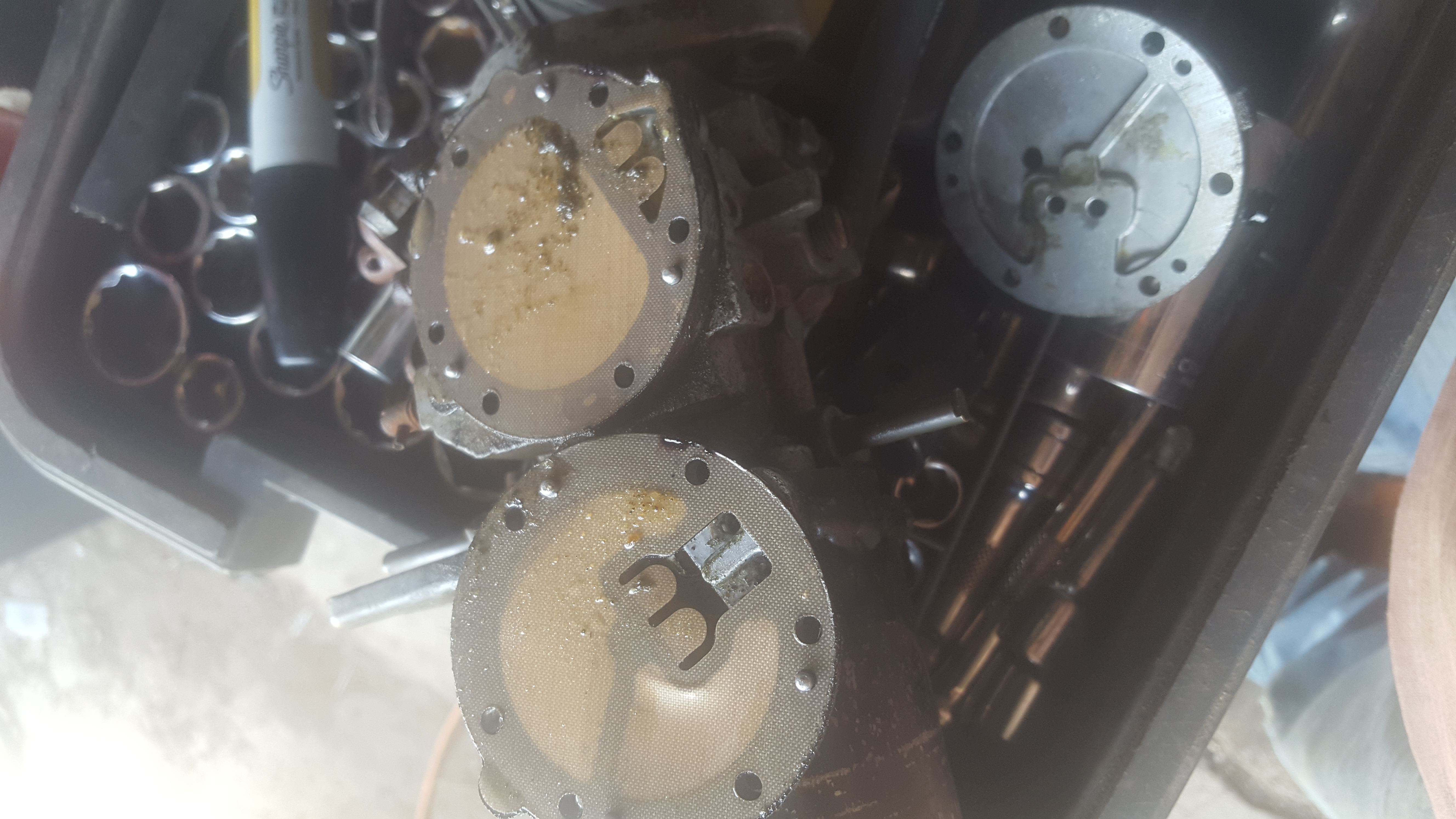

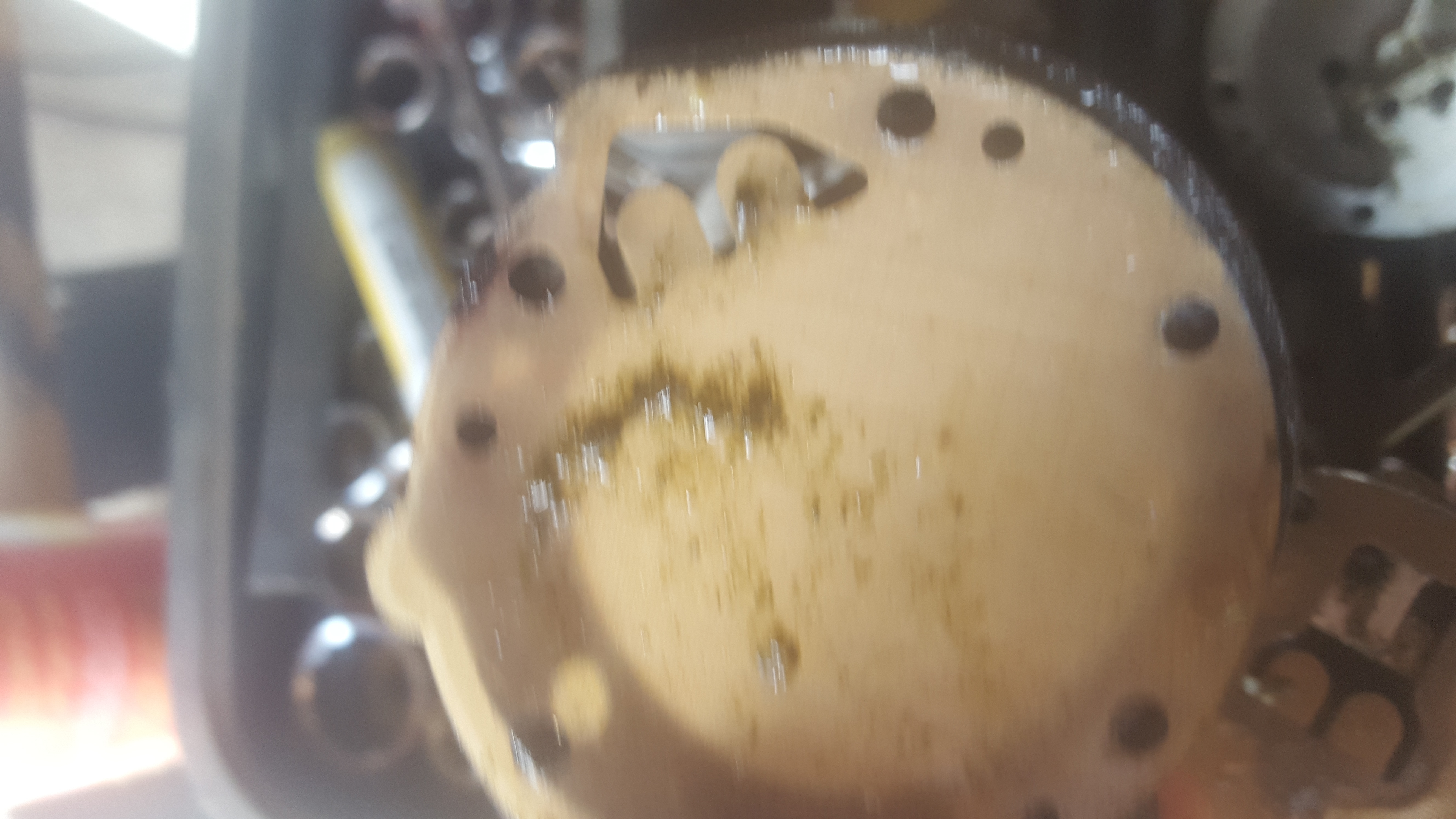

With a carb that bad I'd vet the possibilities there thoroughly before tearing down the CC, in case that's all you have to fix. If experienced with cleaning the type, you'd know once you got it right. Diaphragm damage is easier to acquire than to detect. All analyses are easier once running, even if barely.

211881d1328454879-2-piece-center-seal-installation-72-kaw-440-center-seal.jpg center crankshaft seal
Yes clean the carb first.
   / Starting snowmobile engine in gocart #29
I've been educated. Didn't consider (and don't have much experience with) multi-cylinder 2-cycles.

That carb is junk. Don't even bother trying to make it work. Get a different one like a Mikuni.
