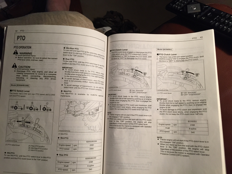

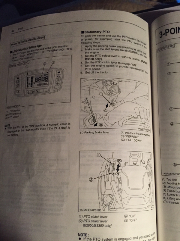

There is a PTO clutch. In the manual it says to engage it slowly at half of full speed engine rpm. This is sort of what I do. Then bring it up to speed. There is also an rpm selection switch on the dash where you can see the actual rpm of the rear or mid PTOs. Here are the two pages in the manual that discuss PTO operation. The manual states the PTO will disengage when you stand up from the seat. For stationary use such as using a chipper, you do need to engage the parking brake or the PTO will go off. I had that happen a couple times when I was on flat ground and didn't realize the parking brake was not engaged

Sorry, I was referring to a main clutch, with foot pedal, which would completely de-couple the PTO (and transmission) from the engine. The older B models with live PTO had both the main foot clutch, and the PTO engagement lever. So you could depress the main clutch with foot and let implement RPMs come back down at their own pace while independently throttling the engine back to idle. In that system (live PTO), the PTO engagement lever (which is in the same place as your PTO clutch lever) was a mechanical (gear) engagement.
So with an independent PTO and separate PTO clutch on the new '50 models, I suppose you could do the same thing, sort of -- just pop the lever to disengage the PTO, and that should let the implement spin down at its own pace while you independently throttle the engine back. For the reasons stated above, I wouldn't drop the throttle from full speed with the implement spinning without first disengaging the clutch, but it would be good to see if the owner's manual has guidance on that (didn't see it in the photos).
