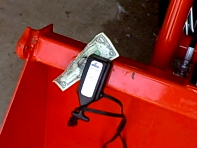

I keep my Kubota in an unheated garage. If the outside temperature is 20 F or lower,'
I use my magnetic block heater. The beauty of a magnetic block heater is that is
easier to use and isn't permanent. You can use it on any tractor.
