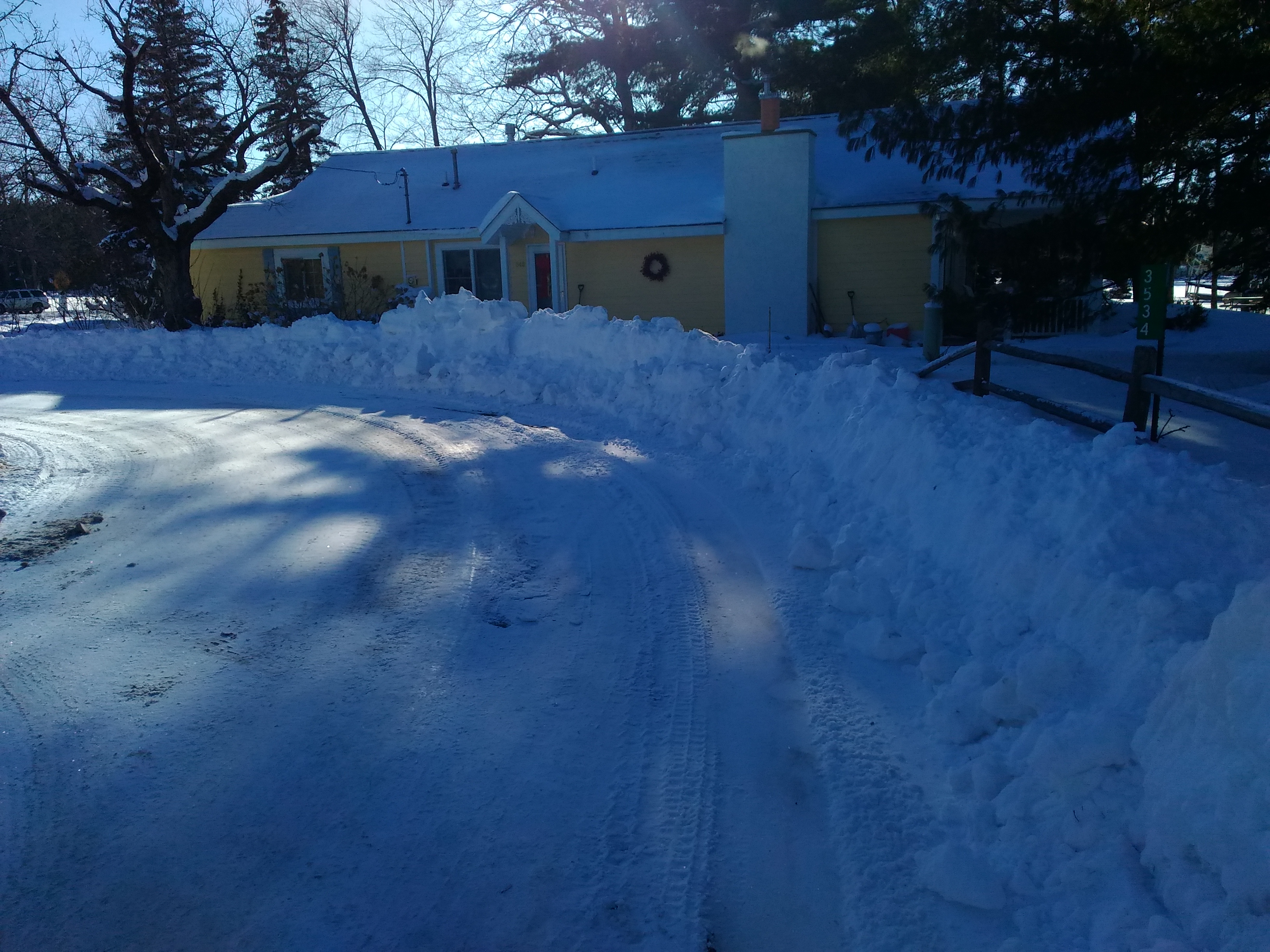

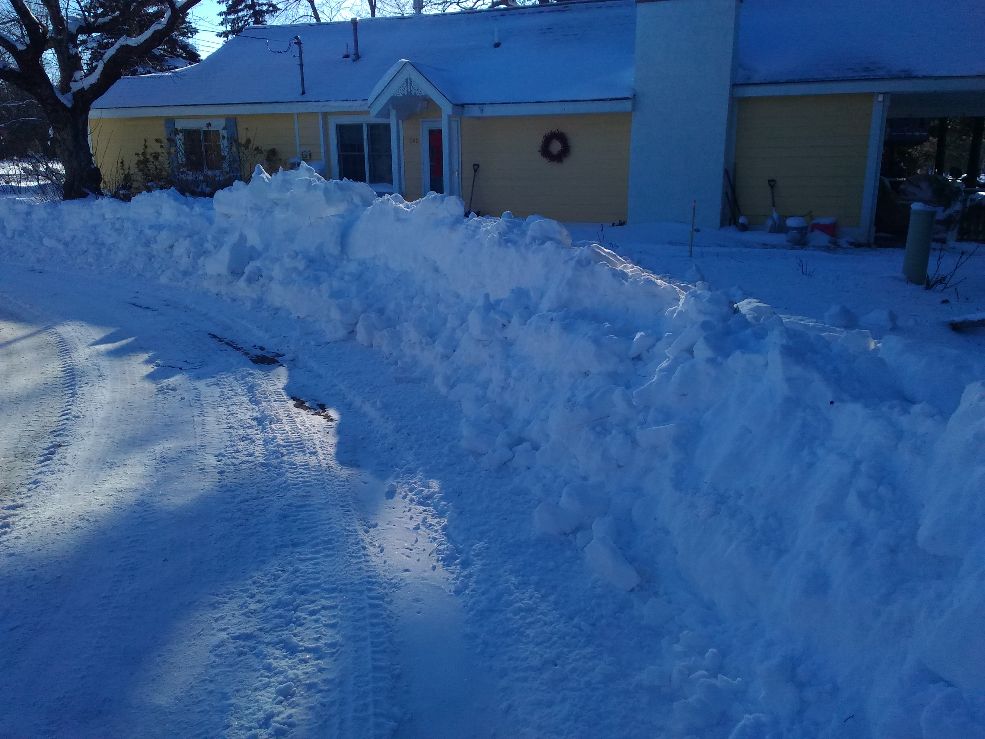

Had my BX2230 plugged in a hour north of you for about 2 hrs. -10F when plugged in, about -8F when started. Bit of glow plug and she fired. Ran rough, idled up and left it for 10-15 min and off and blowing snow. Just plugged it in again, (-6F)and will try starting in a 1/2 hour to an hour. Need to open up a parking area for a neighbor coming up to his cottage. Was -18F this morning at 9am. Jon
   / Starting Your Kubota in Cold Weather #58
Jon
   / Starting Your Kubota in Cold Weather #59
   / Starting Your Kubota in Cold Weather #60
Is that cleared area a road, or a driveway?
Looks like you'll have to clear a path to the front door too...
You probably already know this, but raise your blower and take relatively small bites...you'll get through, eventually.
Actually I will start at the neighbor's mailbox, to the left of the pictures(maybe not in pictures), and clear about 2/3 the length of the house. Mostly moving the pile. At the tree is his septic tank, so I have to keep that covered. That pile/berm is the plowed mess from the county going around the turn around. Usually further away from yellow house, but not this year. Will actually touch the pile with the back blade in areas to make sure it is broken up, then turn around and chew with the blower. And keep moving in a little bit at a time. If that doesn't work, I'll drop the blower and go get the BX's loader and use the bucket. Jon
