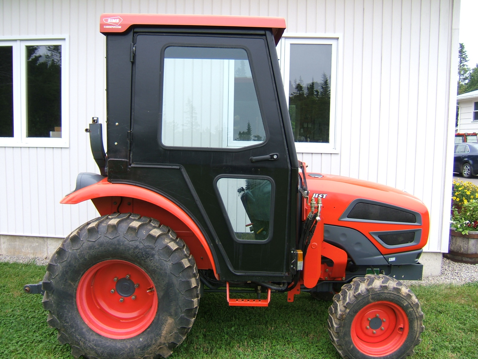

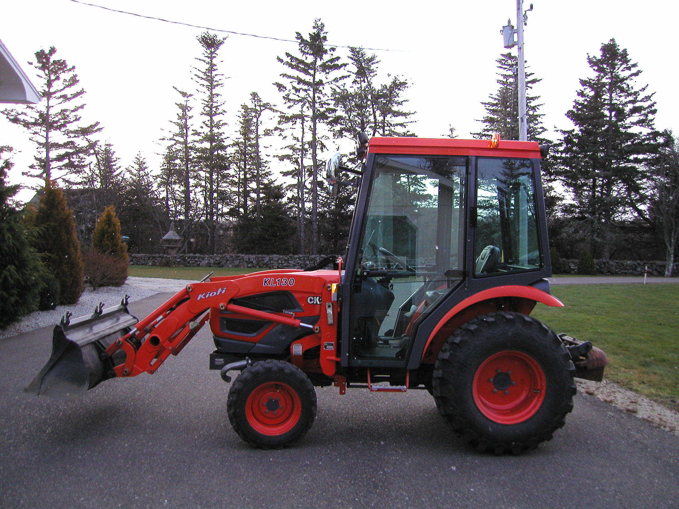

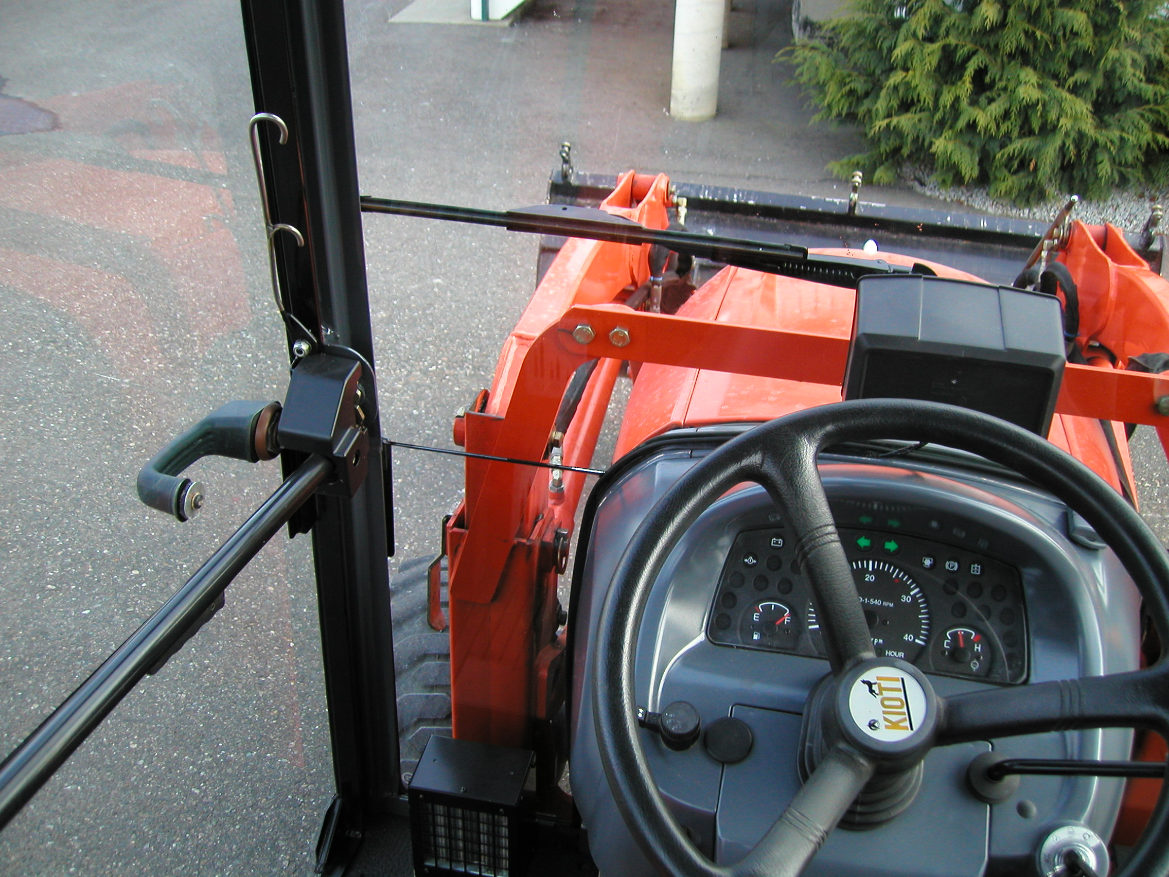

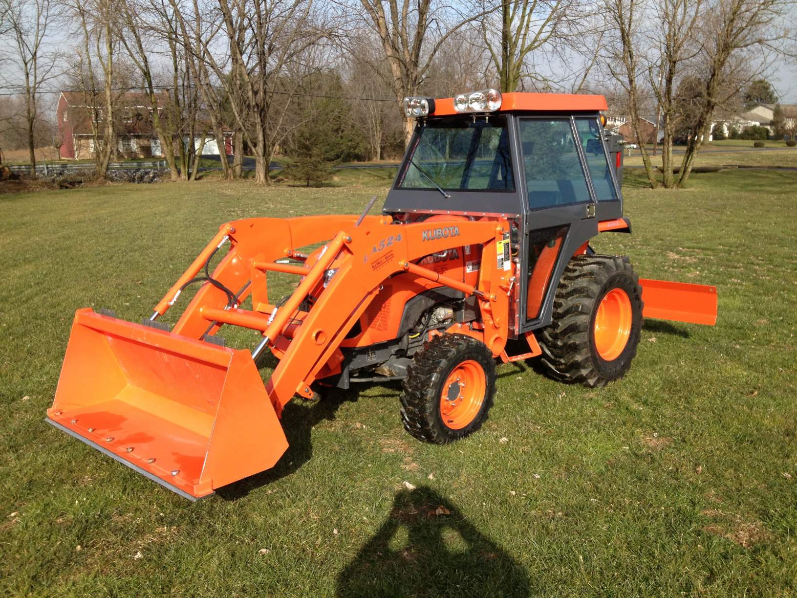

I previously owned a Kubota B1700HST with a soft side Sims cab. I did not install it myself, it was already on when I purchased the tractor. I though it was OK at least much better than no cab.
Last year I upgraded to a Kioti CK25HST and it also had a Sims cab already installed. I was totally disappointed in this cab. The doors did not fit or close properly, the cab was floor mounted and the whole cab would jump around violently and almost take the floor off with it in the process plus I could not see anything around me due to the sheet metal panel design and small rubber mounted windows. I saved the door latches, heater, roof panel and one wiper motor and started from scratch to build a whole new cab. This one is rubber mounted to solid parts of the tractor, does not move at all during operation of the tractor and I can see what am doing. Best of all the doors fit and no water enters the cab.
The Sims cab is the black one.
I know building a cab is not for everyone but its not hard to improve on the Sims cab but then again it's not easy for a manufacturer to make a good cab for just a couple thousand bucks. That's why the good one cost $7,000.00.
