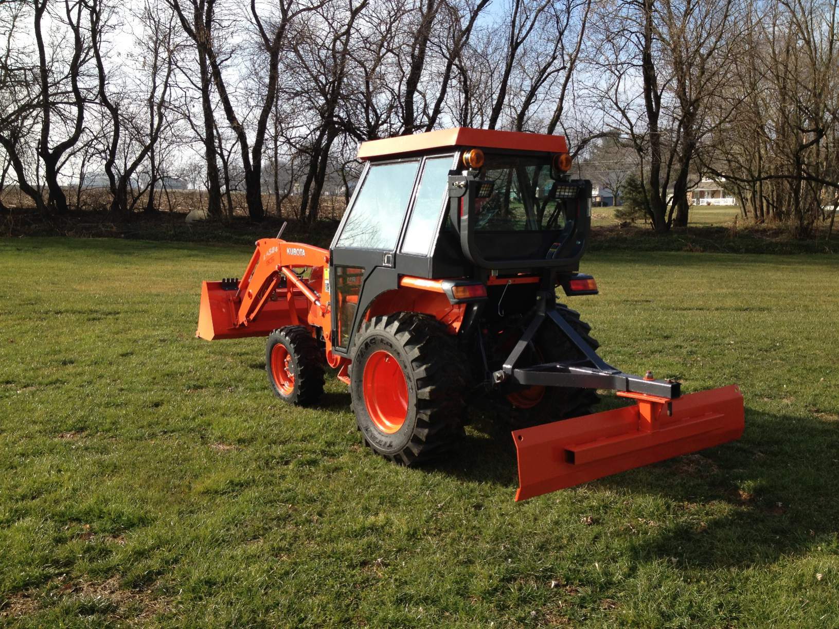

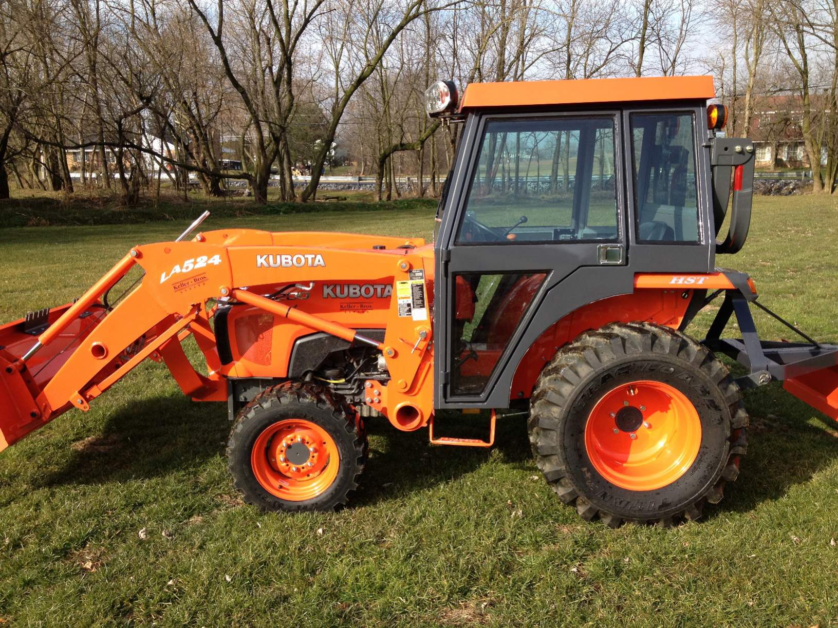

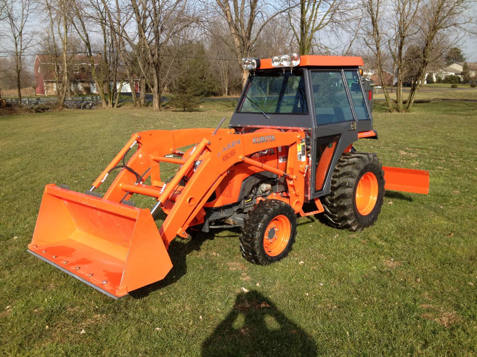

Building my cab was a very rewarding project. Big snows here are hit or miss, but after spending the previous 23 winters on an open tractor, it was well worth the $1,200 or so in material and 150+ hours of time. It's tight, has real glass and a heater capable of keeping it warm enough to plow while wearing a T-shirt. It is built in pieces, so it came off in about an hour last spring. Since I made some lighting and wiring mods it took the best part of a Saturday to reinstall this fall. Here are a few pics from last year when it was first completed. I have since changed the work lights to 2 forward and 2 rear LED floods. The one thing I overlooked was sound isolation and there's a fairly simple plan for that in the future.

Have you got any pictures showing the costruction? I'm undecided whether to go with square tubing or angle, ....and what to cover it with? Might start with a simple windshield and exhaust re-route. Did you rubber mount it? Insulation? What's the inside look like?

rScotty, here's the thread from last year:
http://www.tractorbynet.com/forums/build-yourself/263920-diy-cab-finally-decided-time.html
It is bolted right to the tractor. Some day I may get around to isolating it. You can see details in the thread above. In short, it's separate panels made of 1x1 square tube and the doors are 3/4x3/4 square tube. Some Armaflex sheet is glued in but there's so much glass it likely does nothing. Heater doen't care one bit. It is usually too hot with the fan on low speed. What I really need to do is let some of the water run through the bypass after initial warmup. Any questions are welcome.

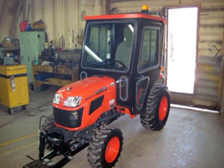

I for one highly recommend SIMS cabs.
I have owned one since 2008 with ZERO issues.
My b2920 was used to design the cab for the b2320-b2920.
Is it as nice as a factory cab; no
Is it functional keeping you out of the elements and WARM; yes
Is it less expensive than the factory option; MUCH CHEAPER
Could the assembly instructions be clearer; YES
Having said that my wife assembled most of it (after the main supports and roof assembled) as I got called to out to work.
I guess if you can't change engine oil in your vehicle then you probably WILL have issues assembling this kit.
Here is the b2920 with SIMS cab
