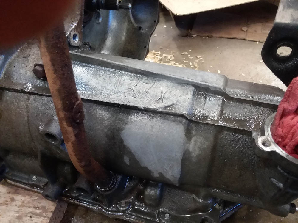

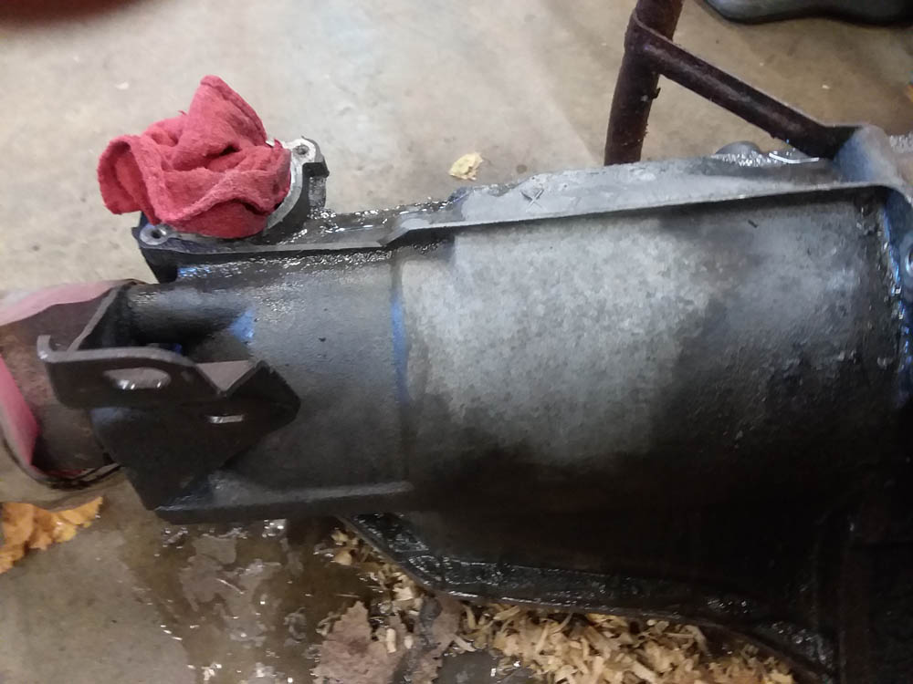

I just bought a Harbor Freight steam cleaner. I have some non-shop uses for it and a 15% off coupon, so for less than $100 I thought I would give it a try. Here are a couple of pictures of a transmission from a 1988 car that had never been out before. I tried spray on degreaser and it had little effect. The cleaned spots are the result of about 10 minutes work and 2 cups of distilled water.
