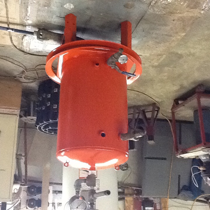

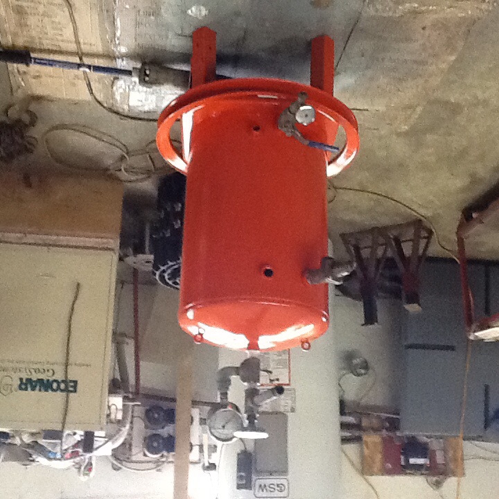

The two reasons I picked a hot water tank to use is because I had a new one I wasn't using and it already has five outlets on it so no need to weld on any fittings plus it is hydroed to 150psi I guess that's three
/ Steam jenny #16

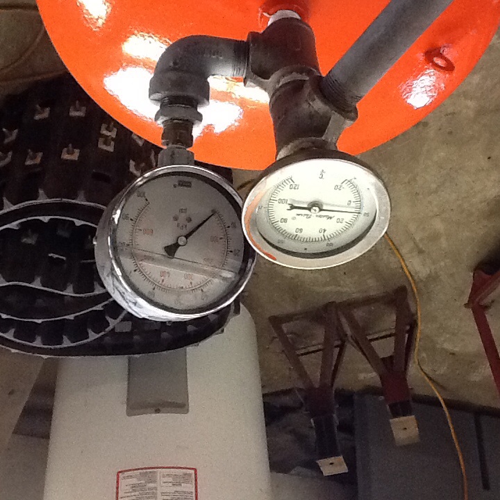

however this will be lo pressure psi the safety valve is set for 30 psi and the vessel itself has been hydro static pressure tested to 150psi so I am not too worried about a explosion, that being said **** can happen so it will be watched very closely, I may even hook the torch to a aquastat and set it for 220 f.

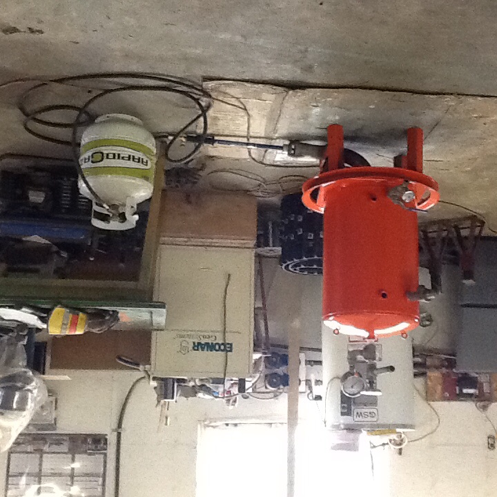

I will try to post some pics in the next couple of days, to show progress and maybe get some feedback
Here are the pics I promised
