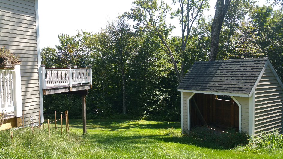

So here's a picture of what I have now. The wife has never liked the woodshed. I've seen much worse looking ones but since we both want a gazebo I thought I could move the shed and put it there. My plan is to have a bridge from the corner of the deck to the gazebo and also a set of stairs coming down towards where I took this picture from. The idea is to use the space under the gazebo to store firewood wrapped with lattice to hide the wood but allow plenty of air flow. The firewood would already be seasoned, no green would be stored under it. The shed is 12' wide and 8' deep and the opening is about 7' high.
I found a picture on the net that may give a better idea of what I'm looking to do. When I get a chance I'll use one of the on-line deck designers and do a layout. If possible I would like the floor of the deck to be at the same height as the gazebo floor, one step up would be acceptable. Because I would like to store wood under it I would like at least 6' between the floor for the firewood (this could just be wood simply laid on the ground and the bottom of the joists. A center post isn't out of the question but I figured I would see just what size channel was needed without a center post first. Also the location of the outside posts doesn't have to be exactly at the edge. But the posts will be carrying the load of the gazebo's walls and roof so they should be close, say within a foot. Otherwise I think it would be adding even more calculations to the load mix. Part of the reason I like the idea is because it's complicated. I knew figuring out would be more work but that just makes it more rewarding when you look at it. Anyone can do simple.

Those pictures help explain why you want what you do. I think it will look really nice. If that's all the bottom will be used for I wouldn't worry about the underneath and use the double layer to frame the floor and a center post.
With the bridge out to it you won't have to worry about access.

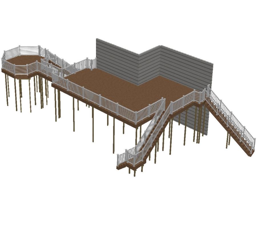

Right now I'm just in the coming up with a plan on how I want to build it. Nothing is set. Since it's basically free standing I want the posts to be steel. Two of the 3 6x6 pressure treated posts are warped on my deck. It's tied to the house and a cement footing so it's not structurally a problem but doesn't look as nice as it could. Everything from the gazebo floor up will be wood with the pressure treated 4x4 posts having a vinyl cover like I did on the deck. I've also debating using 7" c channel with a pt 2x4 laying flat on top of it around the outside edge and 2x10 for joists and blocking as needed for the decking boards. I like the idea of making the octagon out of steel because I can lay it out exactly on my shop floor and weld it up and then place it on top of the posts.
Here's a basic layout of what it will look like. It's not exact and and it just show an octagon deck, not a gazebo but it at least gives an idea.
