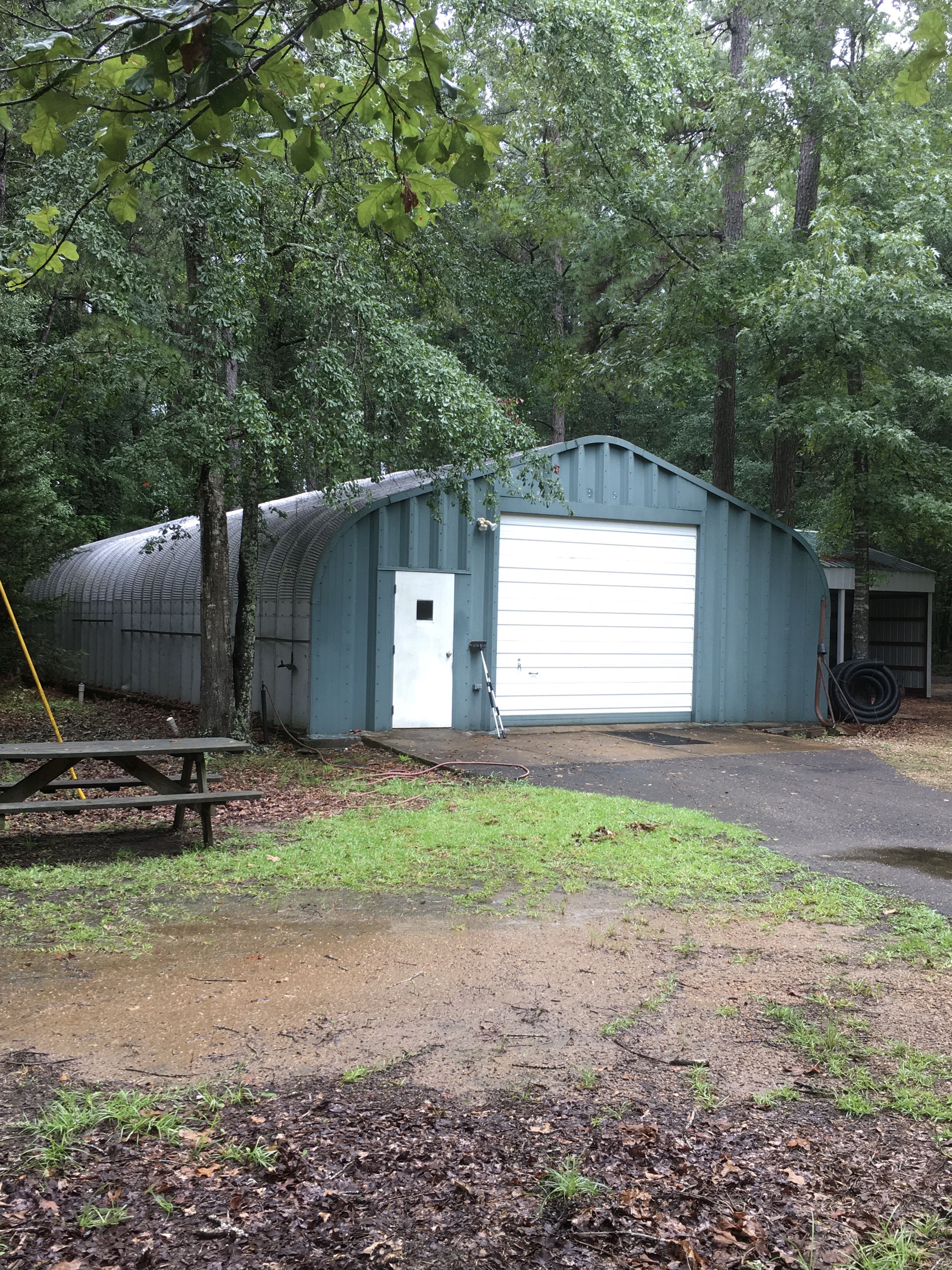

Building: I would like to have a multi-purpose, small building built. I'm thinking a steel building would be most cost effective. Probably 18x30 would work. I want to put a pool table and game room together but also have a kitchenette, bathroom and bedroom. I might go a little bigger on the building. I have power on the land and I believe that part should be pretty simple. I don't know what I don't know honestly and I'm not sure where to start. I will need septic, water and power. What is the best starting point to get this project priced out? I have a building estimate from an acquaintance. He'll build the building and put the concrete pad in for $24 - $27 per square foot. No roughed in electric or plumbing however. Where would you go to get the full package priced? Are there any things you wish you had done differently or things you strongly recommend people consider before building?
Road: I currently have rough road on the property. It's pretty good but rough. I just want to smooth it out some as it hasn't been maintained for nearly 20 years. Is the best way to do this to have gravel/granite or some composite delivered and then spread it with my tractor or should I hire someone to do this since I haven't done it before. Any suggestions for best material? The property is in Leon County, Texas.
I am enjoying the education I'm getting with my new land and tractor. I just want to prioritize my projects...outsource the ones that are beyond the scope of what I should be doing. Any insight is appreciated. Thanks!

You did say steel building and not metal. The reason I mention that is that many steel buildings are the Quonset hut or arch-type steel buildings while metal buildings are generally squared but with gable or sloping roofs and smooth sides.
If you are thinking about a steel building like you see in magazines, where it is parts that are bolted together, you may want to keep looking.
My mistakes with this on my 30x60 was:
Separate interior walls need building to mount anything on the walls as they are not straight.
Interior ceiling would be needed for heat/AC installation.
7400 bolts and caulk were needed to build it (lots of fun)
— leaks a lot over 20 years and even more fun to fix.
Side wall height not a full 8’ so more framing was needed.
No easy way to insulate.
Electrical is all surface mount.
Nope, I learned my lesson. It may be hurricane-proof but way too many other limitations just to save a few bucks.
