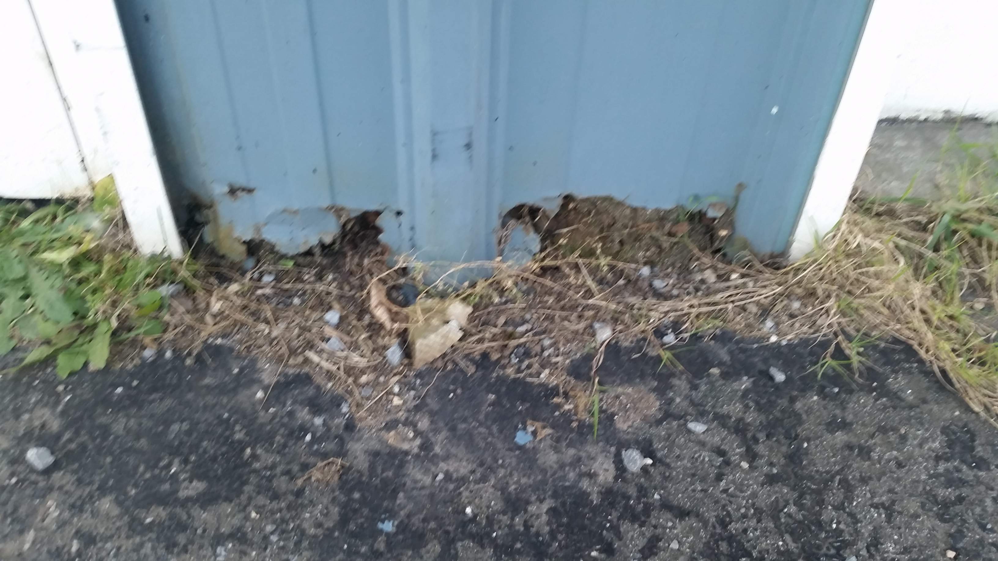

Has anyone had any experience with this?
Is it repairable? or does the whole piece need to be replaced?

Have you had any salt blocks or mineral blocks in there? Mine did that when I had horses many years ago and had a mineral block for them to lick on. Happened quick too.

I believe the previous owner use to salt the around the entrance to that building

All building material, wood or metal, should be 6" above the grade. A few solutions would be to install a PT "skirt board" around the perimeter (a 2X10 or 12). This would allow you to cut the siding up (above grade) about 6-8" and install a horizontal trim (J channel or rat guard) and this new 2X would be your new fastening point for the siding & trim as well as a closure between the building & the ground.
Another solution would be to do the same thing at the bottom, but cut the siding up at the next wall girt and using a different accent color to replace the lower damaged piececreating a "wainscott" look and dressing things up a little. This also makes for easy future repairs at this area that is veunerable to damage.

Good ideas Rusty... yeah looks like salt corrosion.

Was something behind the panel piled up against it? It looks like stuff is falling out of the building...

You can easily cut it off with a cutting disk on a 4 1/2 inch grinder and then slide a longer piece under it that is about a foot longer. Shouldn't take very long or cost very much

It's actually the insulation coming out of the bottom. Thanks for the advice fellas I am going to give it a try

Make sure to paint the cut edge where the bare steel is exposed ... ;)
