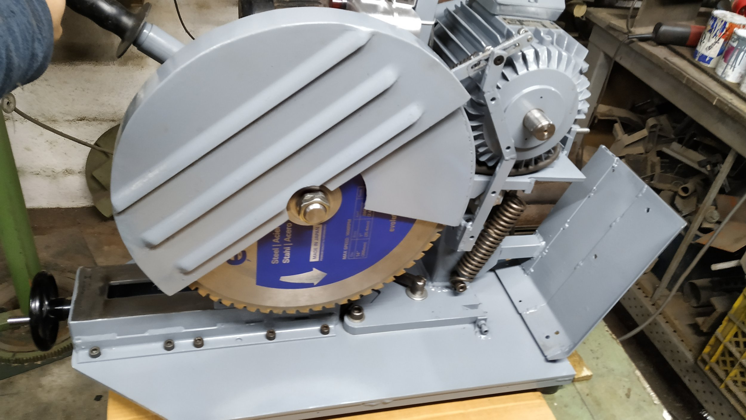

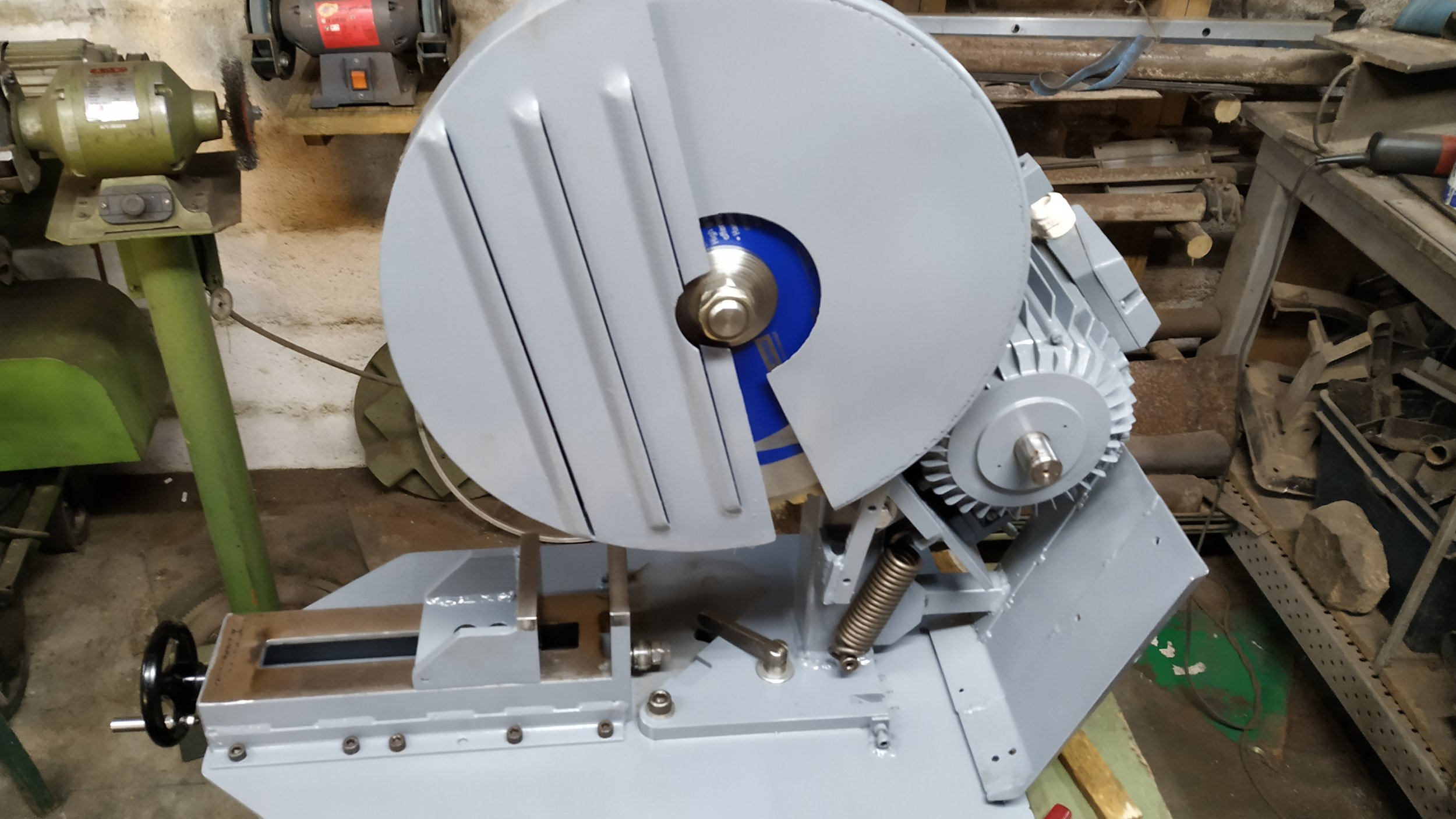

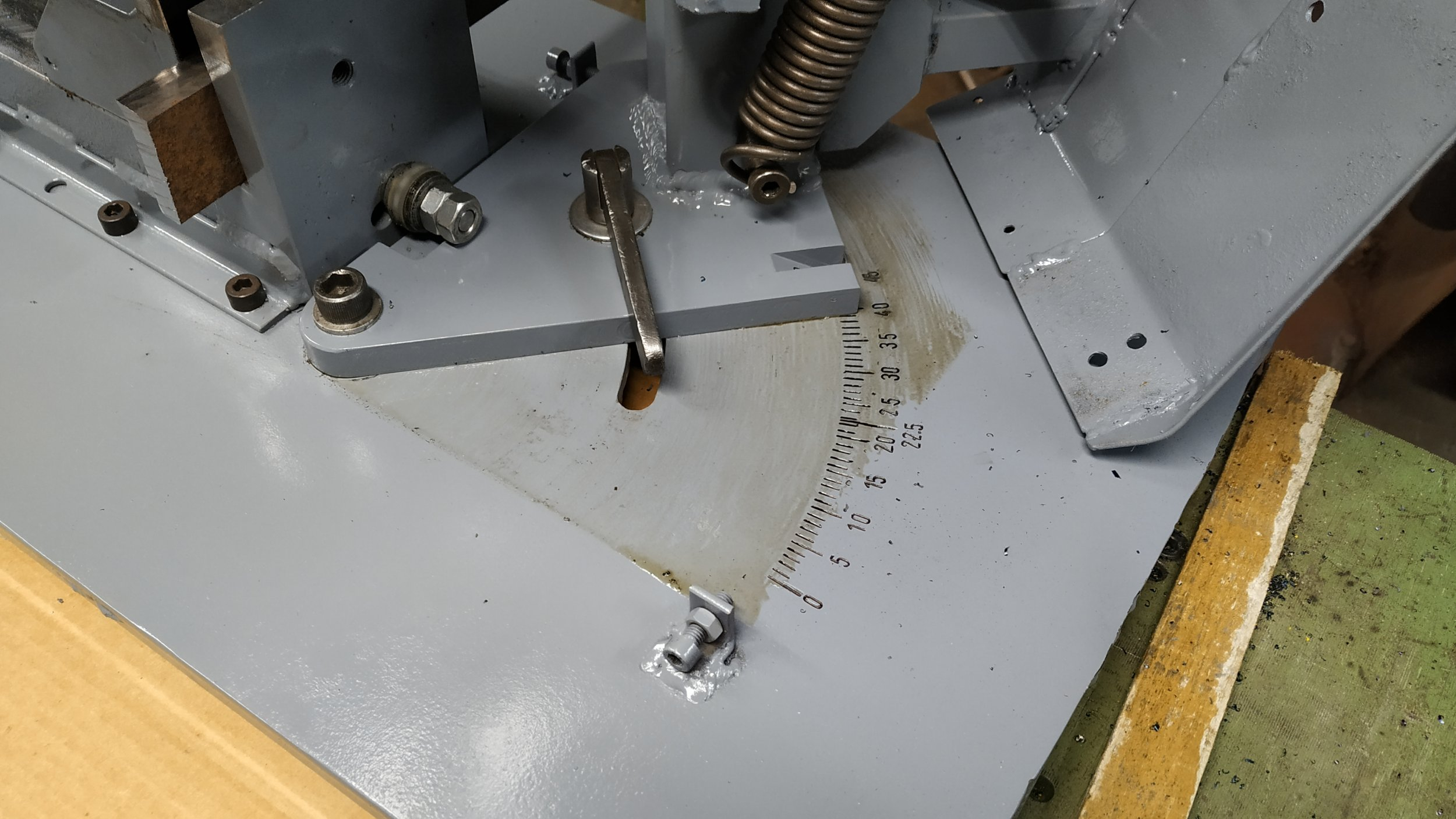

I built one from scratch using an Evolution 14" saw blade, including the vise. Cuts very nicely or used to until I pulled a dumb move and ruined the blade. On mine, I made it so the entire head rotates from 0 to 45 degree by simply loosening a lever, rotate the head and tight it back on. It has a 1.5 HP 3 phase electric motor.
It's a bit noisy and throws stuff everywhere but cuts indeed very well. If I were to build another one, I would have used a band saw blade instead of a circular saw blade.

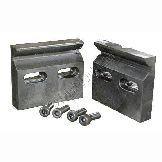

Bought a Fein Slugger saw 2-3 years ago to cut a lot of tubing. Faster, more accurate, burr free cuts. Need to take off an extra 1/16? No problem. Try that with a bandsaw. Cut a lot of cold rolled plate and bar stock. Long blade life. First blade dulled after cutting some 6” SS round tubing. Can be sharpened but haven’t done that yet.
Long blade life contributed to by adding MK Morse vise jaws from the start and watching their video on how to use a cold cut saw. Vibration and too much pressure kills blades. They fit many saws with no modifications.
Just checked prices…saws and jaws almost doubled!?! ZORO tools had the best price at the time.

If you anticipating TRIMMING short pieces, pay attention to the vise. The kind with a swiveling moving jaw won't safely clamp on a piece not long enough to extend to the left of its pivot. One work-around is to add a block to the left side of the pivot, the same thickness as your workpiece. But a vise like ptsg's in post #11 is handier.

Making miter and cutting small parts often have to move or adjust the jaws. Easy enough to do with two cap screws.
