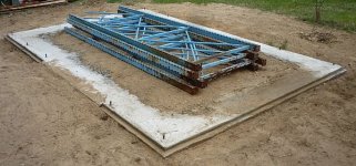

For a shed, there are other options to economize. I scrounged the framing and siding for this, just had to buy the roofing, flashing, and fasteners. This was built under the old 120 rules:
Pallet racking, steel studs, a beam with trolley and hoist, and siding all from CL. Even at that short 4' span, I was outside the rated loading of the studs, so switched to wood 2x4's for the upper roof. If you do the gambrel part right, you get a storage shelf in the roof overhang.
