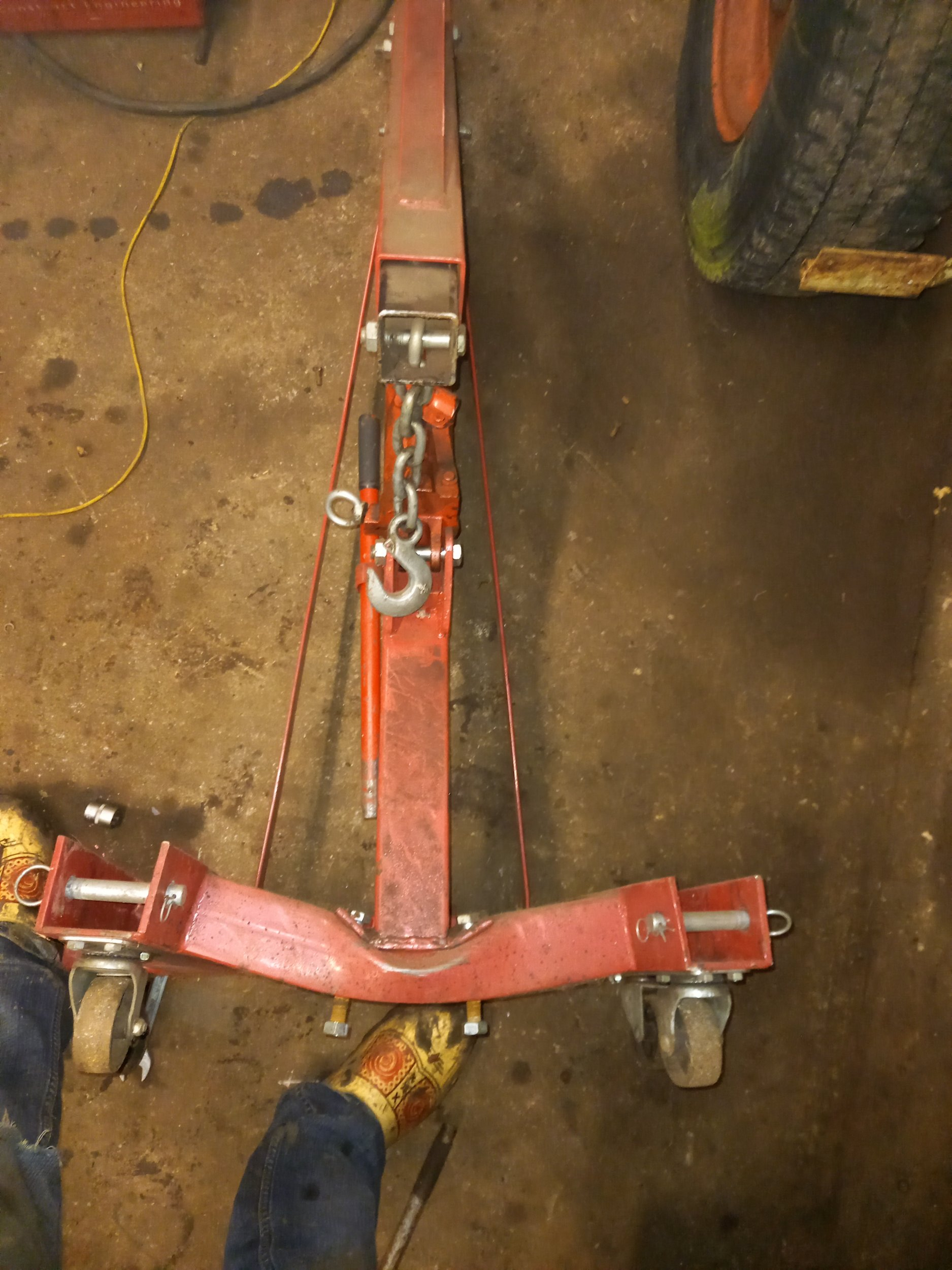

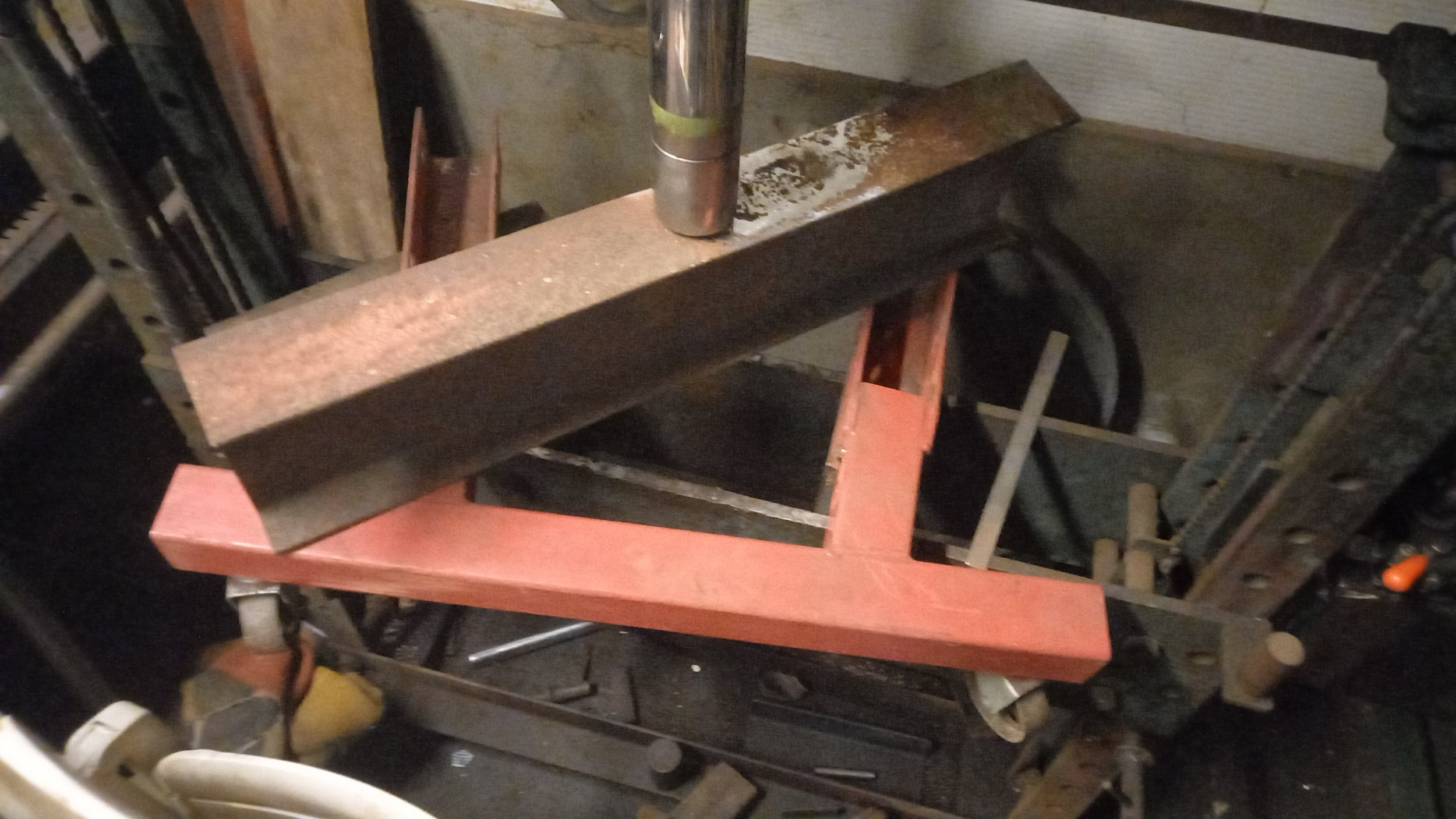

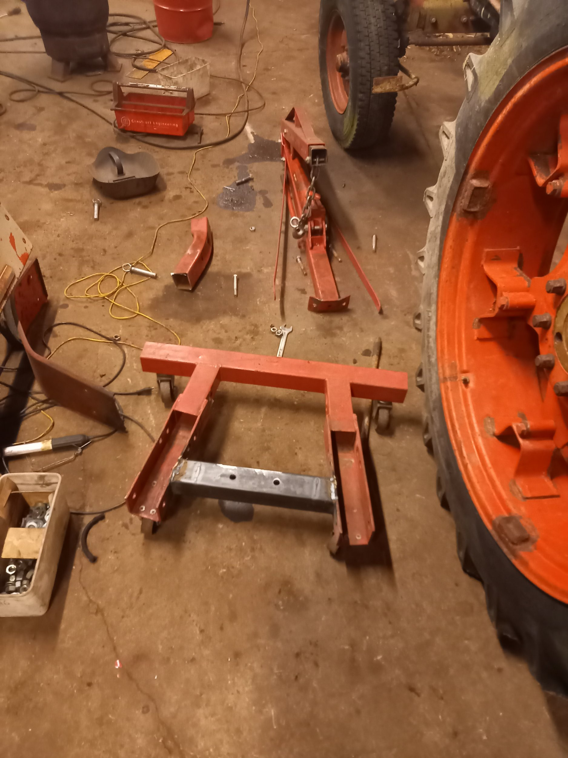

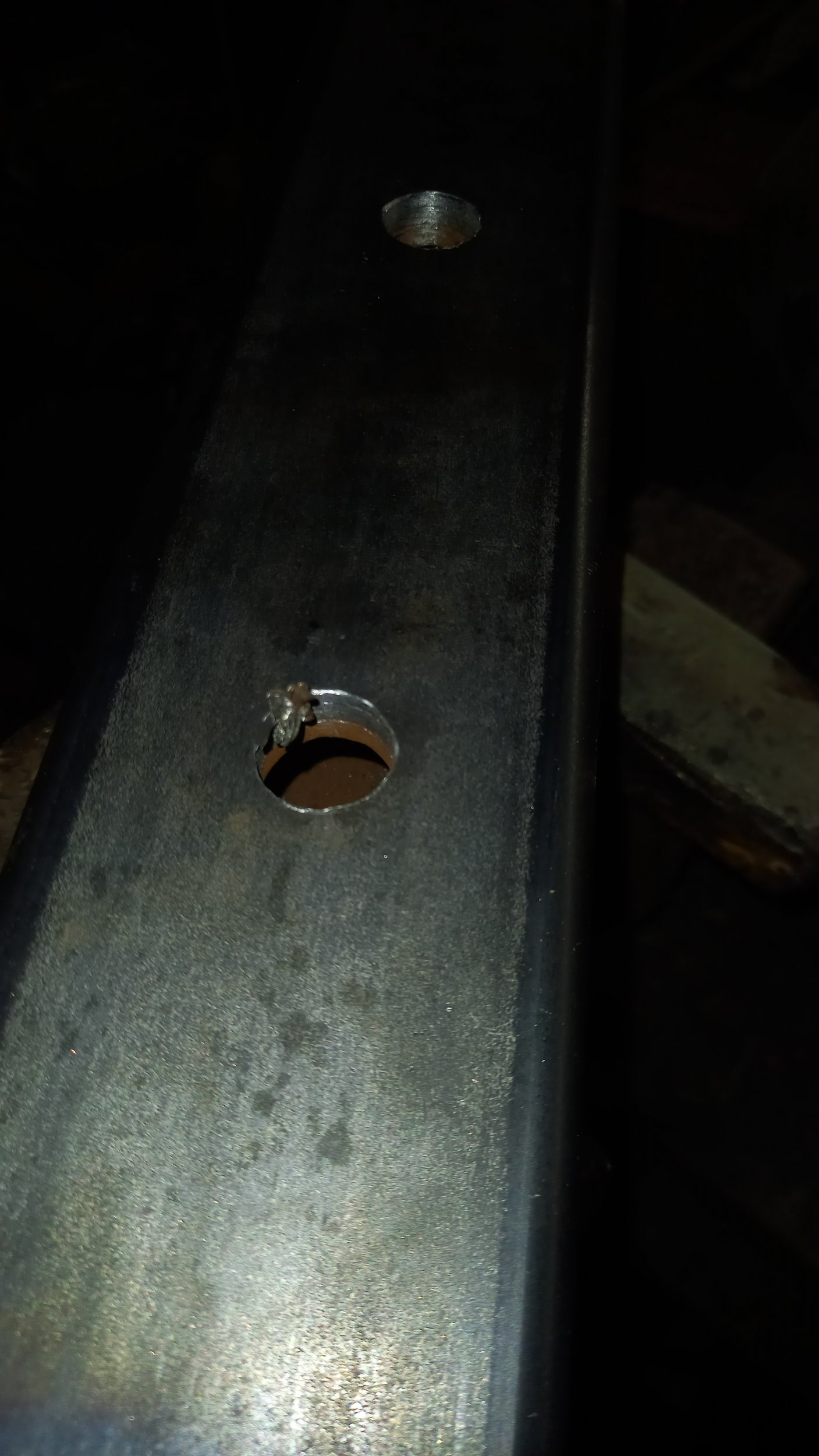

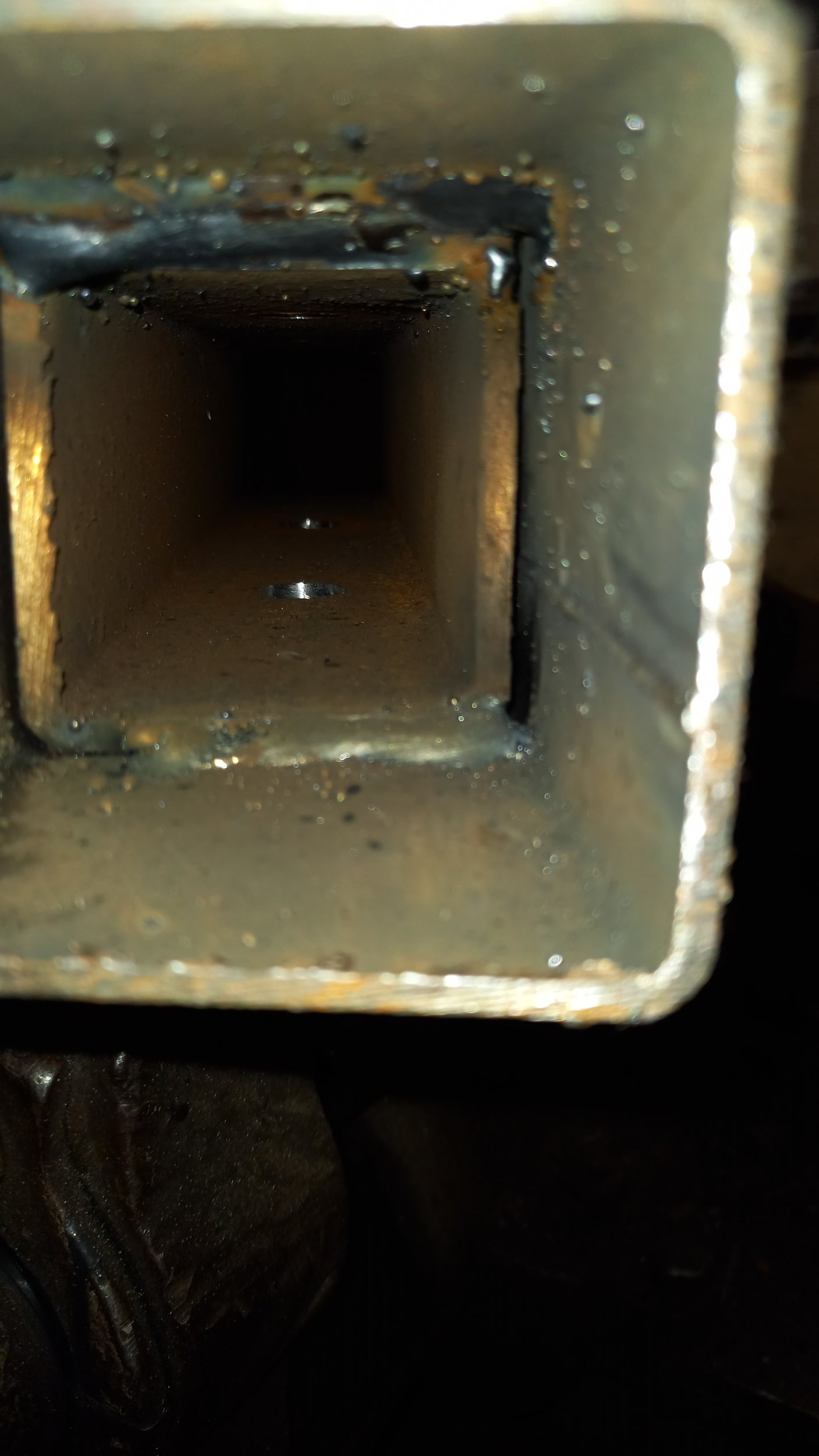

I was repairing my Chinese engine hoist yesterday, and made it conifer hedge proof (i bent it lifting the conifer hedge in my BILs backyard, as it has more lifting capacity than a mini excavator able to get through a 3 foot fencewall gate: Despite the damage, i got all 4" conifer stumps out
I bought it 15 years ago for 115 euro. The replacement tube 70x70x3mm (2 3/4" by 1/8") cost me 17.48 euro per meter, ex 21% VAT making it 21.15 per meter. Which means the steel is worth more than i bought the entire hoist for.
I stuffed it with 60x60 (2.5") tubing with a 1/8 sheet to beef it up a bit and pushed it square on the shop press.
