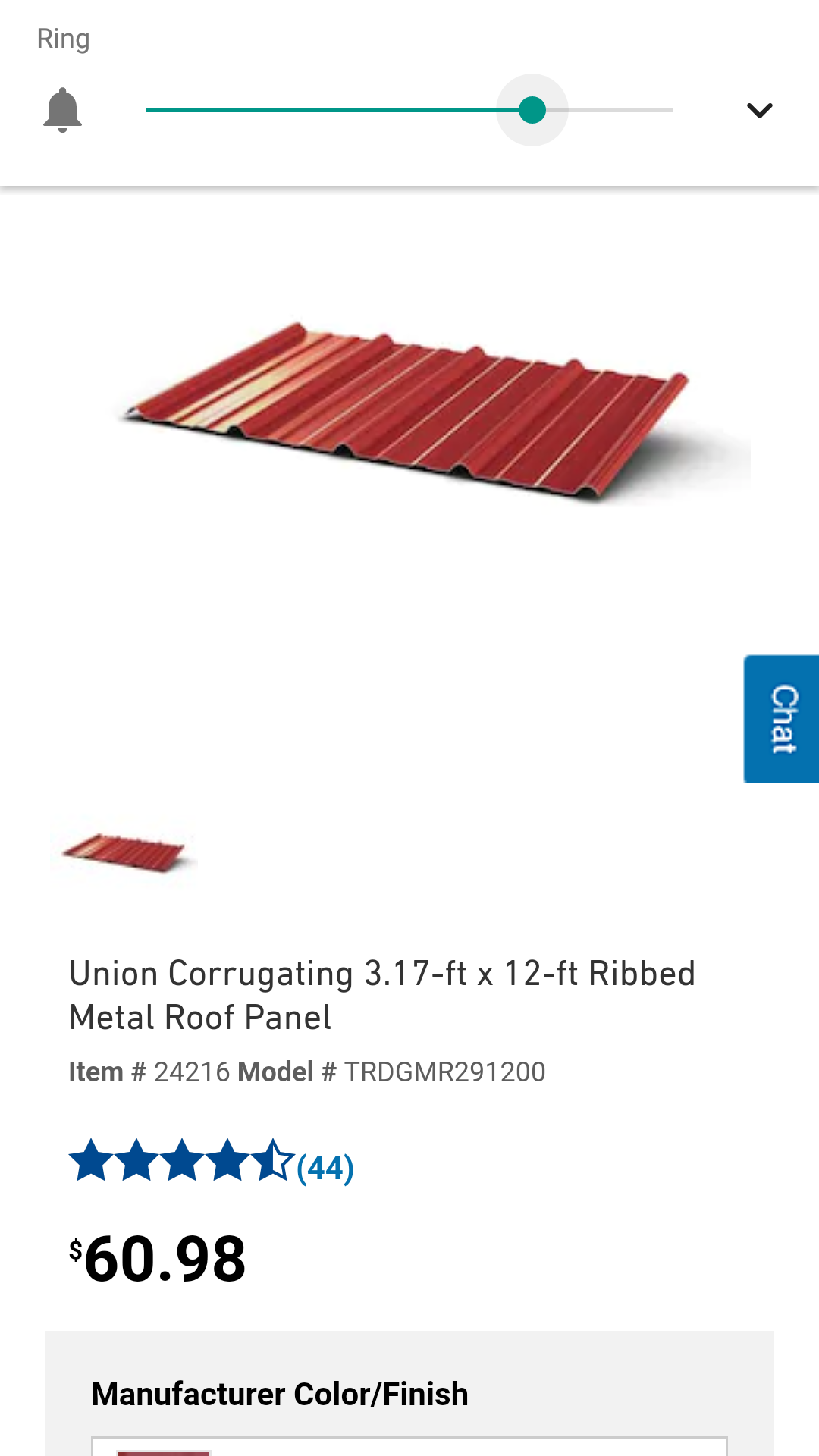

You must have a mistake in your first post. Online, Lowes shows the 12 ft panels from $25 for the galvanized, $30 for the painted. You listed $60.98..... that is way high... I think a mistake in price...
Here is what I'm seeing on my end-maybe it varies regionally?
