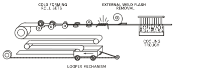

Pipe and tubing are formed by taking strips of steel from a coil and progressively rounding up the edges until a tube is formed. Then a welding process welds the edges of the strip together. Depending on several factors, speed of the mill welding equipment, skill of operators, etc, this seam protrudes to varying degrees inside the tube. Incidentally, square tubing starts out the same way, then after the welding process, the sides of the round are progressively rolled in to form a square or rectangle. Keep in mind that the tube mill process runs a continuous strip of coil that is cut to length after it is welded and all this happens at around 300' per minute.

Here's a quick pic of the tube forming process up to welding.
