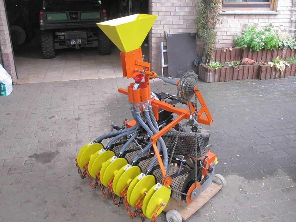

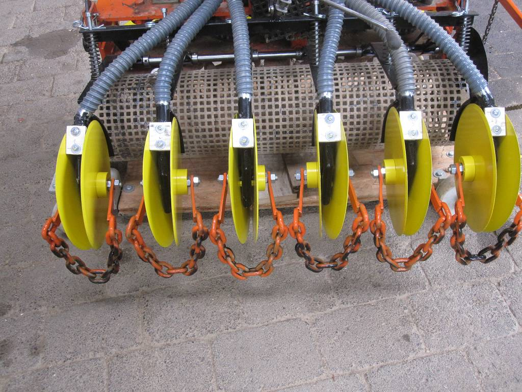

Self-built seed drill modification.
Since I also grow corn and sunflowers, rhizomes are still left after the harvest. These remain hanging in front of the Seed ploughshare. That's why I've built disc coulters now. These are hung individually and roll over obstacles. The coulter pressure is preset via a spindle and transmitted to the disk coulters by individual springs. Covering the seeds with soil take over the drag chains.
