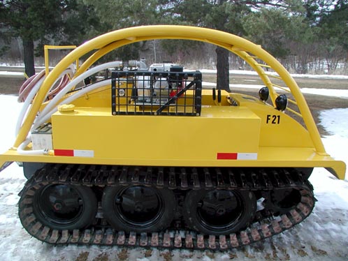

I know you said no oldies but a Bombardier "Bombi" J series sounds perfect
