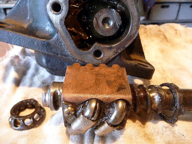

Here's a picture of the sector shaft available from Hoye
Shawn, thanks. That has the the 'ears' I expected to find.
Digging around in Hoye's site I see that I have the 'old style' steering box. It is the one where the steering column screws into the steering box, instead of bolting on. Their picture of the Sector Shaft for this box shows that it also has the milled groove, 'ears', that I am missing.
Soundguy, no way am I a good enough welder/machinist to build back the tabs missing off the left end of this sector shaft. :(
/ Steering broke YM186D #22
SG, it seems like it would take a milling machine to cut that groove after adding material. That's over my head! At least the threads in the sector cover are good.
check to see if the lower bearing surface is a replaceable race.. inspect the worm gear for nicks.. the BB's are replaceable.
as for neeidng a milling machine? ? that's the hard way.. hand cut some steel and form it up correctly, THEN weld it on and dress with a file. it just has a lil push / pull pressure.. not much alse. a good full penetration weld should hold fine.

Wrapup - to make a long story short - everything inside the steering box was thrashed. Somebody had been in there before and did sloppy work: several of the smaller balls that recirculate inside the 'nut' were loose in the bottom of the box. Then I found a big fragment from a previous 'nut'.
I should have just bought a rebuilt box from Hoye at that point but I ordered parts and put it back together. Mistake! It was so sloppy that the steering wheel still had a half turn of dead slack like it did when I bought the tractor, and like before, the adjustment screw disappeared into the box without reducing this slack.
I gave up and ordered a rebuilt steering box from Hoye. The tractor is now back together.
