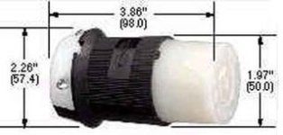

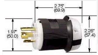

   / Steering gear sloppy on Mit MT372
#12
No, its not a twist lock. It is a 2 prong plug in type. The plug is actually curved kinda like a C. I found a replacement at Jeg's but I am not going to pay their $11.95 handling fee on a $12 order.
