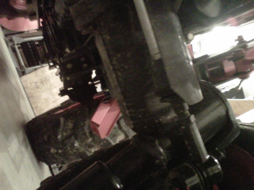

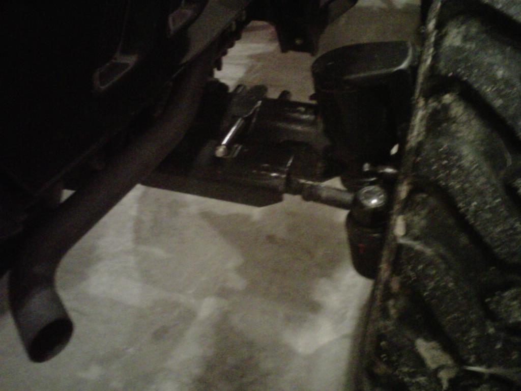

/ Steering linkage ~ missing boot? #11
CM,
See if these pics help you....just took them on my DK40SE HST. This is of the left/driver's side.....(the 3rd pic is looking from the bottom up....sorry, it wasn't at the best angle).:laughing:
As you can see, mine is bare except for the protective shield on the top side.:thumbsup:
